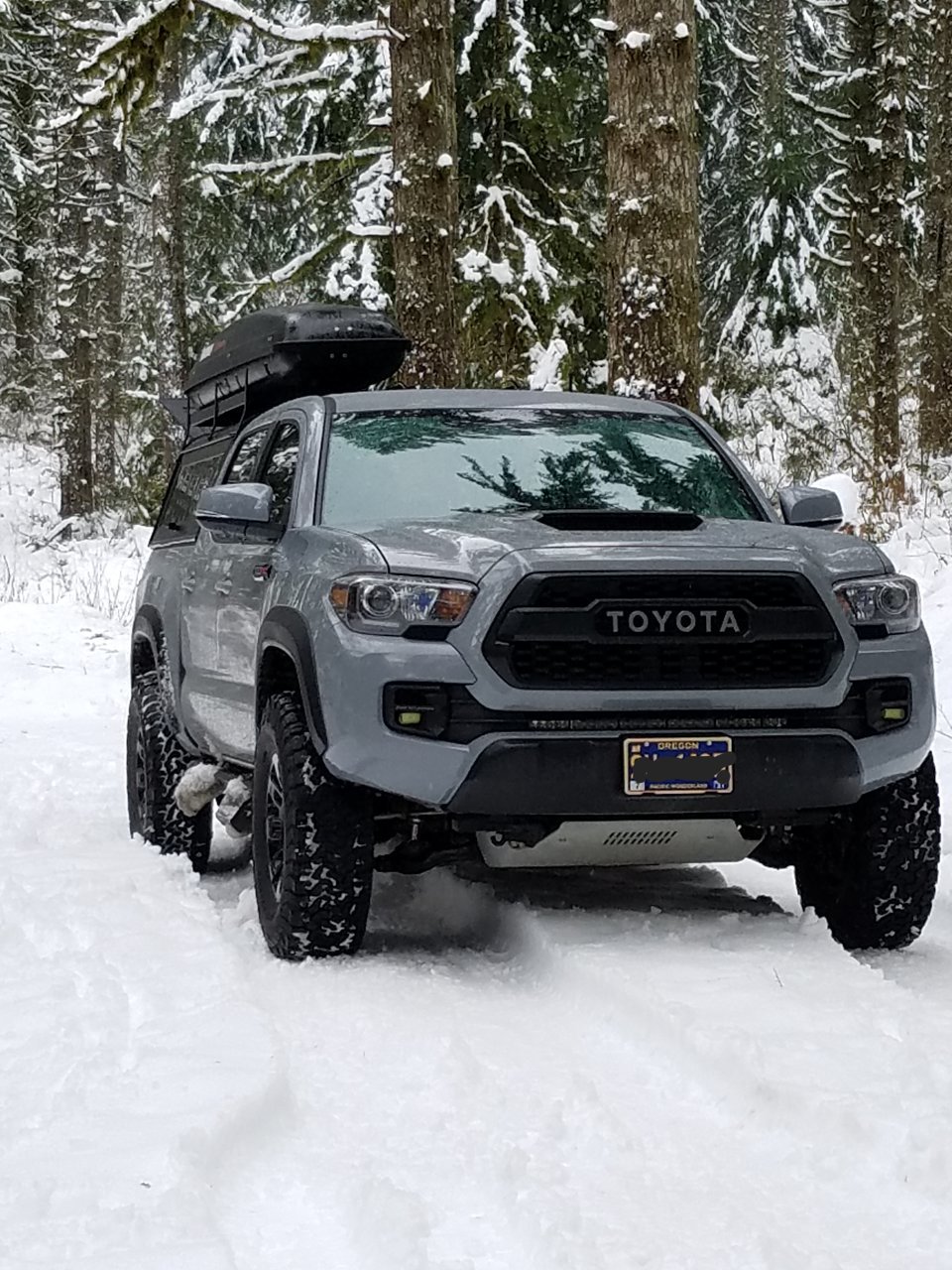

    I just went from 265/70/16 to 265/75/16 with no lift and no rubbing. They are considerably bigger than the 70's. From what I’ve read, that’s about as big as one can go with no lift. With a lift they would probably be a nice tire and you should be able to go bigger. I’m getting about an inch of extra ground clearance with the 75's.

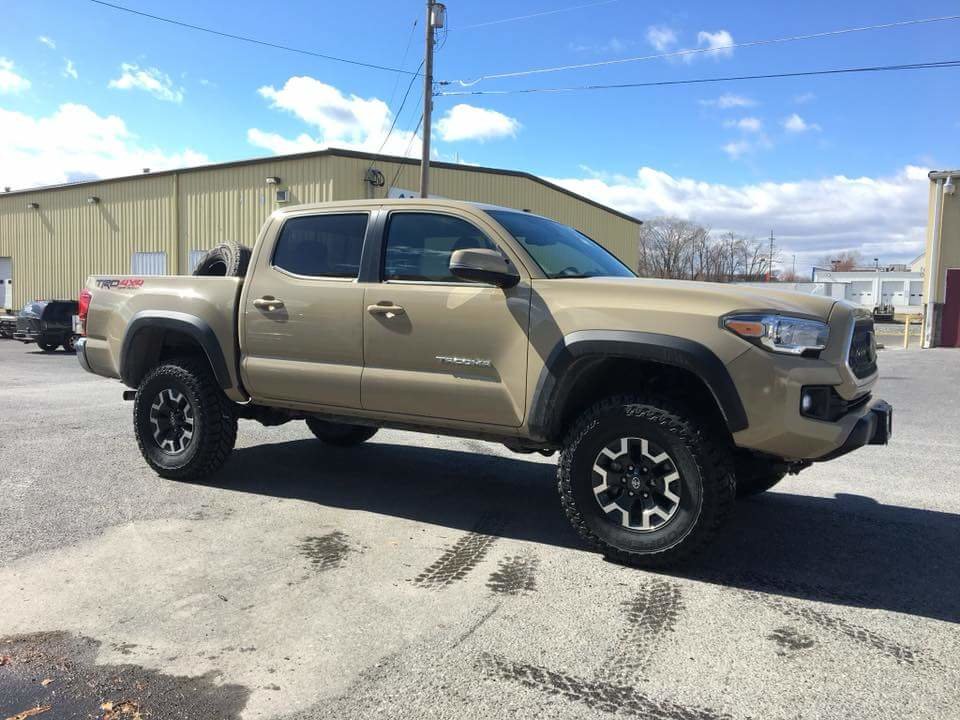

    I see that Spidertraxs seem to be very popular...Are they a much higher quality over others? Seems like they are around $100 for a pair.
    I found these on ebay, and they are only $100 for all 4....are these of a lesser quality than the spidertraxs?

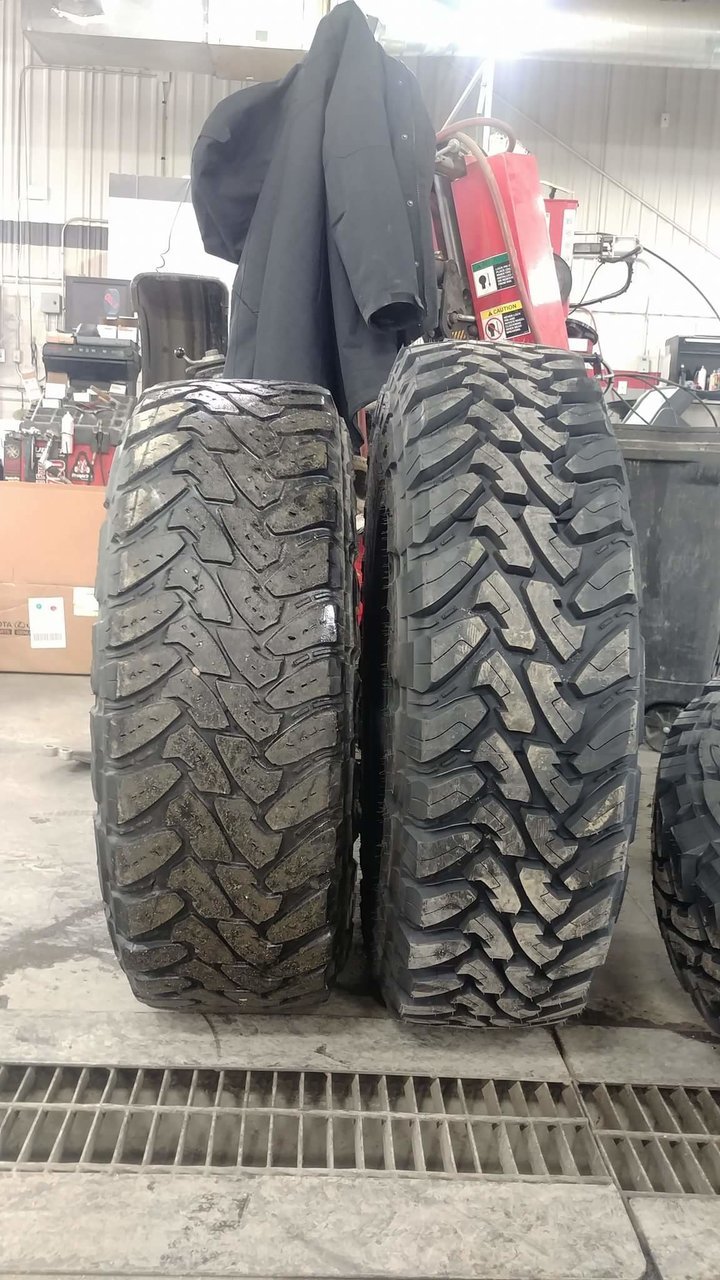

    Got a friend on fb group who just put 255/85/16 on his stock truck. Hes done some testing and no rubbing as of yet! He said he has 1.5" more ground clearance. Also, here is a comparison between his previous 265/75/16 and the 255/85/16

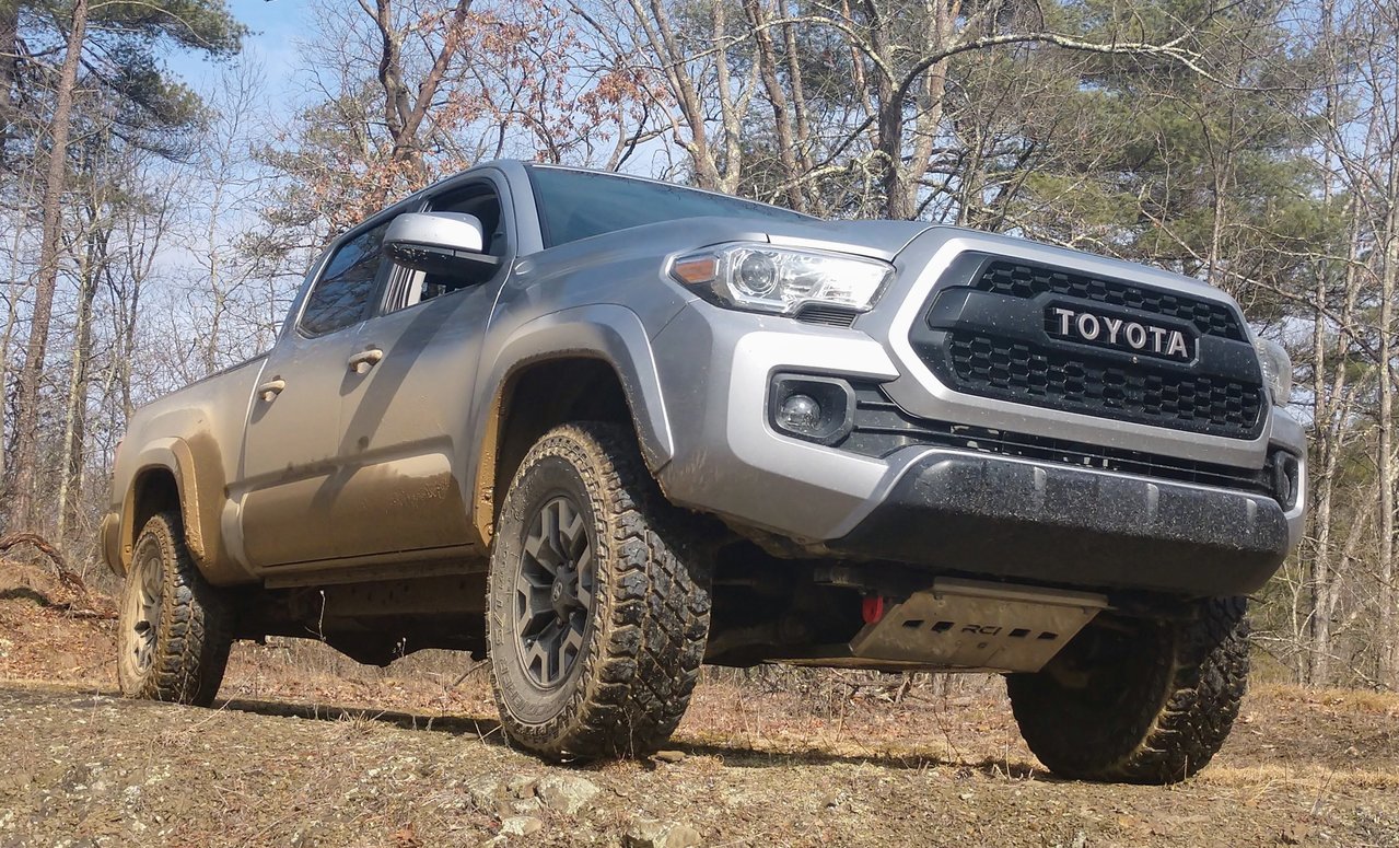

    255 85 16 st maxx

    He must be driving on some very level ground. Those will rub no doubt.

    I
    Its actually very common.
    Have you ever put these on a truck?
    I have on 2 trucks, and havent had any rub at full lock.
    Its all aboutthe alignment
