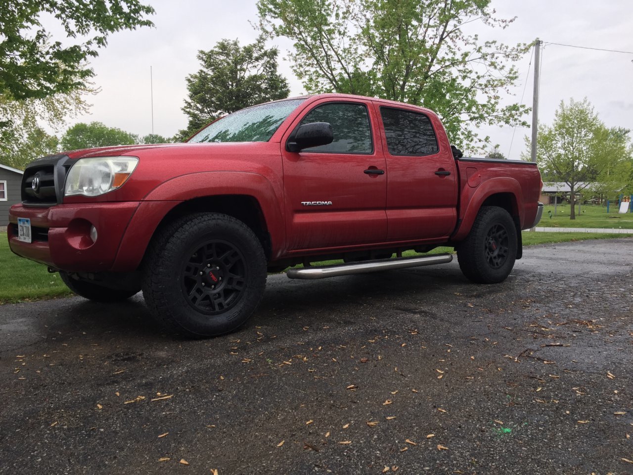

    I was just in the same boat as you two weeks ago. I ended up pulling the trigger on 17” wheels with 265/70r17 tires.
    Extreme happiness has been had ever sense.

    Damn that makes me feel better. Wow that looks nice! I wouldn't expect any rubbing but do you have any? So those wheels are a 17x7, Does that affect the width of the tire at all? From what I understand is that they kind of bubble out on the sidewalls which I kind of like for protecting my rims.

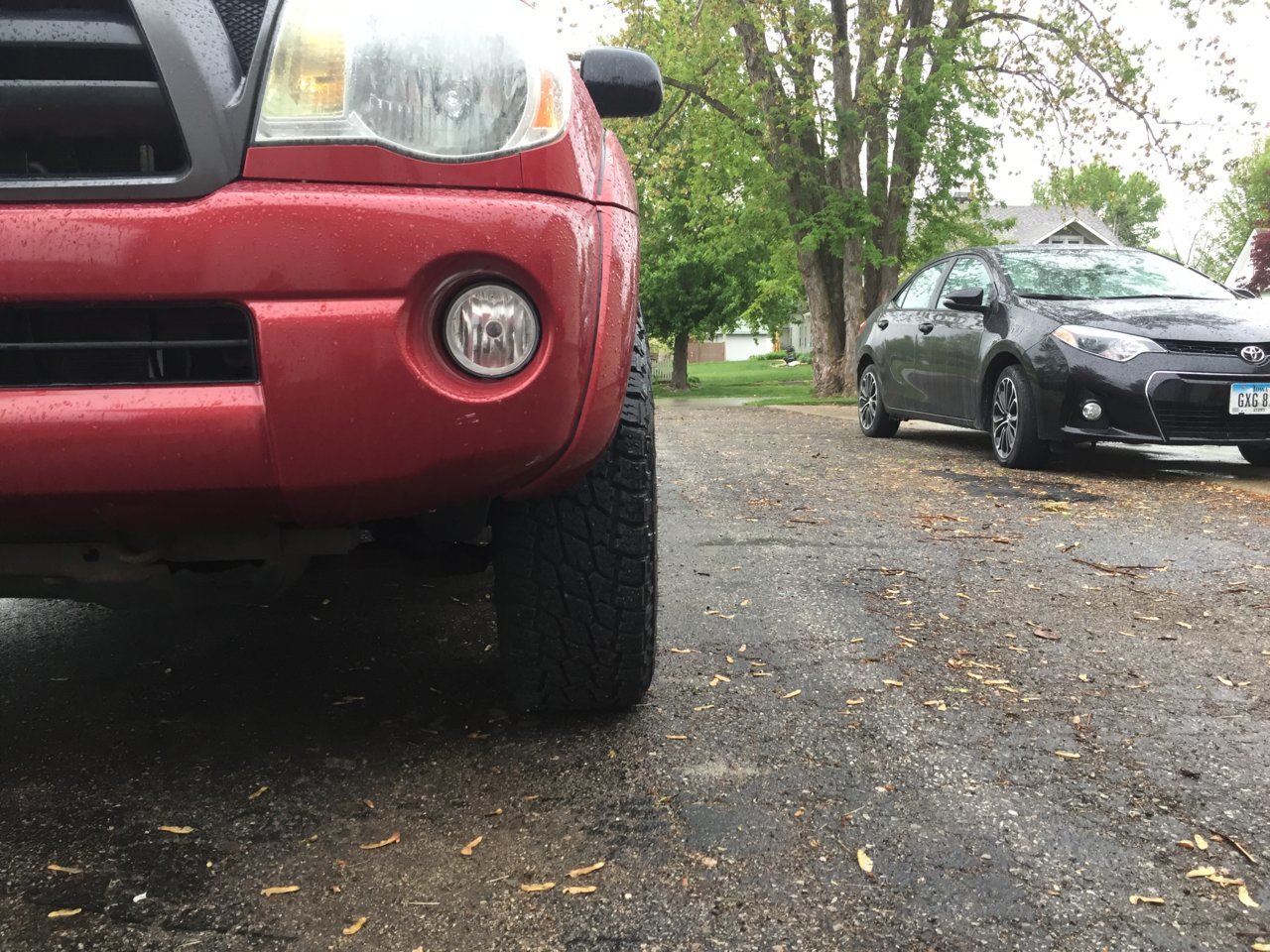

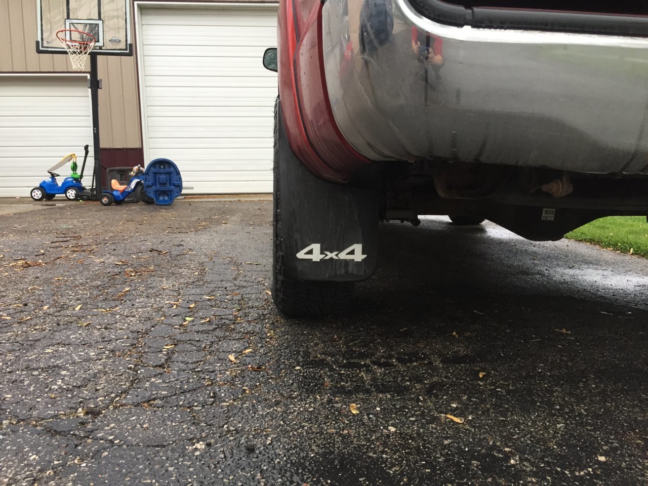

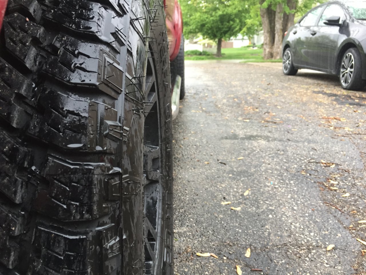

    I’ll go snap a profile pic of them for you. I got these from the dealership and they said they would be fine. There is only slight rubbing occasionally on the bottom corner of the fender, but that is because I need new front shocks, which will be done soon.

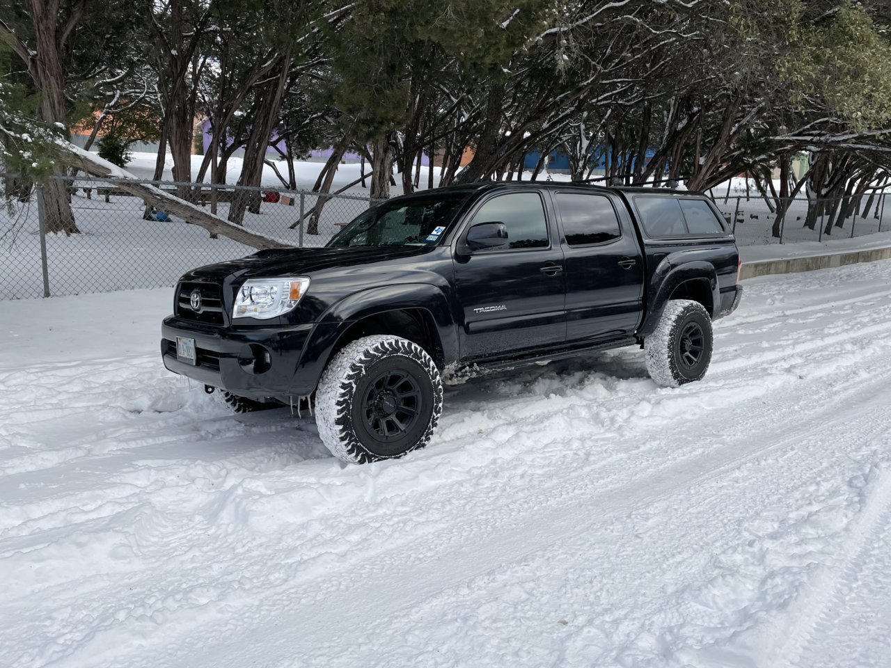

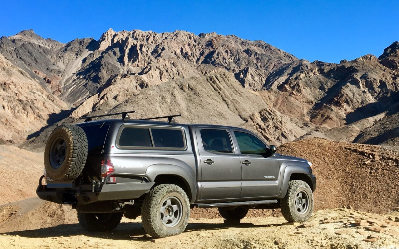

    265/75/16 with 16x8 but 0 offset. If you’re like me you’ll be back at square 1 soon enough, but I’m glad I took this route with incremental changes ...

    That'd be great, how is the poke on yours? I want less than an inch outside the fender flare

    Sick truck! do you have a lift on the truck?

    Hopefully these help.

    Alright, I think you've persuaded me. That looks like exactly what I had in mind! Appreciate it!

    I do - pretty basic. 2” headstrong coils and AAL with bilstein 5100s. I had the truck 15 years and 150k before doing anything. Ride was greatly improved and it looks better. I’d go with your plan, but I also would make sure you try to find a good local alignment shop. If you do rub a good alignment should take care of it.

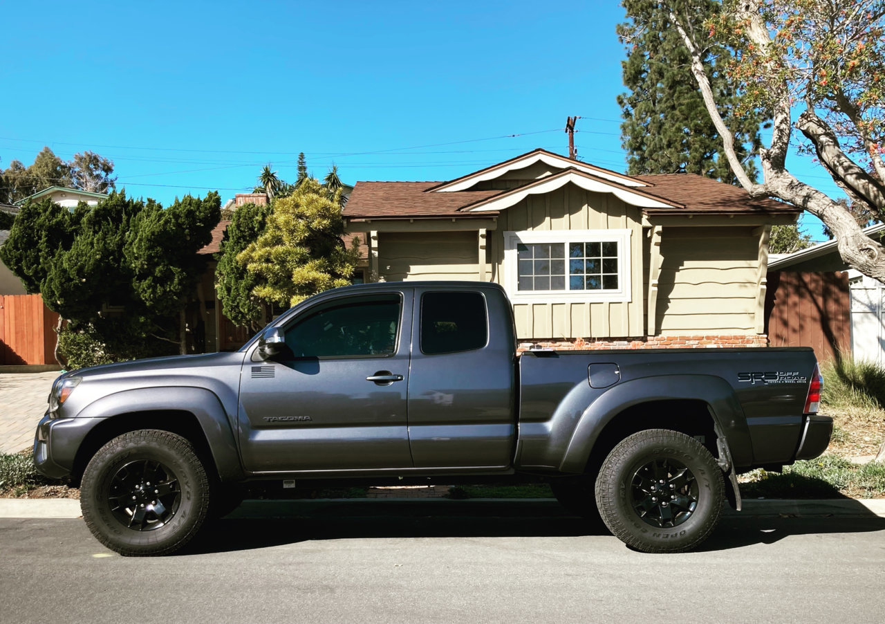

    You mentioned 'small lift' in the future. I run a small lift (1" front, 1.5" rear) with 265/75/16's on an AC. I don't know my wheels backspacing/offset numbers but you can look them up if you want. They are the Toyota OEM "Baja" wheels. I also run a BORA 3/4" spacer and they poke out of the fender no more than 1/2"... if that. Pretty even with the fender i'd say.

    Thanks for the info, beautiful truck!

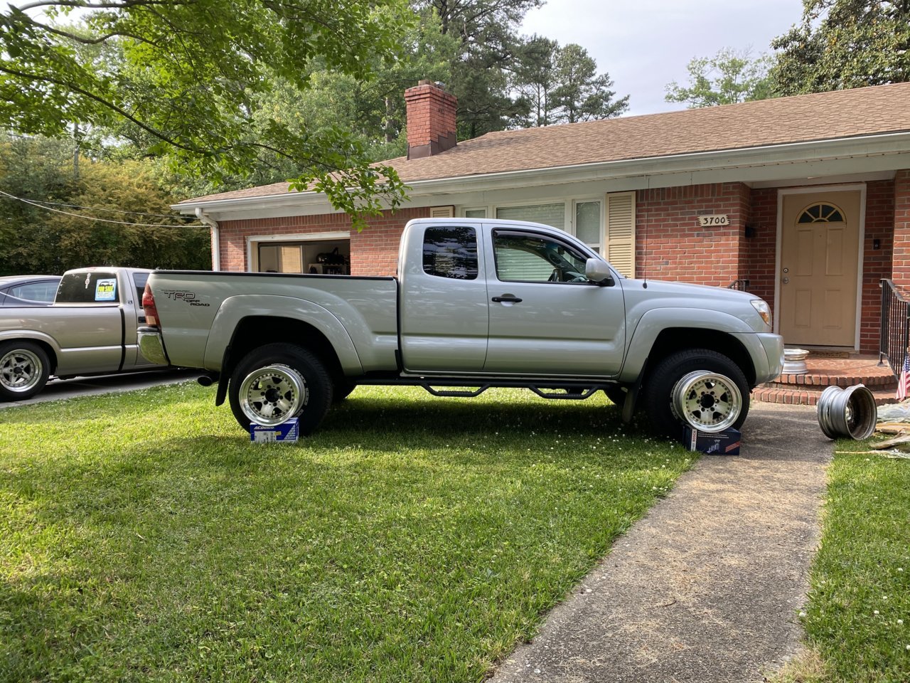

    thanks a lot for this. I just ordered some 16x8 deerfields and planned on running 265/75s with a 2" lift

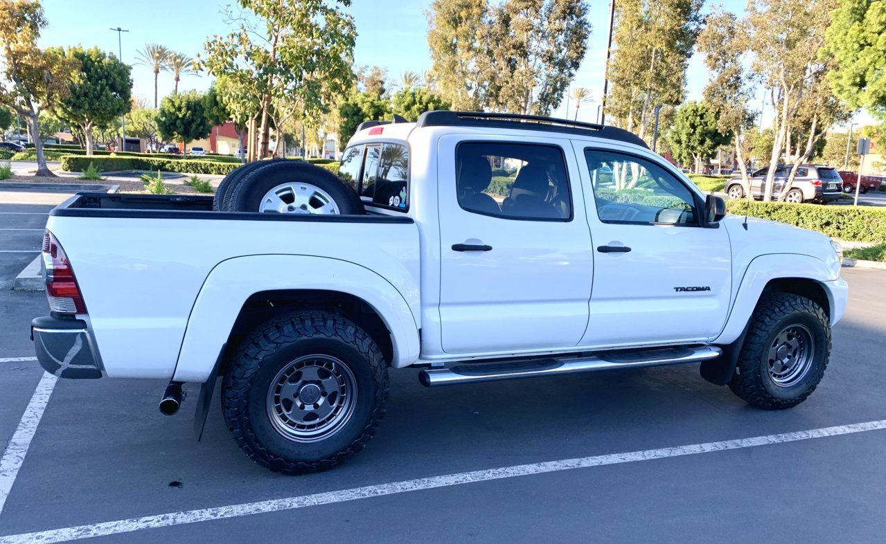

    I'm on 265/75/16's. Wheels are 16x8, 0 offset, and 4.5" backspacing.

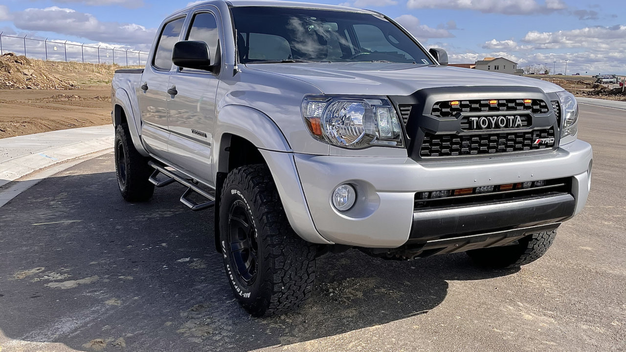

    265/75/r16 tako2’s
    Stock rear suspension with TSB
    5100 at 1.75” stock coils
    Am lookin into 285/70/r16 soon. Tires are getting close. And rear shocks/leafs are squeaking. So prolly major upgrade within the year. But current ones fit no problem. Could probably fit 285s pretty easy. Might have a small rub when steering is cranked

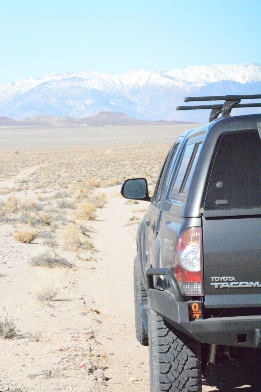

    265/75/16 with maybe 2" of lift (I haven't measured since installing the armor and winch several years ago).
    Wheels are 16x8.5 with 4.5" backspace 0 offset.
