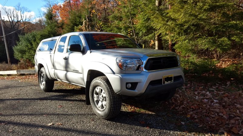

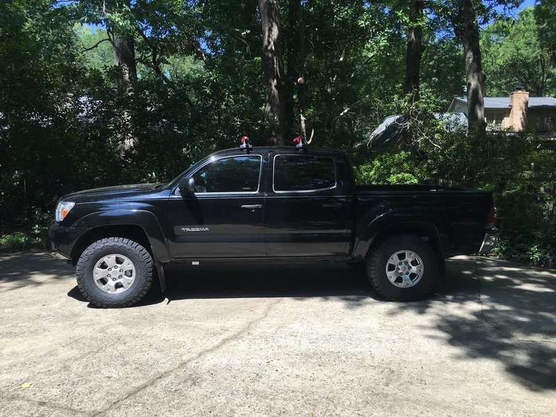

    Installed Cooper Discoverer ATW 265/75r16 and don't have any rub. The mileage is about the same as well. No noticeable power loss and hopefully these things will be bomber for winter road trips.1029219426641027373-account_id=1.jpg

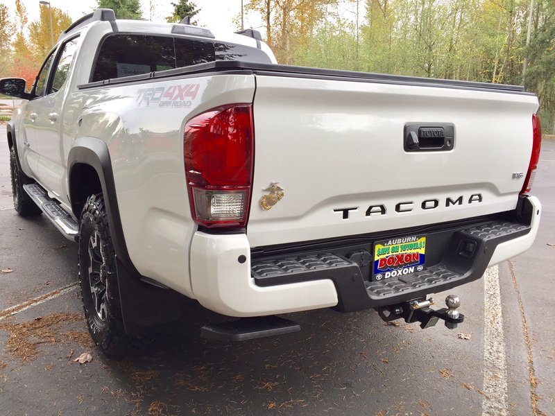

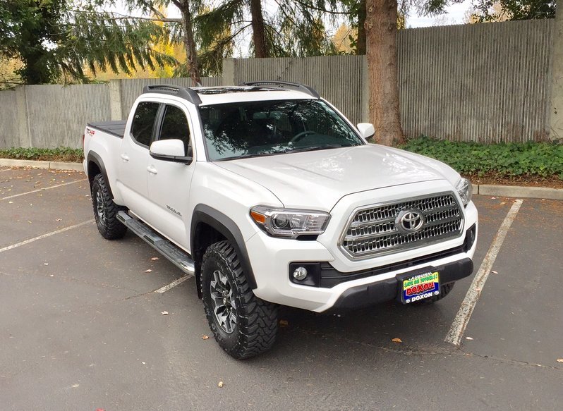

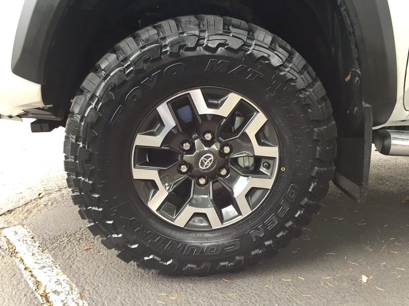

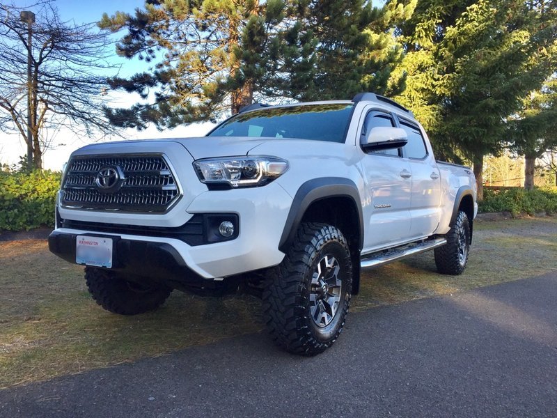

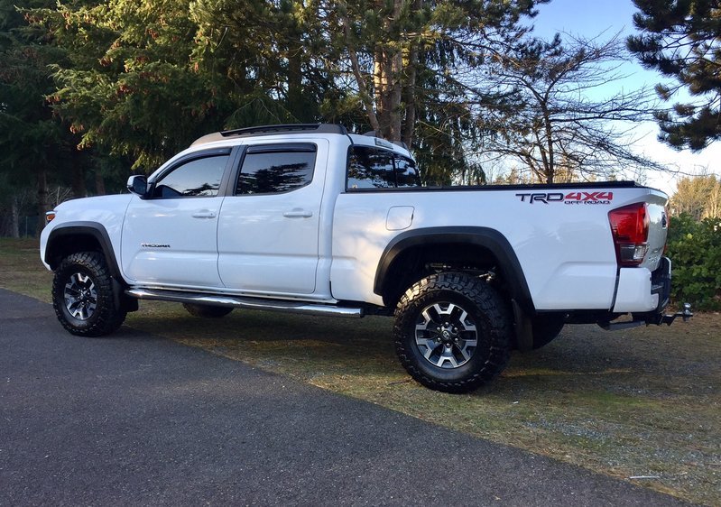

    Here's my 2017 TRD Off Road...totally stock suspension, with Toyo MT's 265/75/R16. If you notice in the photos, no cutting needed, mud flaps did not have to come off and no rubbing either.

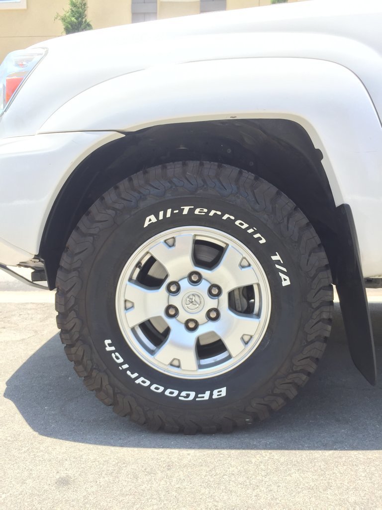

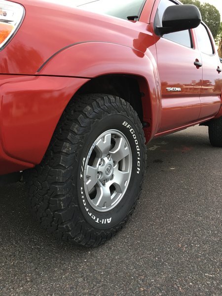

    IMG_0106.jpg These ko2's are stupid good

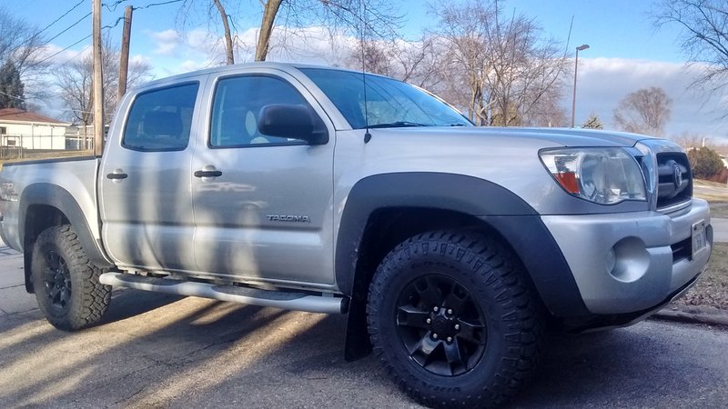

    Hi everyone I just joined the community. I wanted to let you all know that this thread really helped me in my decision making process for what tires to put on my 08 Tacoma SR5. I went with the LT265/75R16 Duratrac, and so far I could not be happier with them. No rubbing whatsoever.

    I have a 2017 DCLB and have 265/75/16 Toyo MT's on mine...no rubbing at all.
