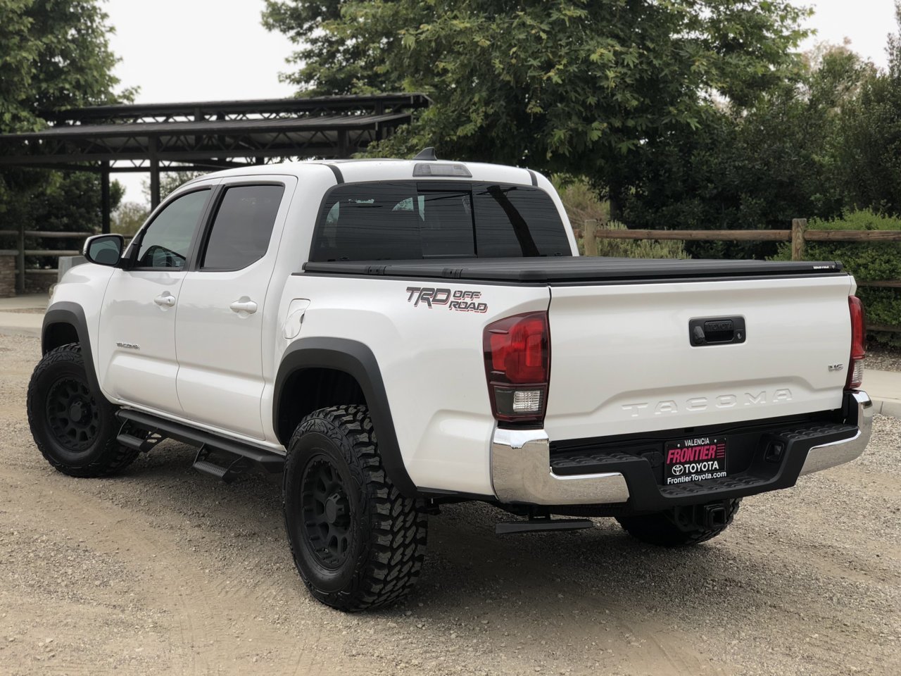

    ICON8 Lift -285s. upTOPoverland rack.
    I started with 265/75/16s and no “rubbing” off-road, until I hammered them. I did a performance lift and bumped up to 285s which I hammer even harder occasionally rubbing on crank turns. So I’d say they don’t rub if your mall crawling but if you mall crawl off-road what’s the point, the more you work to make it impervious to bottoming out, the more you will push it so it does! I now just hammer the crap out of it and let the wheels bang when they need to. That’s what the radio cranking AC/DC is for.
    265/75/16 no lift
    285/70/17 ICON 8 set for performance

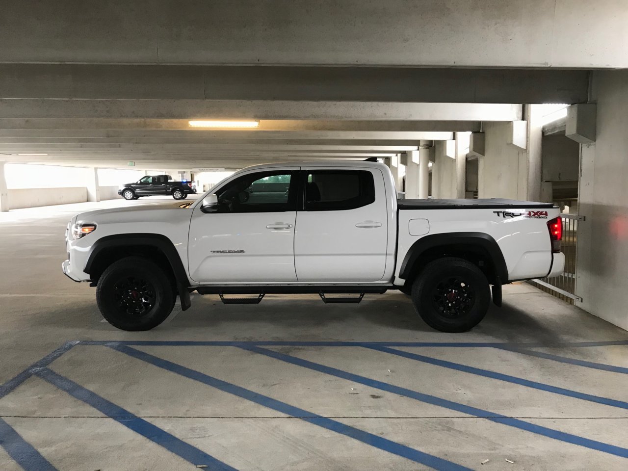

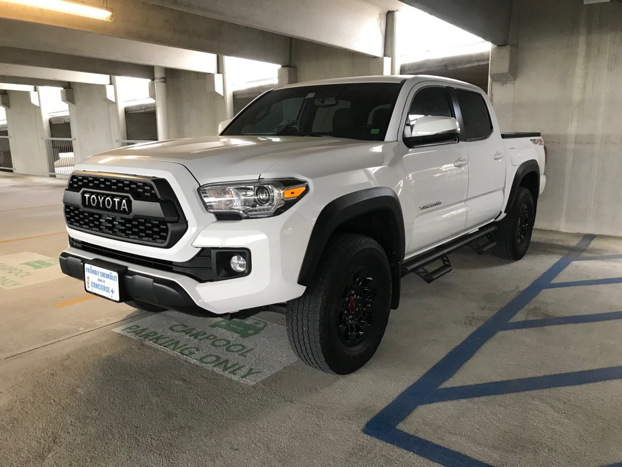

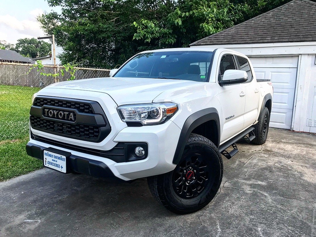

    Great rigs you guys! Thanks for the information! I have chosen to go with the 265/75r16 in either the Toyo Open Country C load, or Duratracs in C too. Trying to save on weight for my work commute. Wish BFG made that size in C because they look so tough!
    Here is my truck as it site right now (Scored some mint Tacoma Pro wheels the other day, wrapped them in the stock Goodyears)...

  12. May 23, 2018 at 6:09 AM
    JKinSoCal
    JKinSoCal Member
    Apr 22, 2018
    #251382
    5
    2018 TRD OFFROAD DC
    I have some very loud 265/75/16 Pro Comp Xtreme MT2s on my stock height 2018 O/R. So I removed the mudguards and noise/hum has dropped significantly. No rubs
