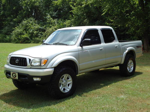

    2003 Double cab 4x4
    Bilstein 5100 set @ 0, OME 881,Wheelers 5-leaf, OME NitroCharger Sport shocks, 4-RUNNER LIMITED WHEELS, Duratracs, 265/75/16
    They will fit.....

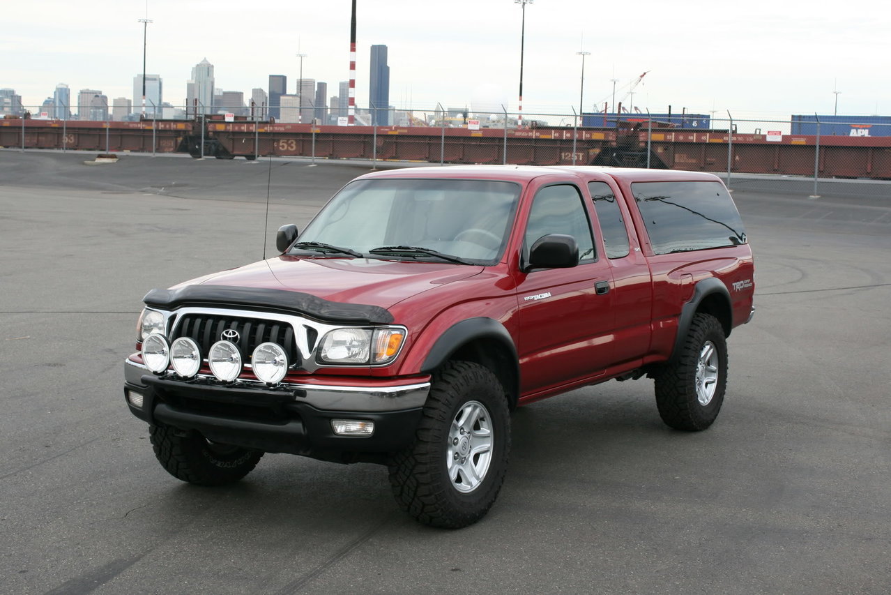

    Beautiful truck. Are the duratracs in this picture 265 75 r16? Or are these a bigger size, after you lifted your rig? I've been thinking about a set of duratracs if I stay at stock height, but I might go 285 70 r16 if I decide On a lift. They look excellent on your truck.

    Thanks man, the truck is completely stock in that picture and yes the tires are 265/75/16. I switched to a 285/75/16 after the lift.

    Same tire?

    Not sure if your question is directed at me, but I went with Hankook Dynapro MT when I switched to 285's. Just wanted to try something different.
