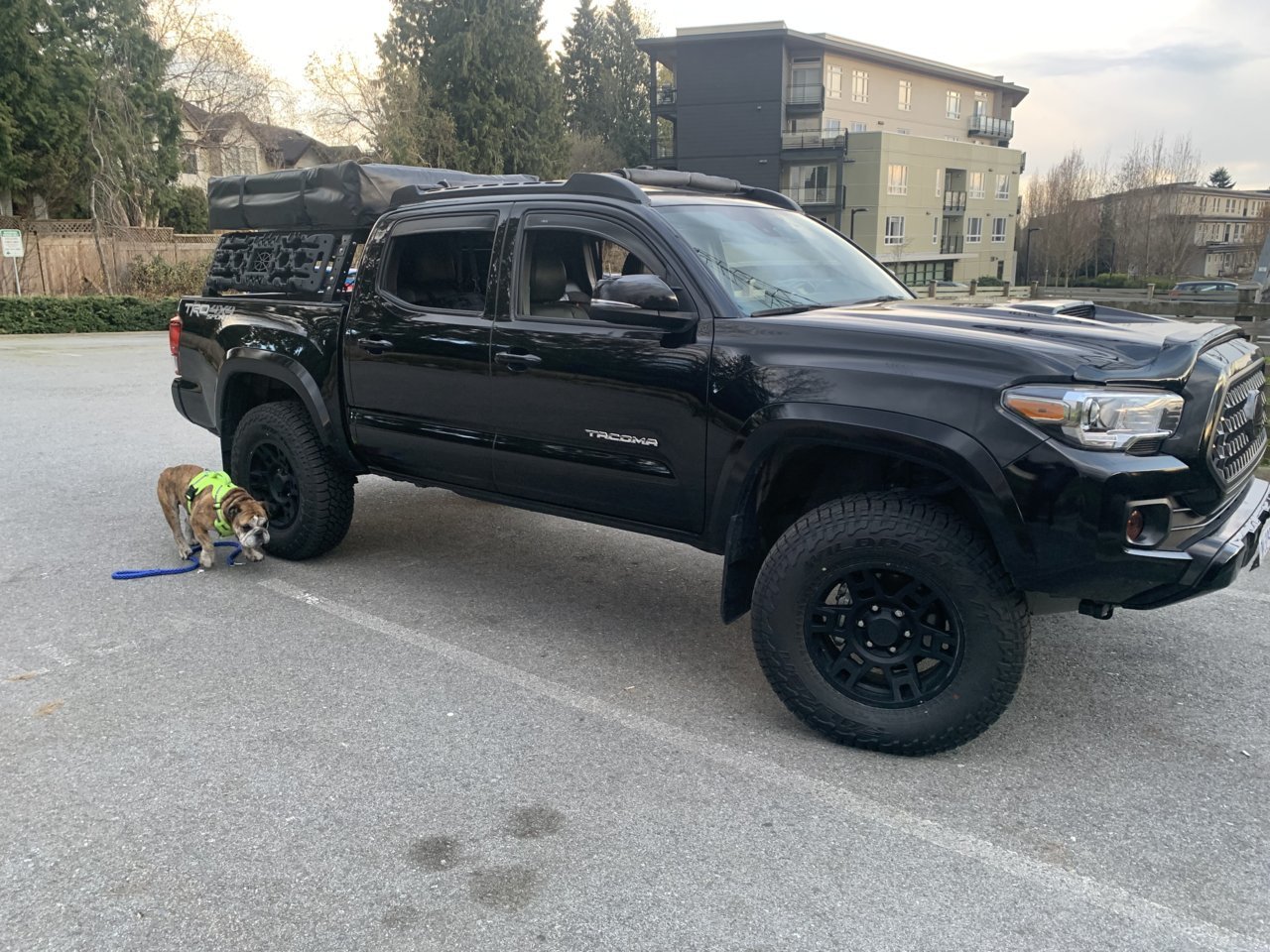

    Some Serious Tires
    It’s the width of 285s and not the height. You will need to do CMC and some trimming.
    You can always do 255/80/17 or 255/85/16 which is a true 33”, no trimming required.

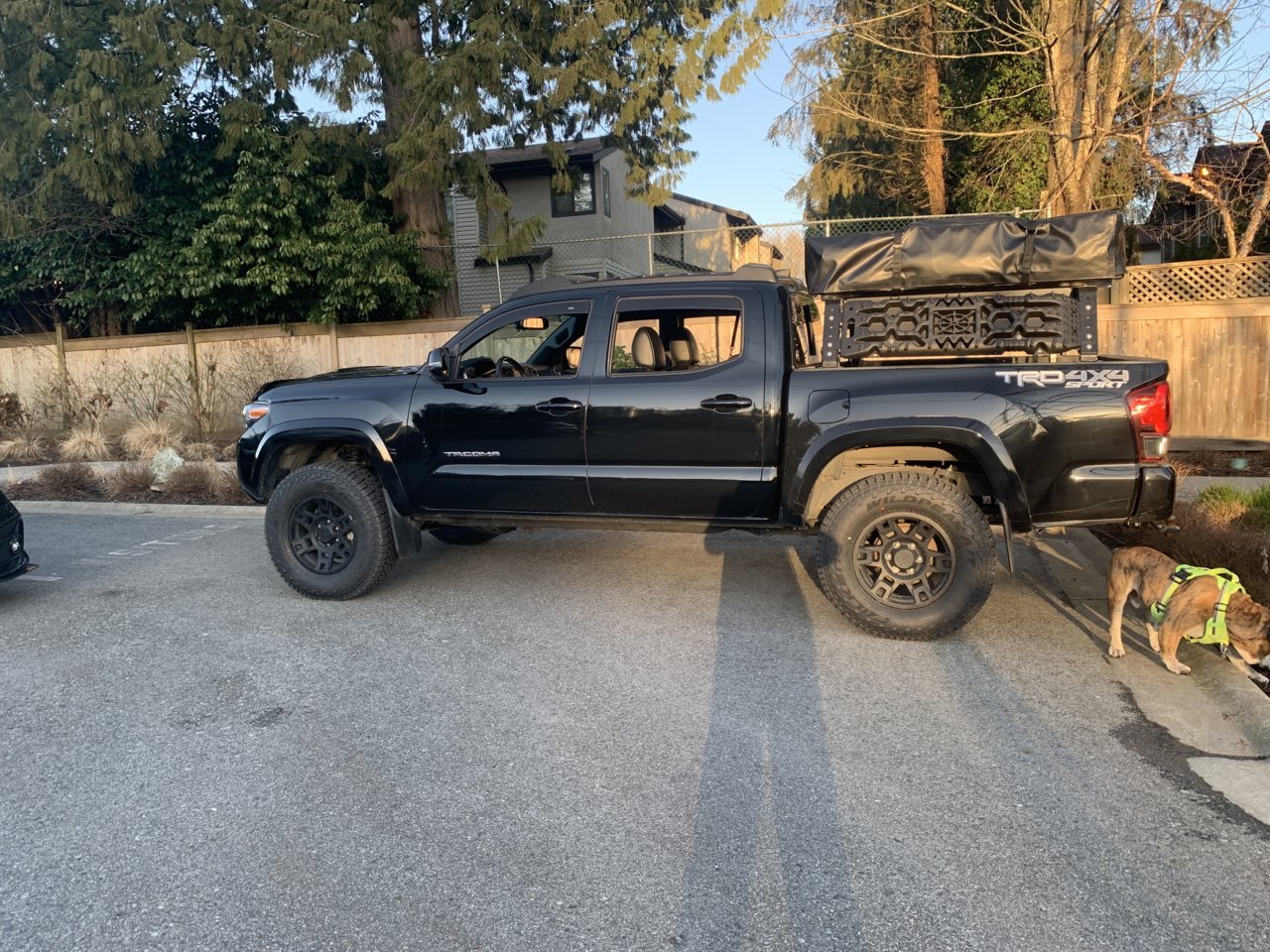

    Can vouch. If you don't want to do any modifications to your fender area, go 255/85/R16 (skinny 33)
    I run mud flaps even, with 1.25" spacers, and I have no rubbing. Caster is set forward due to modified lift components.

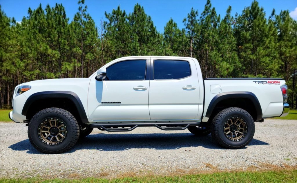

    TRD lift with 265s to give you an idea of how they look. [​IMG]

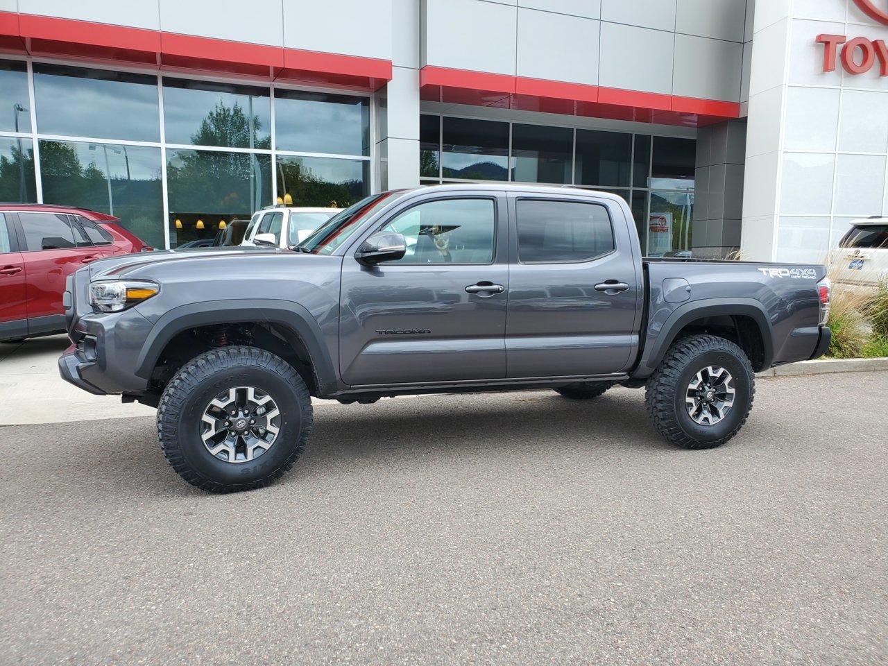

    255/85 with TRD lift for viewing pleasure
