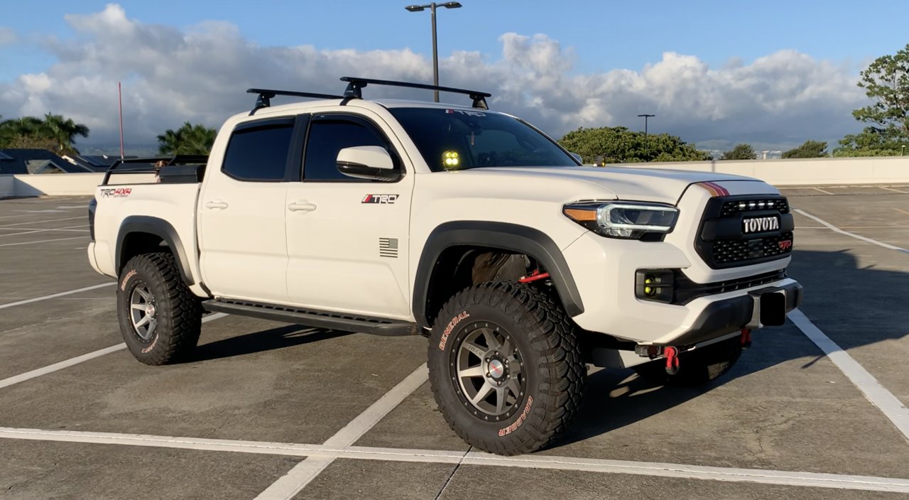

    TRD 2" lift shocks Icon AAL (gave me 1" lift with OL leaf out) 17x8.5" -12mm Trail Edition OEM replica wheels by FSW BF Goodrich KO2s (285 70 17) ECGS bushing OME carrier bearing drop kit TRD Pro skid plate Truxedo roll up Tonneau cover MESO - led interior light kit, blackout kit and gashole Toyota door sill protectors and bed mat
    Are those FSW wheels? I’ve been looking at the bronze ones for my cement.
    Inferno![QUOTED] likes this.
  4. Jun 24, 2022 at 5:37 AM
    #24
    Inferno!
    Inferno! Well-Known Member
    Nov 7, 2018
    #271952
    1,598
    El Dorado Hills
    2018 TRD OR Inferno 285/65/17
    Supercharger, sway bars, lift, leather, tires, Gobi, etc.
    Yes, 17x8.5, 0mm offset in matte gunmetal.

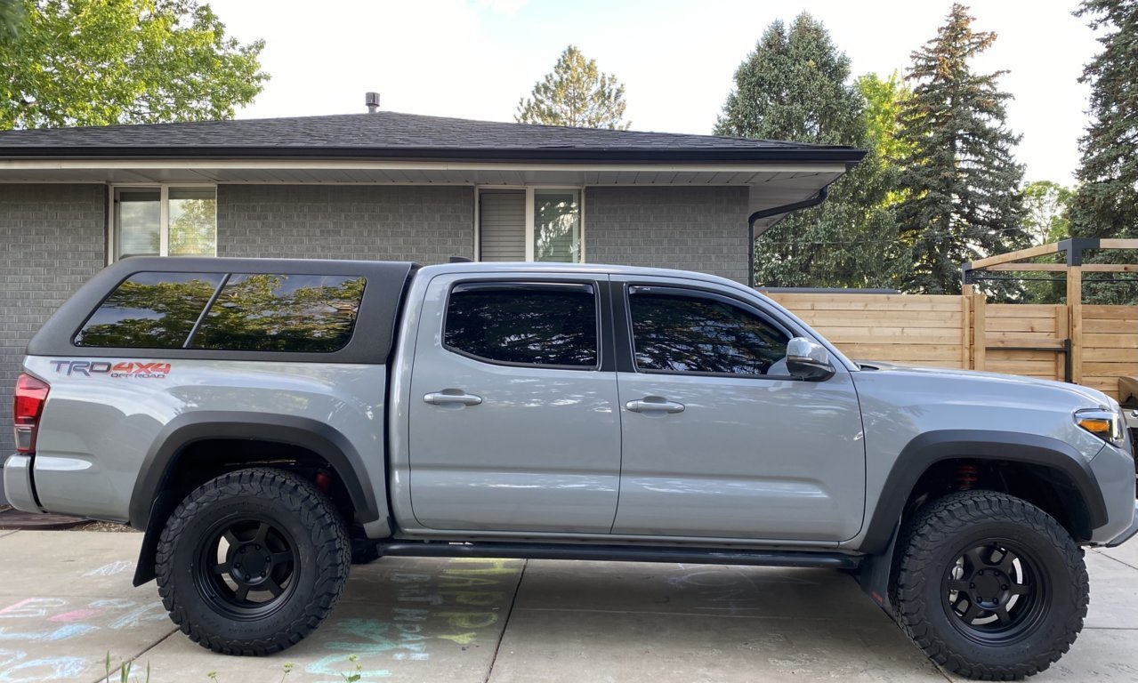

    Why not meet in the middle and go with 275/70/17… Have the eye appeal of 285s, but without the headaches. No CMC. No rubbing outside of the fender liner (which is fixed easily with trimming or a heat gun). My gas mileage didn’t change at all moving to 275s either.
    Shown my on my truck with a 2” lift / 17x8 -10 Konig Counterteer Type X / BFG KO2 275/70/17.
