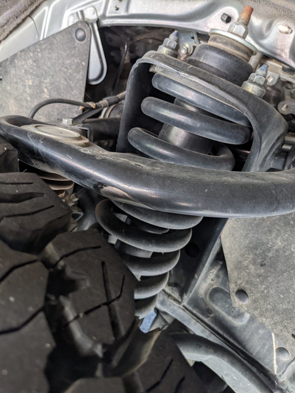

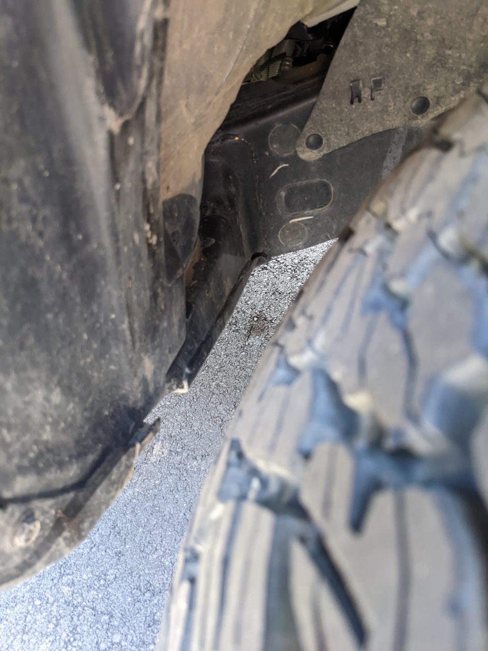

    Get 285. I've been running them for 15k miles. I only rub on the UCA when the steering is maxed Don't listen to all the people that will tell you that you need a CMC with trimming. I off-road mine pretty hard and have only rubbed once on the inner fender, never on the cab mount though.

    what offset wheels do you have? What kind of lift? Do you have aftermarket UCAs?

    Stock sr5 wheels, stock UCAs, no lift

    holy cow. This contradicts 90% of the lift theory on this forum

    It should fit fine. It's an inch taller overall, but only 1/2" at top & bottom. I see so many time where guys will talk about how this tire is 1.5" taller than another, and they expect to get 1.5" more ground clearance. It doesn't work like that; you get 0.75" extra ground clearance (at most). That extra 1.5" is spread out over the top AND bottom.

    More like 99.999999999%.
    I don’t understand how he doesn’t have any rubbing. Doesn’t make sense to me at all.

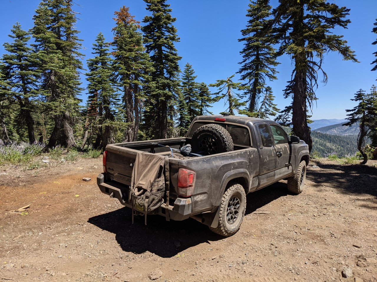

    Wait you sure you got 285s? Those look like 265s or maybe 275s in the picture.
    I just can’t believe 285s don’t rub without modifications. There is simply
    not enough room
    Width wise to run 285s.
