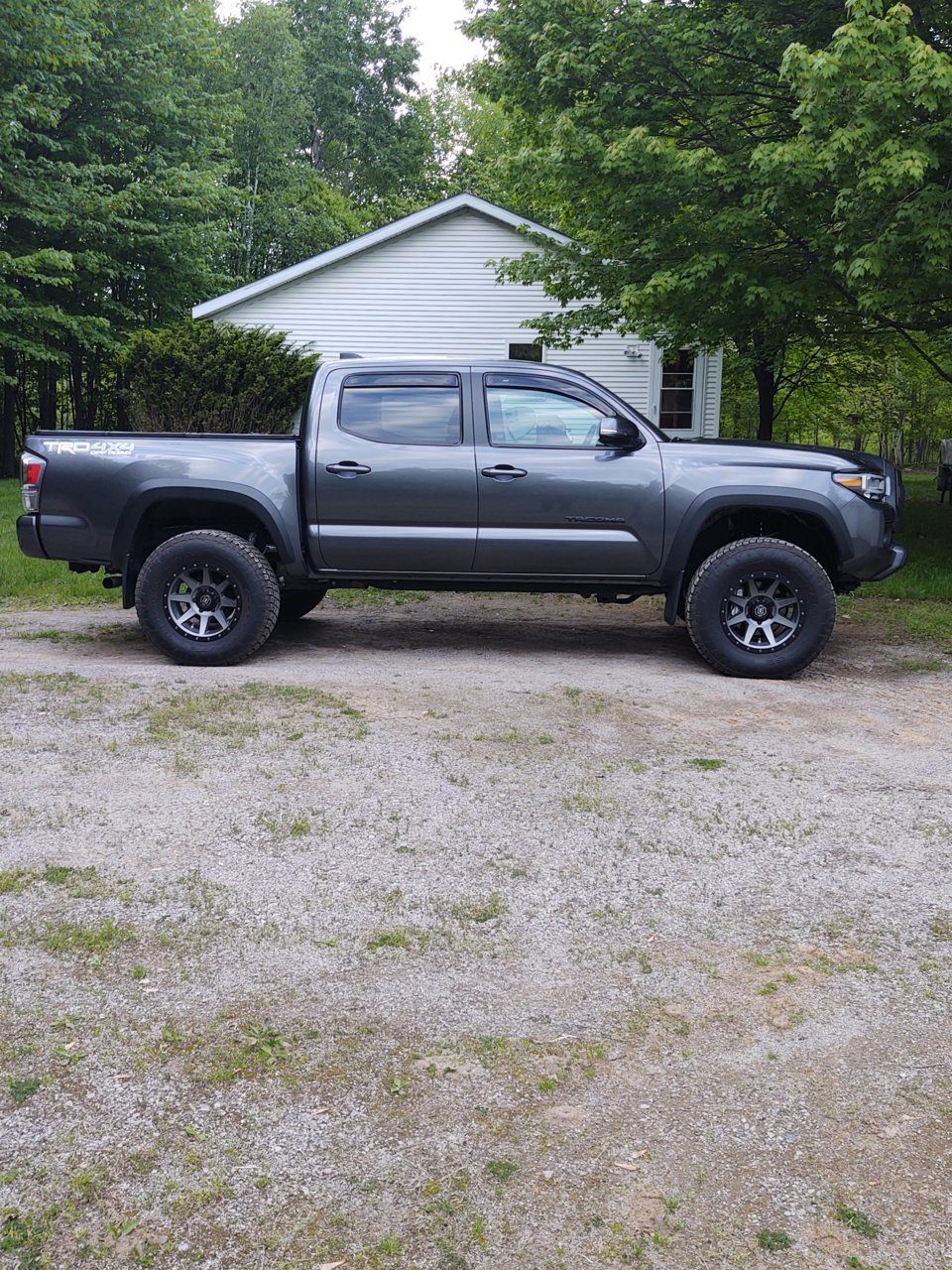

    33yrsoftoys
    33yrsoftoys Over 40yrs now
    Dec 31, 2013
    #119566
    856
    joel
    mid Michigan
    2021 dcsb off road 6 speed manual
    Bilstein 6112's 5th clip 1/4" spacer driver's side. Icon tubular UCA's with Delta joint, wheelers superbumps, ECGS bushing. Allpro standard leaf packs, 5160's, U bolt flip kit with wheelers super bump's, extended stainless steel brake lines, carrier bearing drop. Icon rebounds 17" with Nitto terra grappler G2's 285/70/17's.
    ^this^.
    And a good alignment. Remember guys, a good alignment will "not" be in spec. Positive caster should be between 3° and 4°. Those are out of spec numbers. Camber and toe will be in spec though. My 285's clear, even with the factory mudflaps.IMG_20220523_201755891.jpg

  15. Sep 19, 2022 at 3:13 AM
    #155
    mgmdclb
    mgmdclb Well-Known Member
    Jan 24, 2019
    #280479
    1,295
    The Maritimes, Canada
    2018 MGM DCLB Sport
    What cap is that you're running?
