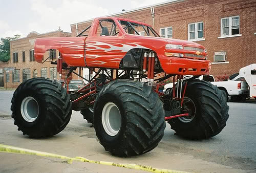

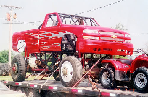

    I'll try to put it in perspective.
    This is your truck with 265's
    This is your truck with 285's
    The choice is yours. Personally, I would go with the 285's.

    hehehehe funny funny:D:D:D
    Is that yours?

    Not mine, just came across some pics and thought it would be humorous
