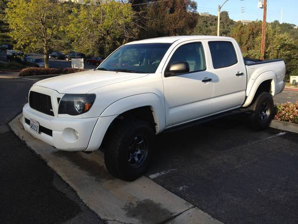

    I've installed a lot of Konig Countersteer Offroads 16x8" et 0mm (4.5" backspacing) with 285/75/16 tires on Tacomas lifted 2.5" ~ 3".
    Plastic over fender and fender liner trimming is necessary. Other than that I never had any issues.
    No spacers necessary either.
    With that said, given that you want to set the 5100's to zero or .85", I think your best off going with 265/75/16. This will still look really good, and you won't have as many (or maybe not any) issues with rubbing at all.
    Here are some images I have of 265/75/16 on the Countersteer Offroad wheels (user name "skunk" here on Tacomaworld). I will try to dig through my hard drive and find some more for you.

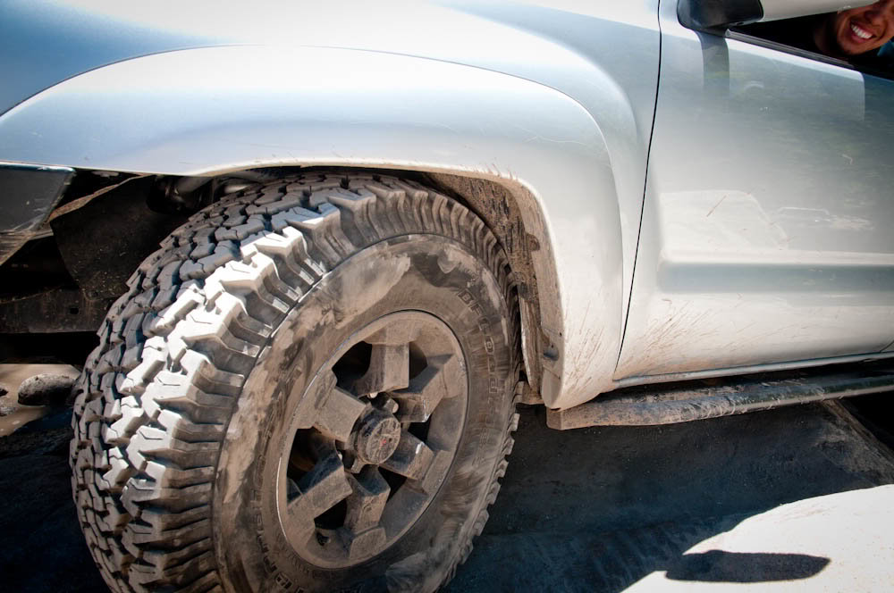

    x2
    Look at the pic I posted above.
    I have a full OME 3" lift, 285/75/16 with the correct 4.5 BS
    I rub when I offroad. Shit, I rub on-road after a day of wheeling (and before I get an alignment)
