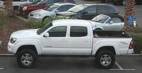

    5100's all the way around. Front set at .85. Camburg Spindles. Camburg Uniball 1.25 UCA's. Total Chaos LCA skid plates. Custom Deaver 10 pack rear leaf spring. BFG AT KO's 285/70/17, Weathertech floor liners, Wet Okoles. Midland CB/PA, Firestick.
    Love my 285/70/17's BFG's -
