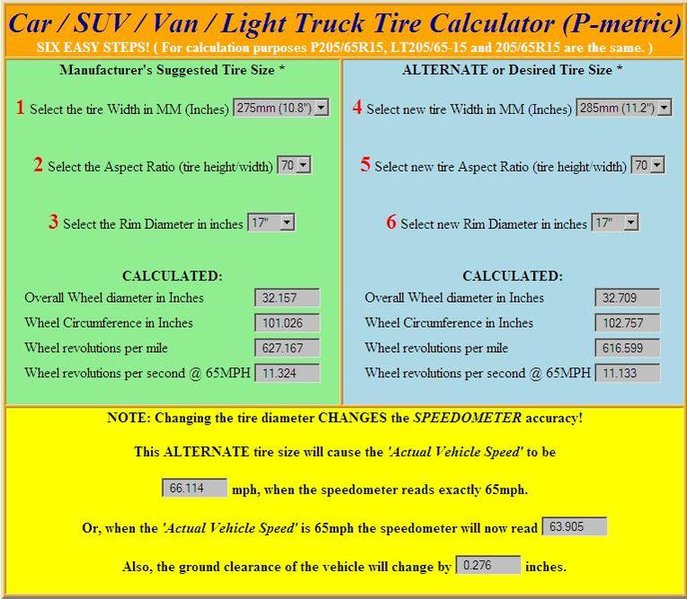

    I think he means you don't get much more size from a 285/70/17 compared to the 275/70/17 , but considerably more issues with rubbing , spacers or aftermarket wheels , lose the front flaps , possible cab mount chop

    I agree with Teamfast there. 275/70R/17 to a 285 is only a change in width, not much else. for a visible difference in width, push them out with wheel spacers.

    That's just not true, it's as much gain in height as it is width.

    3/8" wider and 1/2" larger diameter , making your truck 1/4" taller
    Not noticeable

    1/4" may be valuable to you, however it is not visibly noticeable.
    If that 1/4" is important, then do it. If its looks, then 275 is fine and push them out with a wheel spacer.
    Its all about your choice and what is more important to you.

    The point is I guess, is a 1/4" worth all the hassles?
