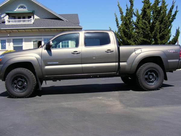

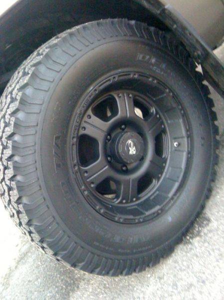

    ho-ly.shit. thats exactly what i have. Yes you can run these with stock uca's and you will be fine

    with 5100's and TSB

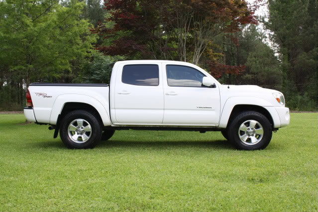

    I am running 285/70/17's on my 05. Completely stock. The front mud flaps had been removed prior due to breaking with stock 265's. They will rub uca a little if you max turn left or right but do not touch during normal driving. I have had them on two years, no problems, drives excellent. Hope this helps. Good luck.
