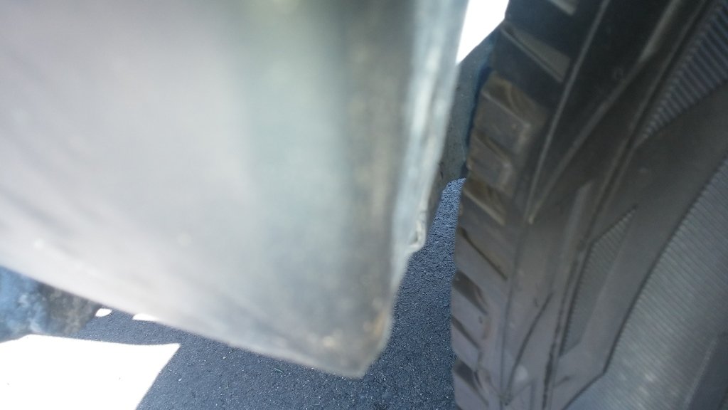

    I think the back spacing is the same as the stock wheels, do you have the bfg at ko2s oz? I noticed mine isn't rubbing at the fender, its the metal next to the fender. If my caster is at 2.3, would that cause an issue?

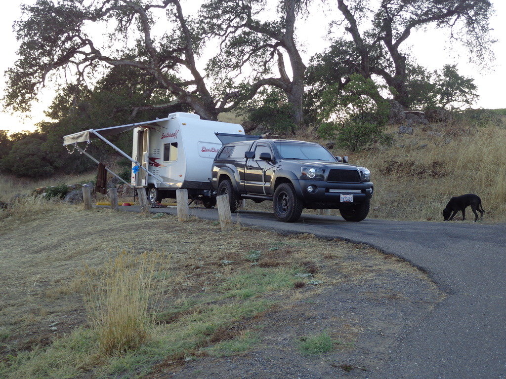

    5100 all around set at I think .75. Guy I got the truck from said this but I have not confirmed.
    If I stuff them they rub. But normal driving no rubbing. Its close tho.
    0317151000a_630858813f9ef0f9a444fe44c64433375c894bd5.jpg tr_d0956de92d2e71bfb97bb8709db94901fbf47bd5.jpg

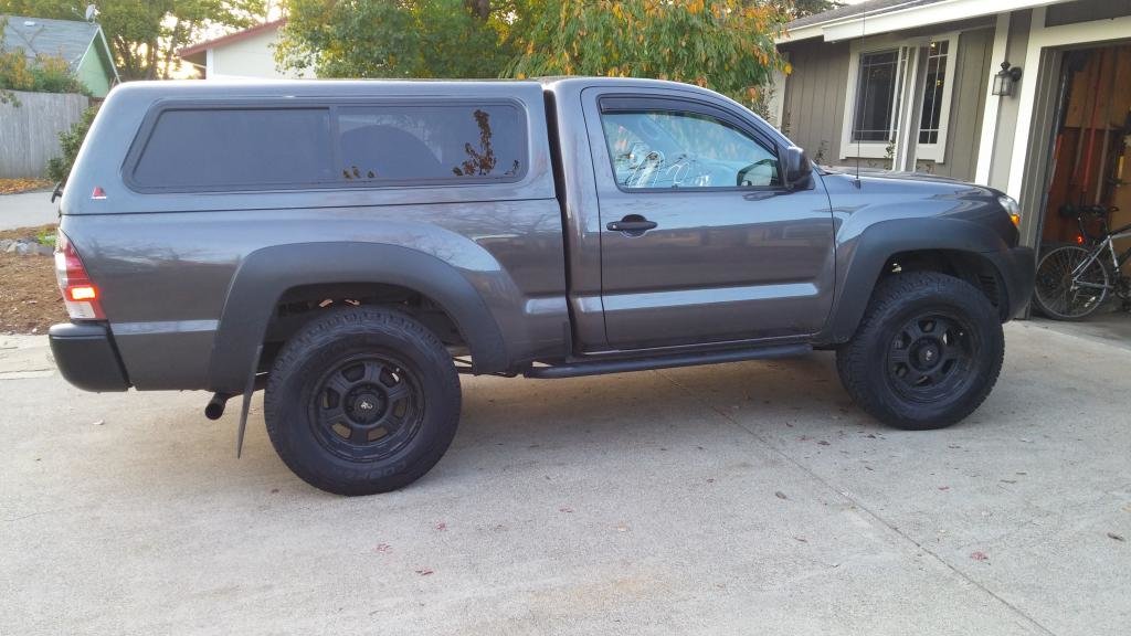

    I think I found my solution on the SPC website for the rubbing via adjusting the LR UCAs.
    http://www.spcalignment.com/faq?kbartid=25460
    Says that I need to adjust my caster and I should be clear from rubbing. If that doesn't work, i will go back to my 265/65/17 BFG Rugged terrain or set the 5100s to .85 and get the 2" AAL kit from toytec. I want to keep the spacers because one, it looks a whole lot better and two, the tire will most likely rub the UCA. I'll be dropping my truck off at firestone tomorrow to have them realign to camber: 0, caster: 2.5* to 3.0* and toe: 0. I've read on alot of threads that those are the ideal specs with a 3in lift.

    That should help but I don't rub the UCA with my 275's and no wheel spacers

    Got the alignment done and no more rub :) ill see how she does offroad later.

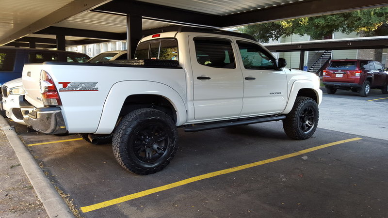

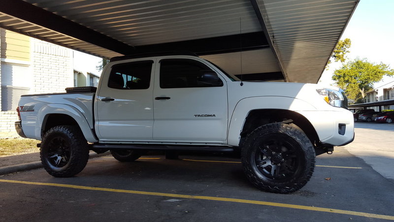

    @Kevo526 , when you get a chance, can you post some pics of the new tire setup? I think our trucks are identical except for color, want to see how that looks. Might do a very similar setup.
  15. Sep 25, 2015 at 1:33 PM
    #35
    Kevo526
    Kevo526 Well-Known Member
    Jul 8, 2015
    #158990
    179
    Kevin
    Camp Lejeune, NC
    2015 White Tacoma DCSB SR5 4x4
    Bilstein 5100, OME 885s, Deaver AAL, LR UCA, 17x9in black rhino sidewinders w/ BFG KO2 275/70/17, SOS Concepts sliders and rear bumper, Nfab light bar mount w/ 30in light bar.

    So u got about 3/4in from the tire size change and 2.5in from the bullies and 885's. Is it fairly noticeable from stock? Looks pretty good
