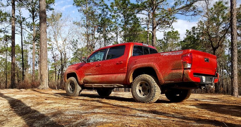

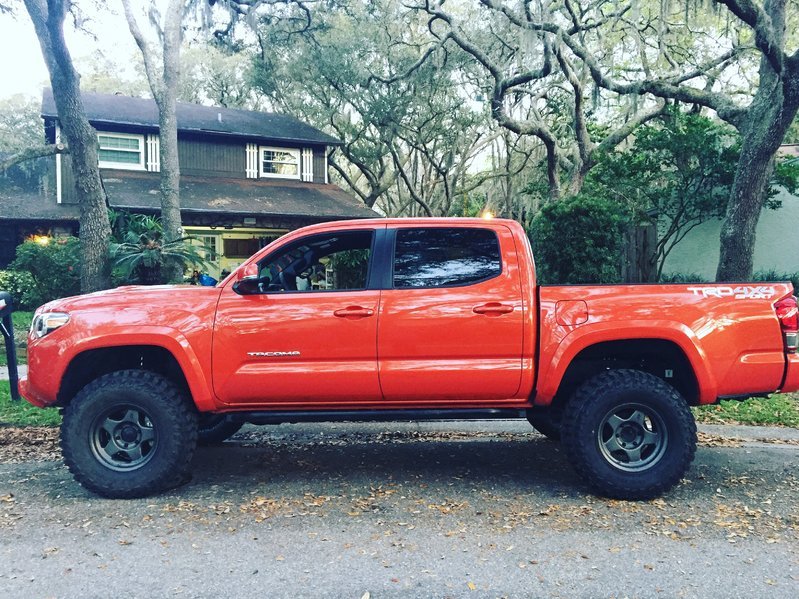

    @tripleseven . I originally went with a 275. However, after the lift, i didnt feel it filled the wheel well enough. I sold my 275 bfg ko2s and went to a 285 cooper stt pro. I was extremely close to hitting my cab mount however i was rubbing it. even at full stuff. With that said, i did do my CMC because i would rather not risk anything. We take the truck offroad almost weekly.

    Here's my truck with 275 ko2.
    Heres my truck with 285 coopers
