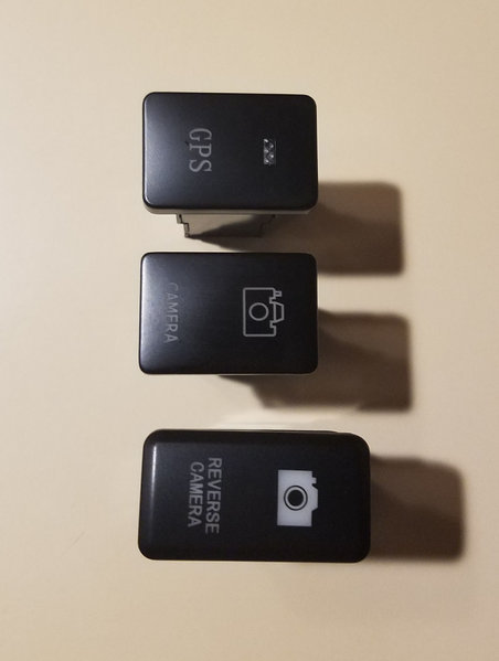

    Gotcha. So that means I should cut 15, correct?
    Also, do I need to add a switch to pin 17 to use the camera if going above a certain speed? Or is that optional?

    Yes if you want to use HU for front camera or mirroring. Switch is needed but not necessary to mount on dashboard. Switch may use when you want Navigation update your location faster.
