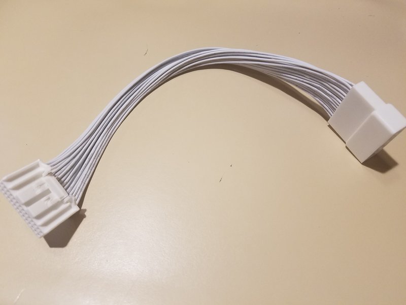

    Will this include instructions for wiring, etc?

    Have you figured out how to do it for 5th gen 4runners?

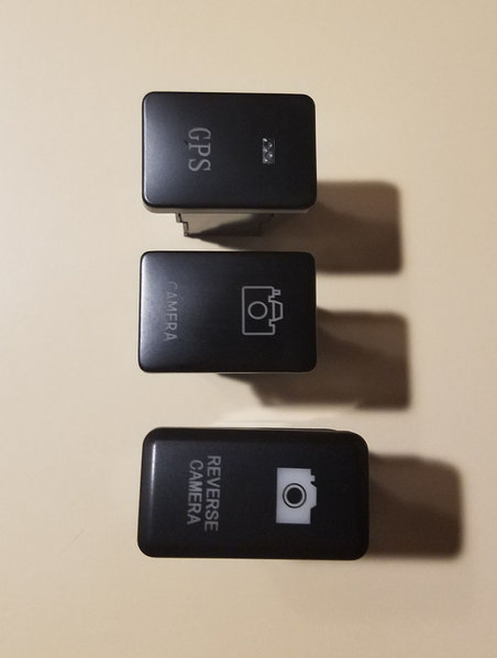

    OP updated with switch wiring color code.

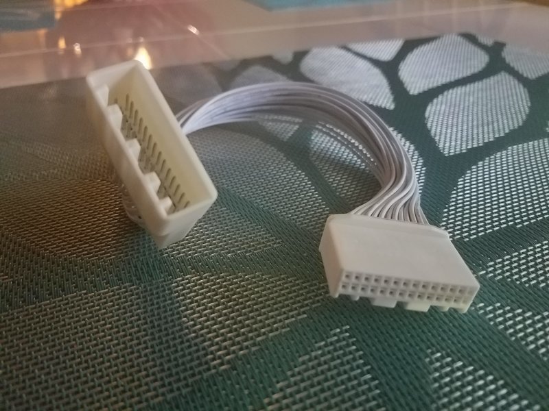

    what side of the 28 pin wiring harness do we attach "input" and "output"?

    Will the diode be soldered on?

    Diode will not be soldered in for piece orders but will be included. Honestly, if you already know how and plan on soldering the wiring connections, its easier to put the diode in at the same time.
    This posting is more for DIYers.

    The side that fits...
    Seriously. You can't put it in backwards. Kind of like an extension cord. It's pretty self-evident which end goes where.
    (plug goes into radio, socket accepts the OEM harness plug)

    im not talking about the plugs themselves.
    Im talking about what side i tap the switch wiring into.

    I've heard the navigation GPS override has caused issues for those of us 3rd gen owners with the premium and technology package (@brendanwebster911 also shared the same and conflicts with ABS)
    Seems to be okay for others without P&T package. Can anyone else share their experience?

    What issues are you talking about?
    I have the technology (non jbl) package. I just installed mine but haven't noticed anything.
