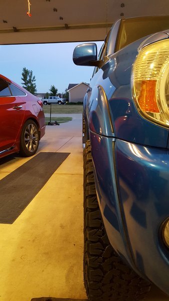

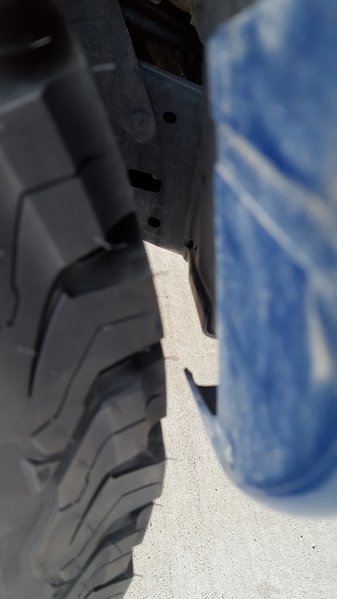

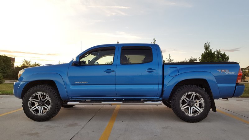

    Just installed some BF Goodrich All Terrain T/A KO2 285/60r18 on Tuff A.T. T01 18x9 rims with a +10 offset. Had to remove the factory mud flap but now rub free. Thought I would share some pics and rim specs for others.
    I'm planning on adding front Bilstein 5100's set at 1.75. I would like to get some opinions on if I should replace my springs?
    I only have 68k on them but they have seen 10 Iowa winters, the powder coat is flaking a little I noticed. If I do get new springs is it better to get the lift from a taller spring or setting the Bilstens at 1.75?
    I mainly use my truck as a daily driver not off-roading so a smooth ride is the goal.

    Nice! Fills the wheel wells perfectly. Any changes for the speedometer or odometer? (Newb question...just grtting back into it all. lol)

    cruise set at 70 my gps says 71. tire calc all said it would be off by 1mph at 35 and 2mph at 70 seems pretty close

    I've seen alot of post on here of others saying 285/60r18 would rub like hell without a lift. those who said they don't never know for sure their wheel backspacing. the backspacing is huge, a -12 would rub bad but the +10 does not

    Who says those would rub? They are overall stock size why would they rub?

    265/65r17 = 30.6" tall x 10.4"
    new
    285/60R18 = 31.5" tall x 11.2"

    Close enough. It's no chance that size will rub

    I agree. Those shouldn't rub even without a lift. Hitting the mudflaps is all about diameter of the tire and spacers, not the lift, since the suspension moves up and down not front to back.
