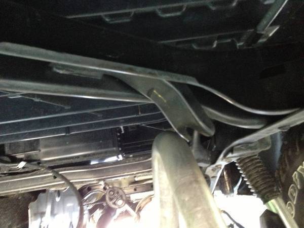

    I got it under there. 285 pro comp MT, given to me from a fellow TWer. Was running against the axle a bit, but I used a bungee cord, lowered the spare a bit, pulled towards the hitch, and did my best to secure it for the time being. This will be a temp fix, til I can head down to Home Depot or something a grab a ratchet strap. To add the that, I'll probably try and bend the tabs back forward more towards the original location and mess with it little by little until it gives me the same clearance I have now with the bungee cord.

    SMH that's what I'm tryin to avoid! Spending anymore money!! Lol... I just finished securing it with a ratcheting strap, shits not going anywhere!!!
    Not the prettiest, but it should do til I back from vacation next week.
