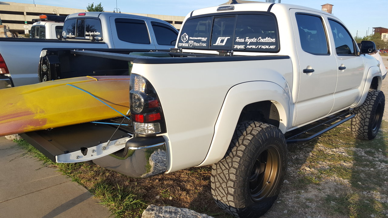

    5" front 3" rear
    SCS F5s
    17x9
    3.5 bs
    -38 os
    Nitto Ridge Grapplers
    CMC done and trimmed bottom inner portion of plastic fender flare on the fronts

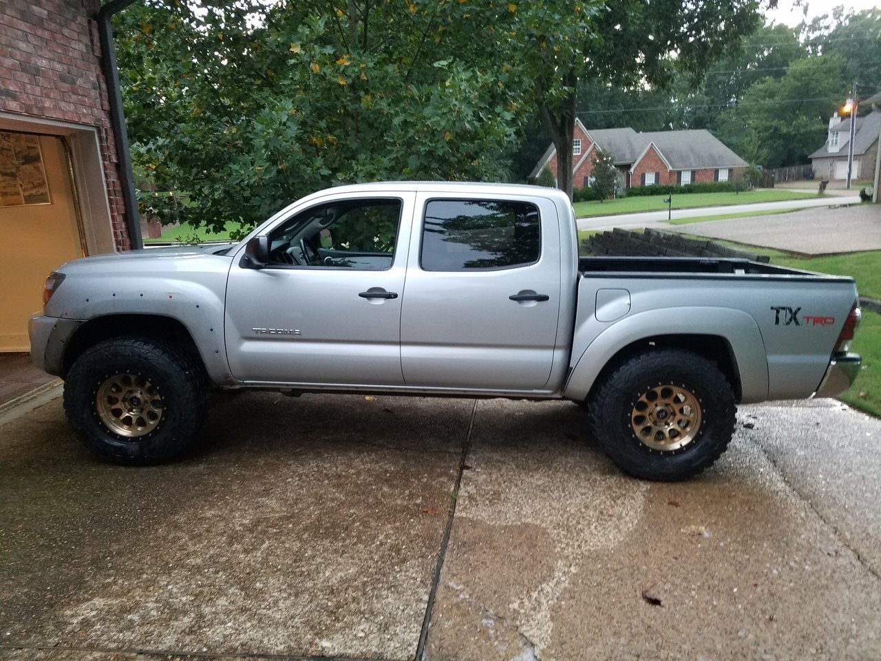

    Looks good! I have never seen anyone running those tires. How do you like them?

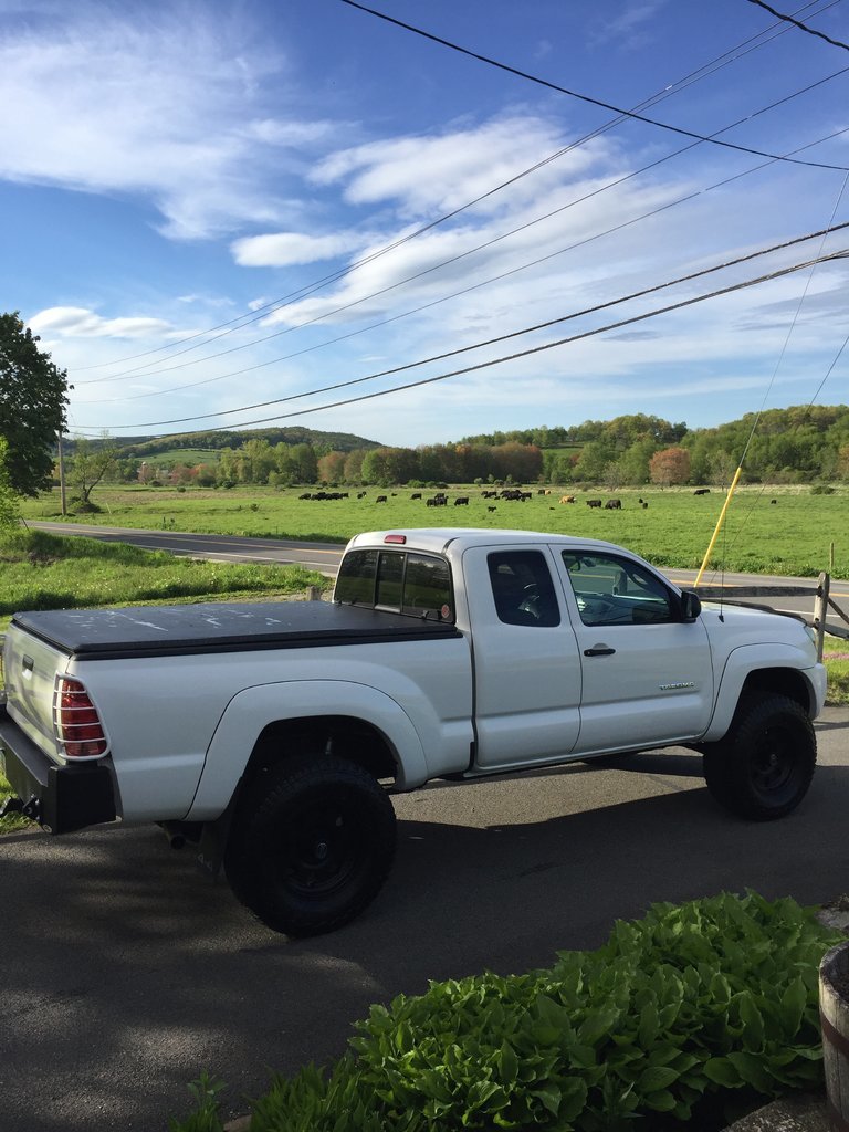

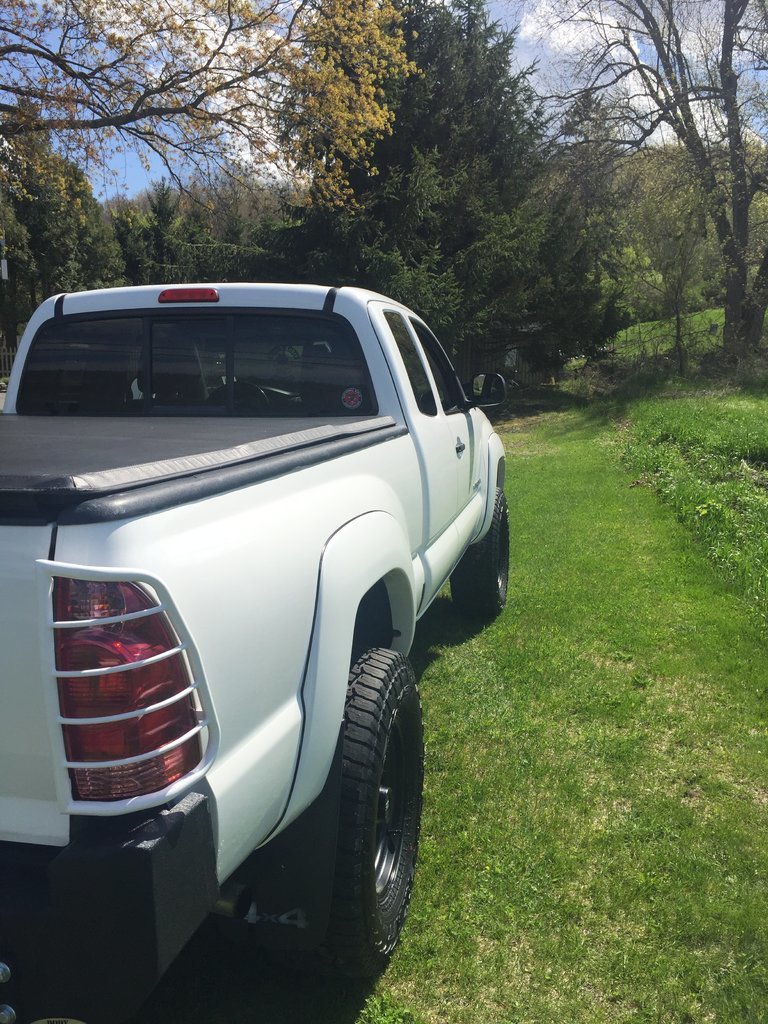

    IMG_4456.jpg IMG_4384.jpg IMG_4381.jpg Falken Wildpeaks AT/3W 17x9 -12 offset bilstein 6112 top clip 2"AAL in rear . No CMC , just removed front flap . No rubbing any where !285/70 17 15-17 mpg

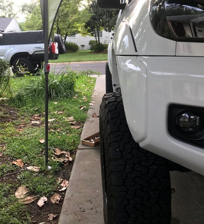

    285/70/17 KO2
    SCS SR8

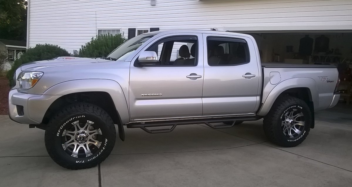

    Stock FOX 275/65/18 At3w 18X9 Fuel Vapor's
    Here we go.

    Looks good! What wheels are those? What Sizes? Lifted? Rubbing?

    The wheels are 17X9 RaceLine Raptors. Truck has a 3" lift (actual 2.75) and original the front factory mud flaps would rub slightly where
    they bulged around the frame / cab mounts if I grabbed the brakes or hit a large bump while turning. I changed them the Husky and no more problem.
