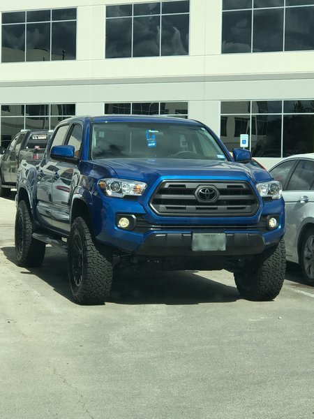

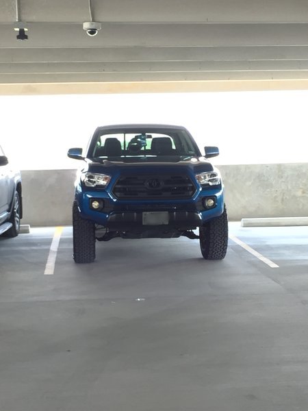

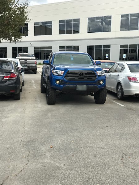

    Maxtrac/Bilstein suspension 16x8 Pro Comp 69 315/75/16 Dick Cepek Morimoto Profile Prism RGB Halos & Demon Eyes
    I have this setup on my stock TSS wheels and a 2in front spacer from RoughCountry. W/O the wheel spacers, I rubbed on the UCA's and on the fender well.
    After the wheel spacers I cleared the UCA's. After 2in spacer, I barely rub on the fender well, had to do some trimming though.
    I rub pretty bad when suspension flexes or coming off of a steep driveway. Sounds almost like a clunk but it's the rubbing. Might be rubbing on the cab. So just imagine off roading how bad it'd be. I do all hwy so It don't bother me much lol.
    Going to get a 3 or 4 inch lift to clear as much as possible. I say if you want to avoid having to trim or do a cmc or spend money on a big lift, stick with 265/70/17 for no rub, or idk maybe even 275/65/17 or 275/70/17 will fit.

    I will however say, they look amazing and give the truck a better stance than the stock tires. I also didn't re gear with these tires. I know some people will because they add weight to the truck and slight loss of power but nothing a little more foot on the gas won't fix lol
