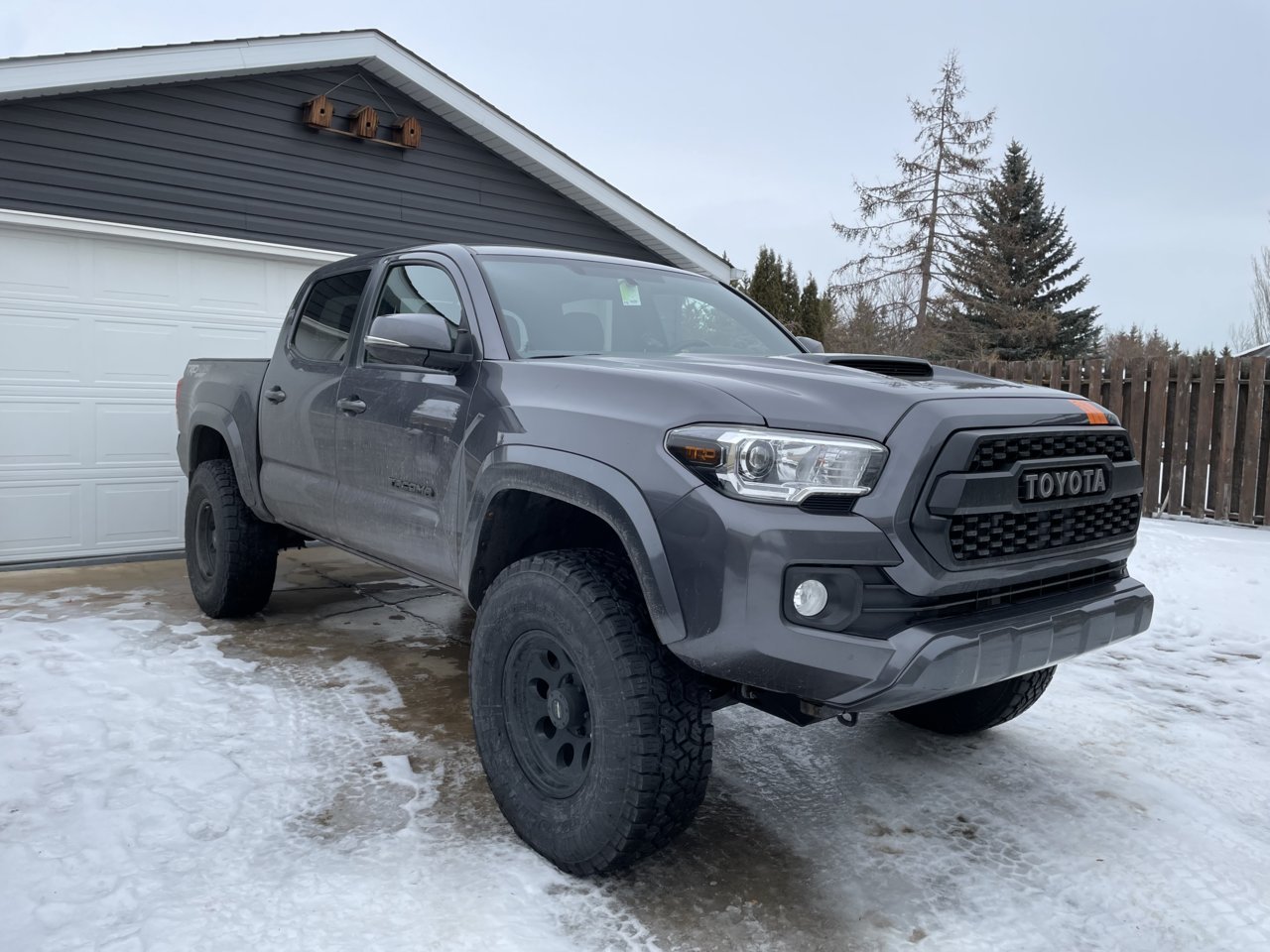

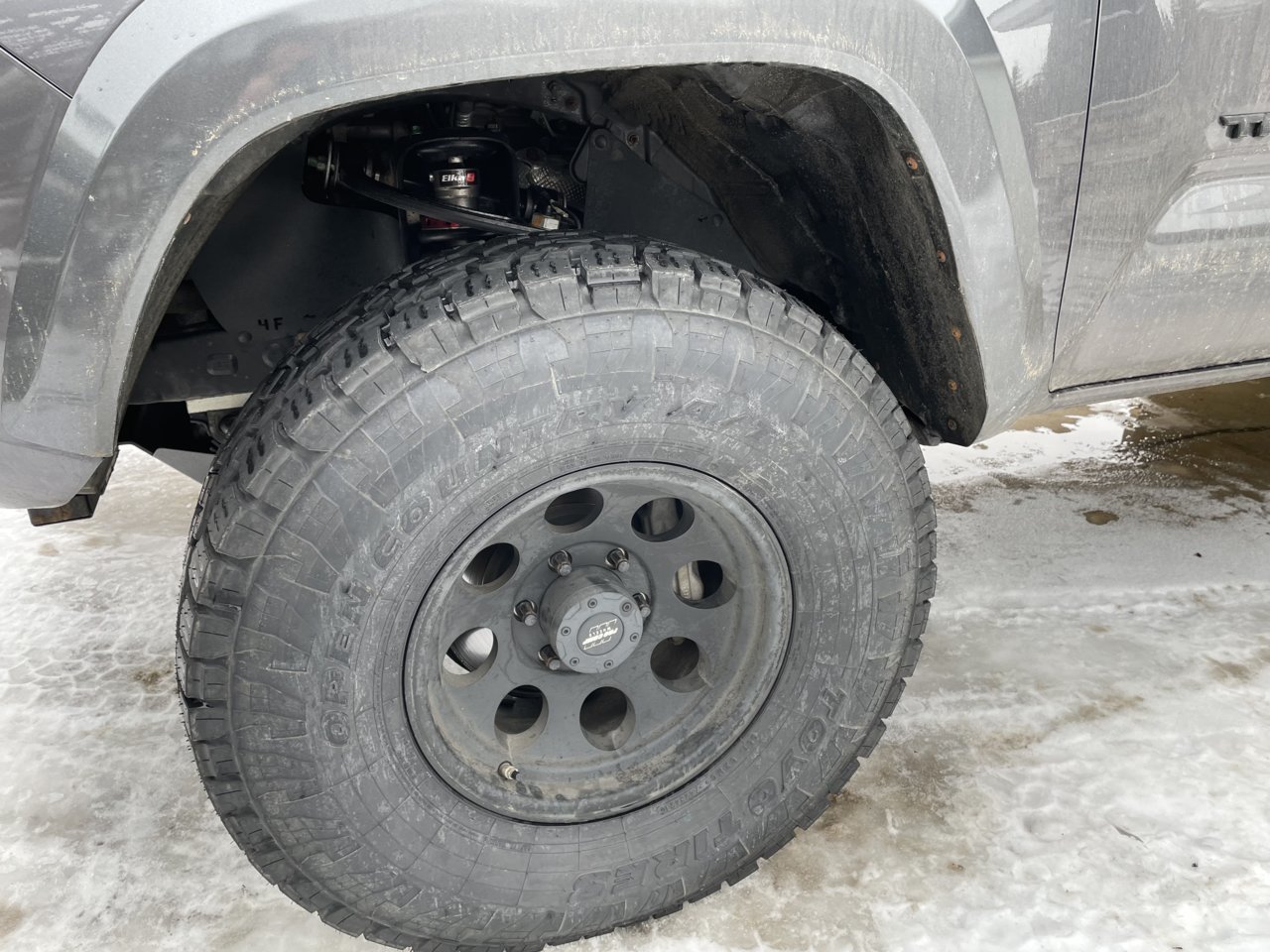

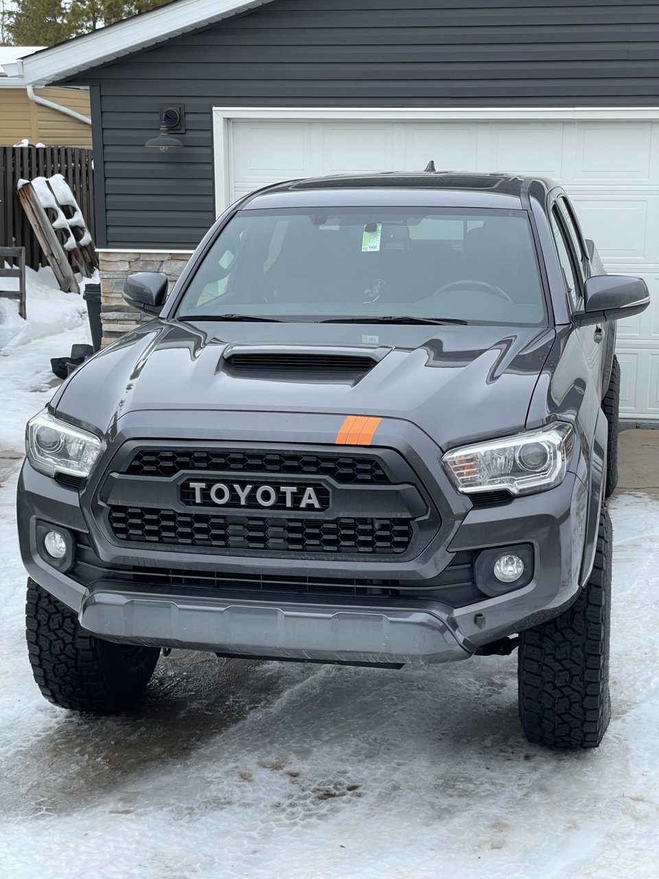

    Elka 2.0 Front & Rear (2-3" Lift) - Extended travel 5.29 Nitro Gears ICON Toyota 3 Leaf Add-a-Leaf Specialty Products Company Upper Control Arms ECGS Clamshell bushing Cab Mount Chop Stage 3 (including Trim and Tuck) Greenlane T3 Engine Skid Plate (With Oil Filter Access) - Powdercoated Black ProComp 16x8 Black Rims (-12 Offset) Toyo AT3 295/75R16 tires OVtune - Premium tune with THX K&N Aircharger Cold Air Intake Magnaflow Cat-Back Exhaust

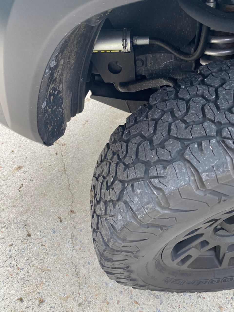

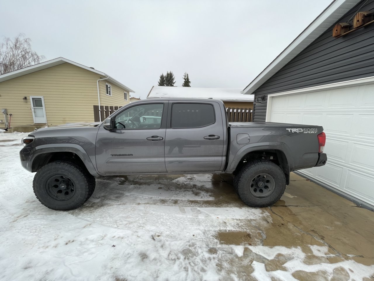

    I just got 295/75R16's (16x8 -12 offset) on my 2017 Sport (done professionally by a custom Toyota shop). I required cab mount chop, trimming and lining modifications for full travel with a 3" lift. Worth it IMO, great clearance and looks awesome.

    Awesome man.
    Pics?
    She’s a little dirty, but here’s some quick shots
