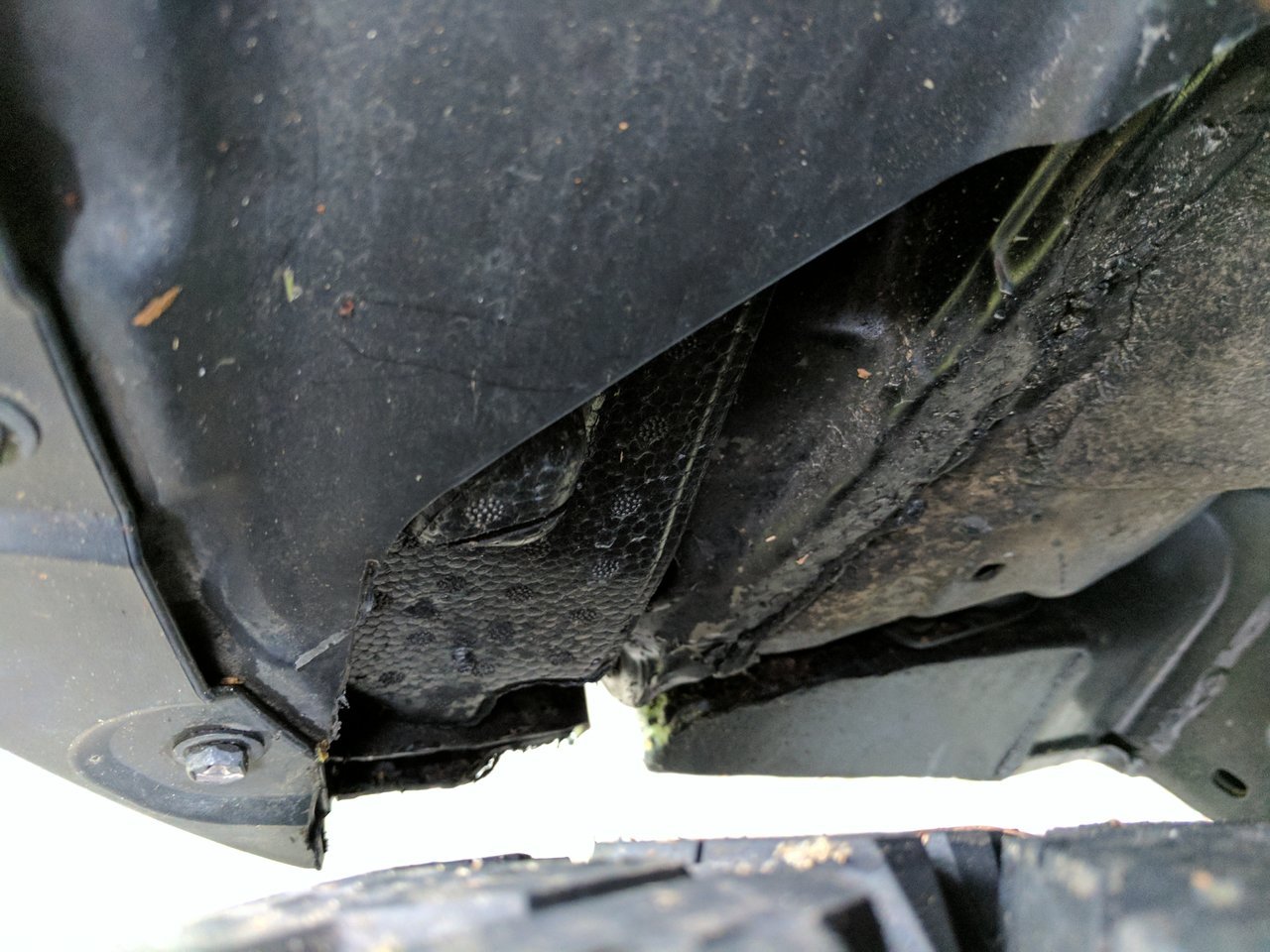

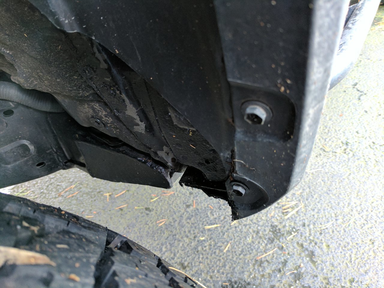

    Definitely won't be loose and floppy, there are more bolts right nearby. I promise.
    You might get away with it with stock OR wheels with their huge inward offset (and probably rub UCA in the process), but not once you push your tires out with the offset your new wheels have.

    Thank you for the pictures and encouragement (I really need it)! No trimming on the front of the wheel well? I am wondering if I am having more issues than most due to a larger than average wheel width. My theory may be wrong here, but I think that the wider wheel width causes less balloon effect on the tire side wall so it inflates to a slightly larger overall diameter.. I don't know if that makes sense but I wonder.

    9" wheel is definitely contributing. Only had rubbing on the front when I brought my caster too far forward. The front is much easier to cut as it's all plastic (no welds or anything).
    Get a full front bumper and all that plastic goes away too :)

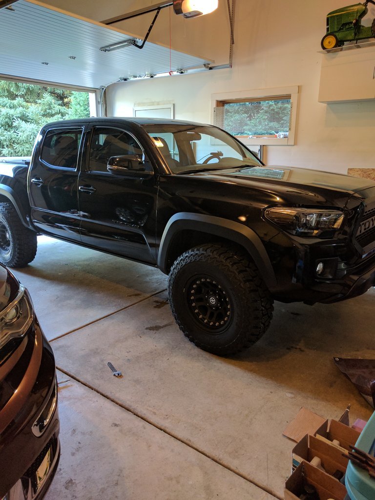

    Here she is

    I can see why you hardly can turn lol. Nice truck! And a BAMF grill :thumbsup:

    What kind of tires are those?

    Mickey Thompson Baja Atz's.
    I don't know why I never see people with these but when I saw them in person today I thought "holy shit, did I buy M/T's?" tons of void between tread and the most legit aggressive sidewall imo. Yeah, there probably not as quiet as K02's but a little noise for a lot more tread void is an easy compromise for me.
