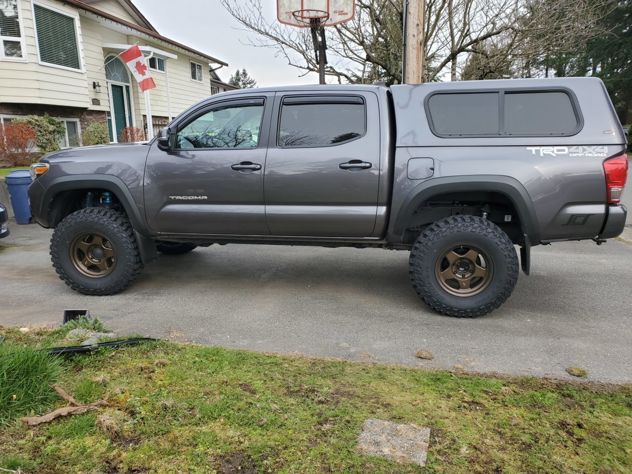

    I did my research and this is the path I followed, thanks @Stefan_Ray
    The 285 75R 16 Cooper STT Pro's don't rub at all and a good 3/4in from the cab mount, forward and reverse full lock. Haven't done any flexing as I just put then on today20210323_161430.jpg
