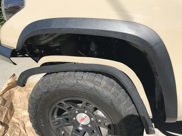

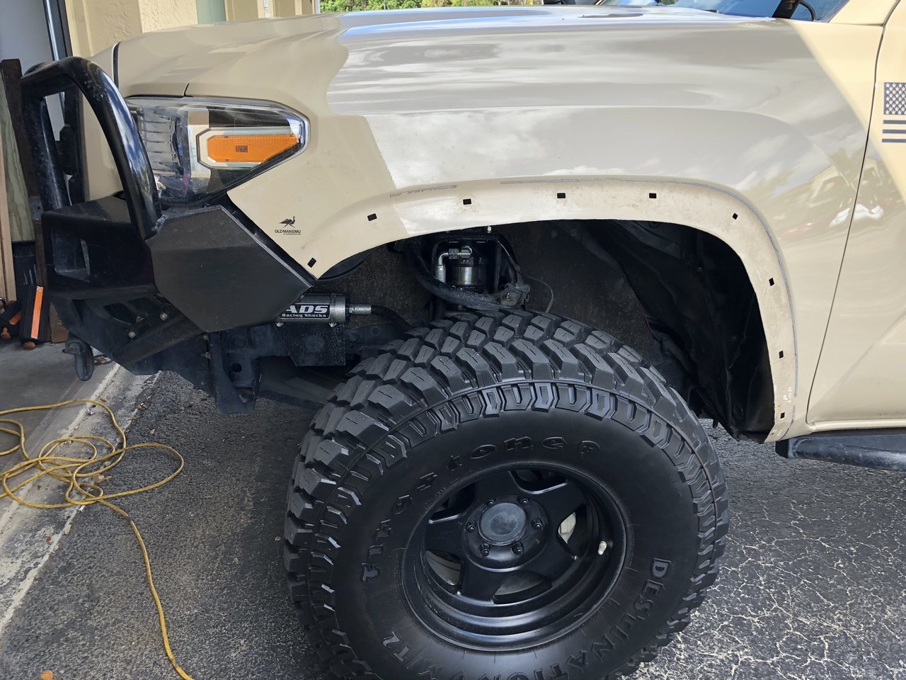

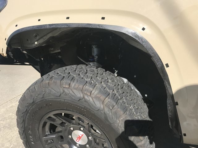

    After playing in Moab for 4 days and running some pretty tough trails I discovered that no additional fender trimming was really needed so I do not have a personal write-up for how to trim your fenders. I took some photos of @mesojdm had shared on the trimming he had done to avoid rubbing on the 35's. The fender trimming is most likely attributed to those running wheel spacers up front and/or long travel suspensions that push the wheels rather wide. Others running spacers may be able to confirm this @yota90.
    Cutting the fender is something you will need to determine before making the plunge.

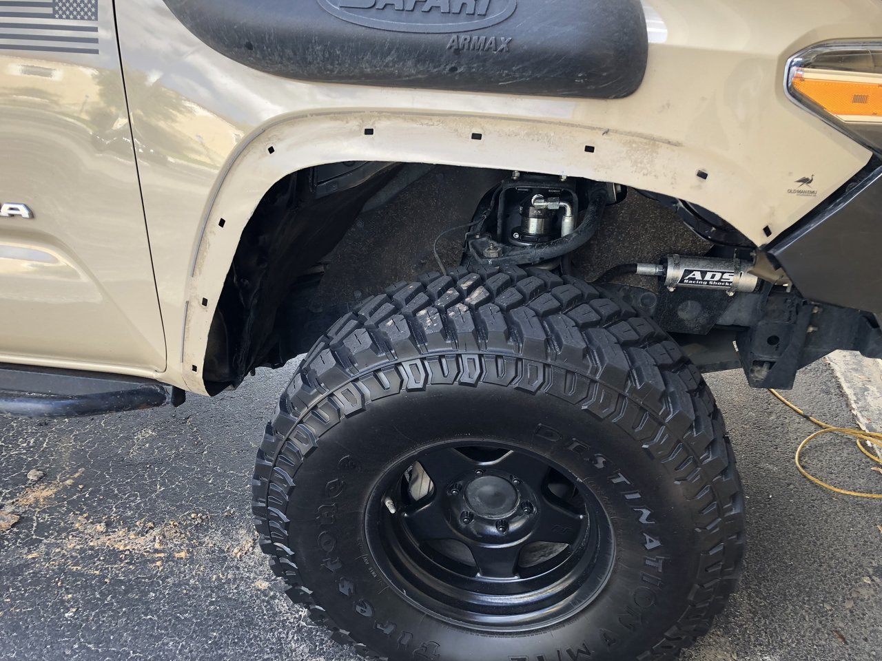

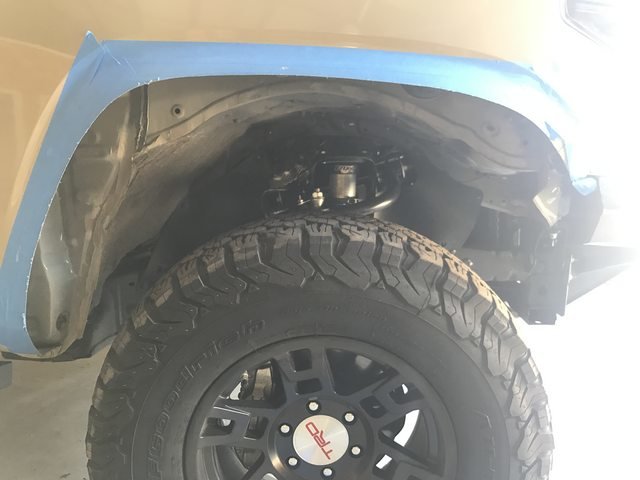

    Below are some photos that @mesojdm shared.
    Here are some additional photos from @Trident904

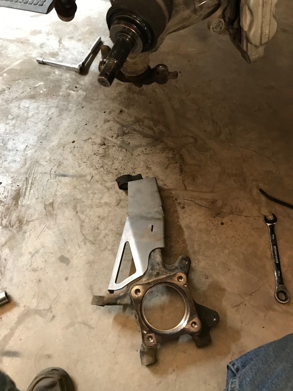

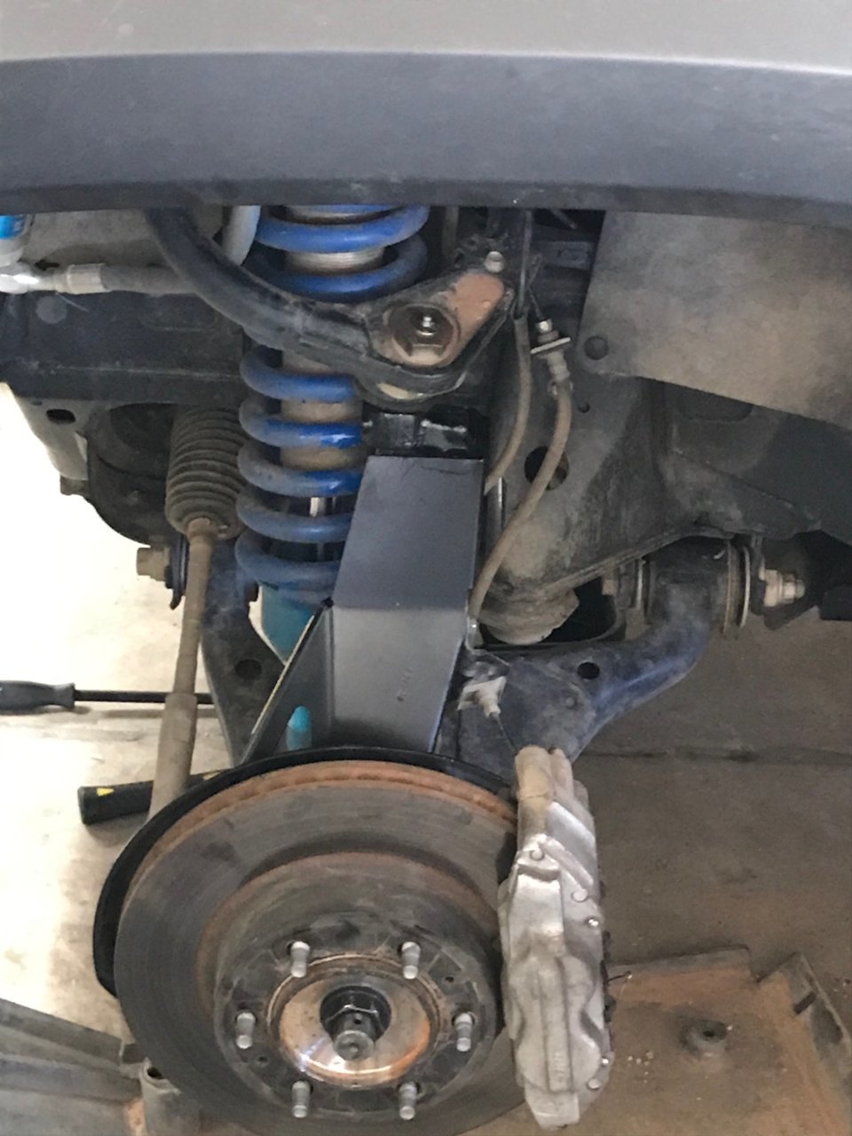

    Spindle Gussets
    If you intend to wheel your truck with 35s, then spindle gussets in my opinion are a requirement. You can probably get away with it for a while but over time the Spindles will begin to bend and the knuckle will become weak. There are several options available for guesseting the spindle. I went with Bajakits and it seemed to provide the reinforcement needed. However, the Bajakits spindle gussets do not fit perfectly and will require a lot of work to make them fit in order to weld them. It's a solid idea that they came up with but its not perfect, prepare for additional work to fit these. Other options include Total Chaos.
    TIG welding is your best bet for spindle gussets as the spindle can handle the heat and a TIG weld will be much stronger than if it was MIGd and the last thing you need to be worrying about on the trail is breaking a MIG weld.
    I followed this thread to remove the spindle and it was super easy!
    https://www.tacomaworld.com/threads/how-to-swap-your-spindles.204242/
    Test fitting the gusset.

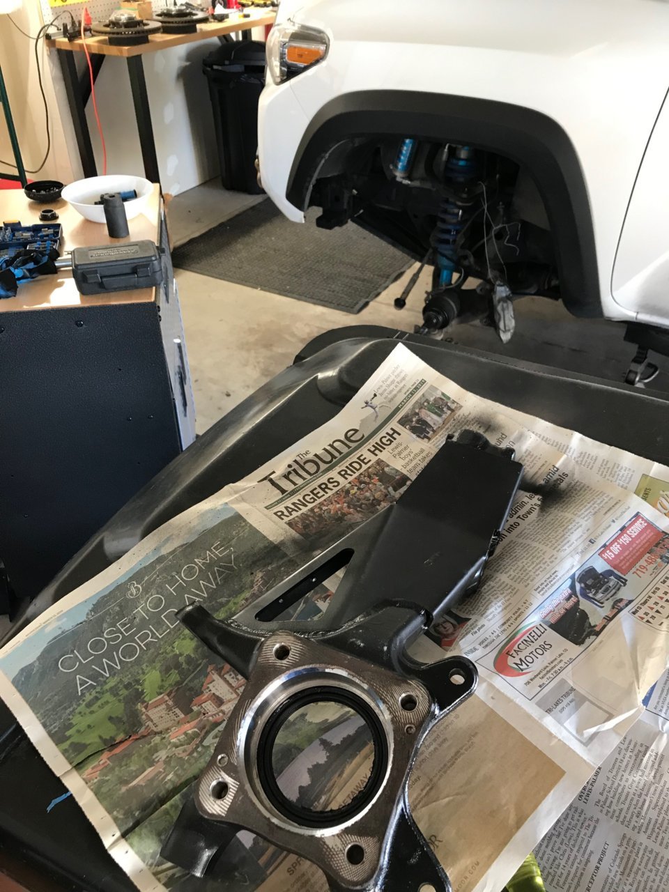

    It helps having a clean workspace, though I'm a bit OCD.
    Weld completed and finished painting. The prep work to paint the spindle wasn't bad but it takes time, you do not want to paint any of the threads or the machined metal. The machined metal is super shiney so you need to make sure no paint touches it.
    Finally Reinstalled
    I hope this advanced section helps you in your progress with fitting 35s and prepping your truck to handle them without issue.
