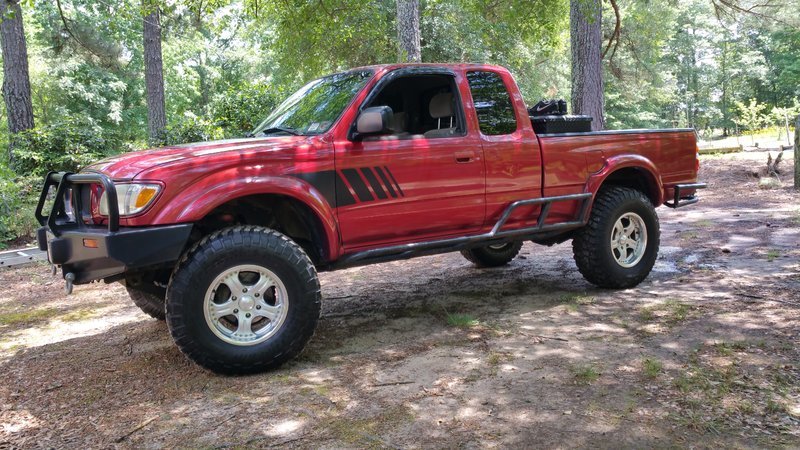

    WATaco
    WATaco Well-Known Member
    Jan 26, 2015
    #147290
    336
    Ed
    Seattle-ish, WA
    '14 Tacoma ORD
    Leer, AllPro sliders, Prinsu, OME, JBA UCA
    Beautiful truck!
    JimBeam[QUOTED] likes this.
  14. May 19, 2016 at 6:47 PM
    CedarPark
    CedarPark Master of Destroying CVs
    Aug 17, 2014
    #136361
    11,985
    Dylan
    Cedar Park, TX
    '04 TRD V6 Taco, '11 2WD 5.7 Tundy
    Lights & Lockers & Duals
    No drooling emoji? Thanks, TW. That's a sharp lookin' truck.
    Same, even before reading this. Oh well. Got a buyer lined up for my old ones and have a discount tire quote ready to go. Live and learn I suppose.
    I doubt that'll ever happen if I rubbed with 265s haha. I read a shit ton before purchasing and everywhere said 4.5". Oh well. Just gotta get that bank account up then I can play too.
    Anyway, sorry for thread jacking OP.
