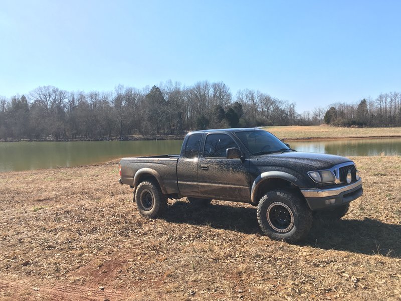

    I have this same exact set-up here are some pics 285/75, 3in lift, 2nd Gen trd wheels, 1.5"spacers.

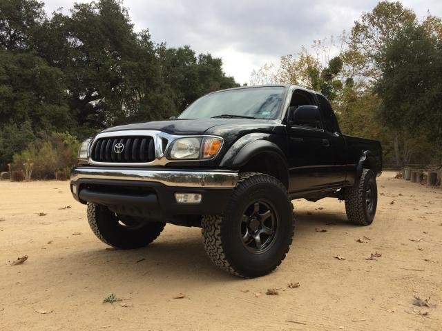

    I'm running 285s with Icons set to 2" up front and 1" progressive AAL in the rear. Did the pinch weld mod like everyone else, but I do get a little frame rub at full steering lock. 285s will fit on a stock rear end too... I ran them for about a week before I installed my rear lift.
    Obligatory show off pic. :D
