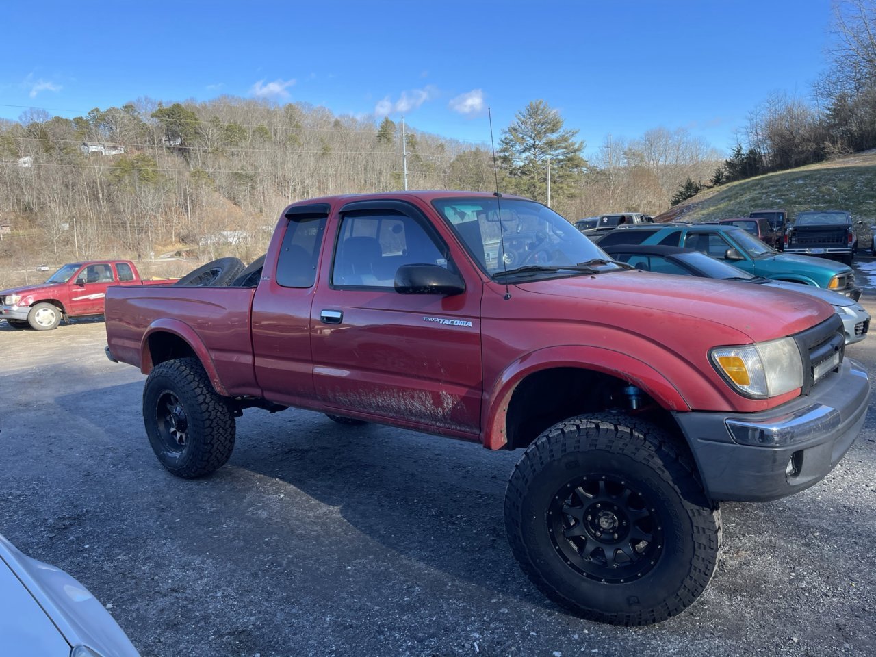

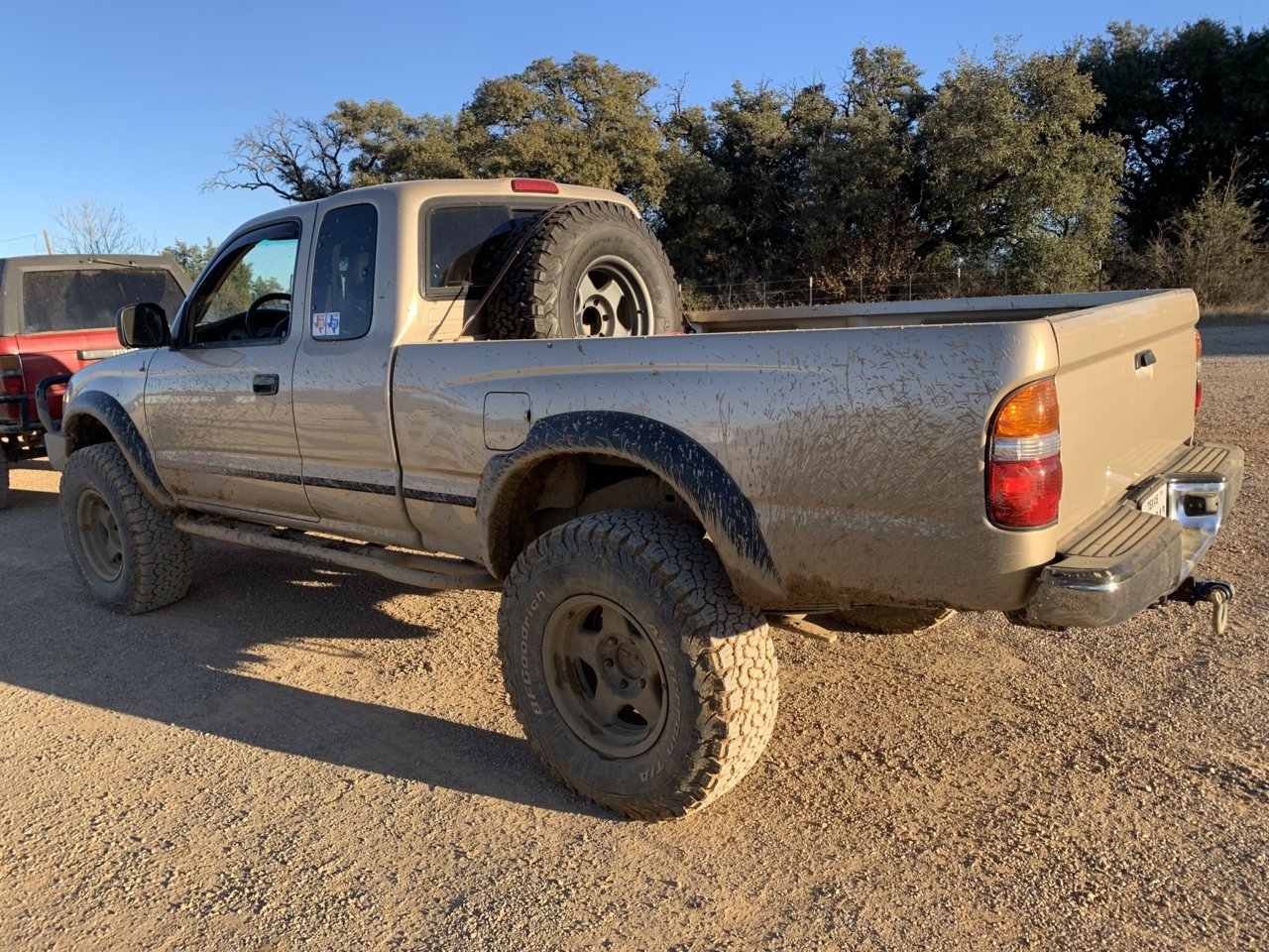

    D8338ABC-C27A-4C0B-B1B3-D03B93007DE6.jpg I’m running 285/75 General AT’s, Kings with JBA UCA’s with Raceline 16x8 wheels W/4.5” BS and not a rub yet but going to get into rougher stuff over the weekend to see if any trimming needs to be done, so far couldn’t be happier though.

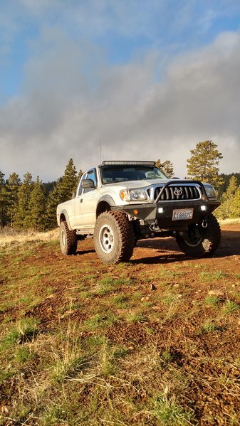

    Here’s mine, first time out with them and the new wheels and got some rock rash on one of the last hills I climbed :/

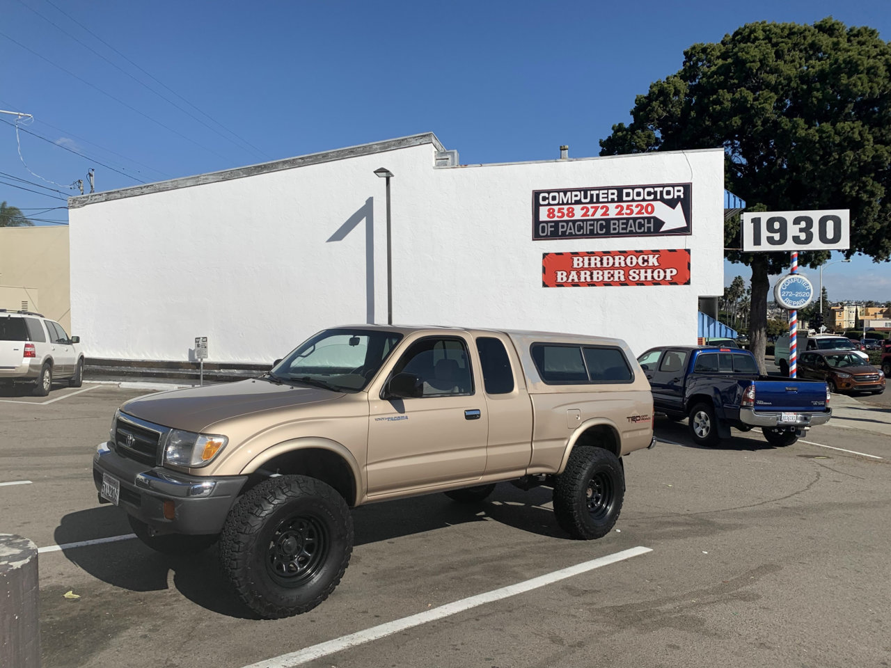

    882 5100 3 Leaf AAL 285/75r16 - Ko2
    Im running 286/75/16 with OME 882 and All-pro standards. I barely had to trim my fender liners, and filed the pinch weld a tiny bit for good measure, but it never rubbed too badly. It's definitely slower on acceleration, but thats the life we live haha. TRD supercharger would be a game changer though ;)
