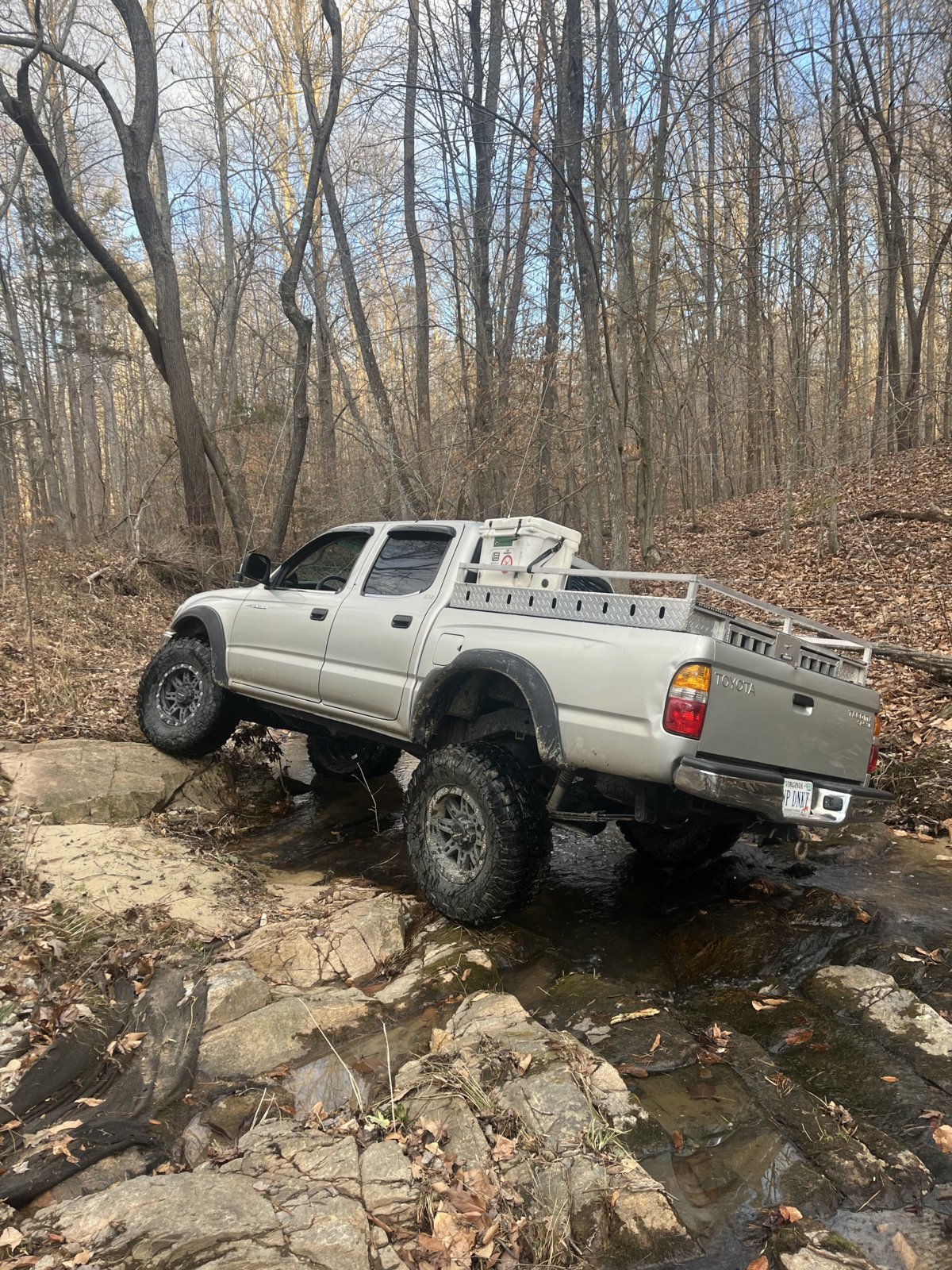

  7. Jan 22, 2024 at 1:57 PM
    #107
    Swampdonkey02
    Swampdonkey02 New Member
    Jan 13, 2024
    #441537
    3
    Zack
    2002 Toyota Tacoma double cab sr5
    Bilstein 5100s with ome 881 coils on middle setting up front, 5100s in rear with Ome adjustable shackles. 285 Goodyear boulders on 16 inch procomp wheels
    IMG_3039.jpg 285 75 18 on 16x8 pro comps. Wheels are a very positive offset not sure exact
    881s on 5100s set on the second notch from bottom (rides really stiff Offroad)
    Longer shackleout back with 5100s
