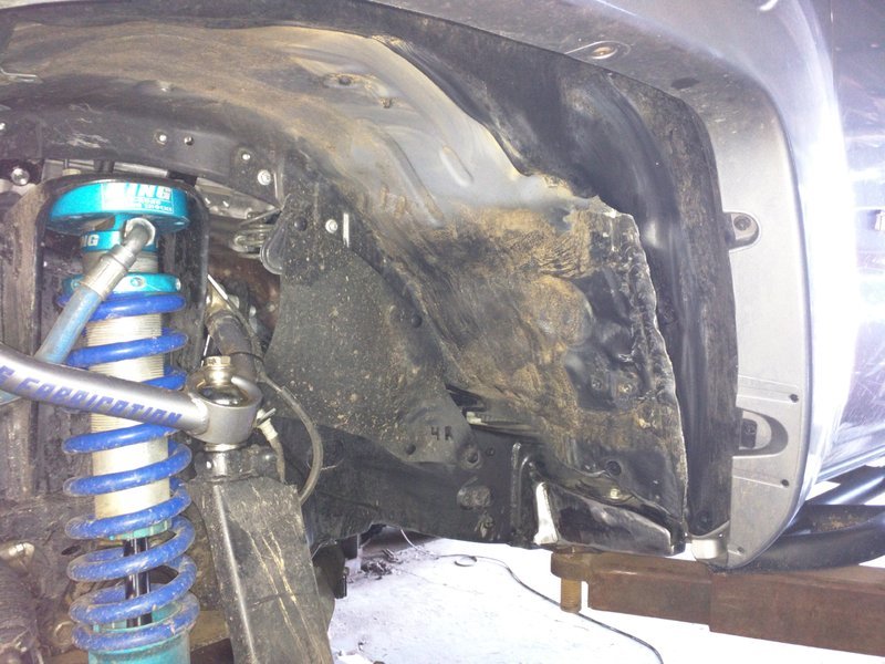

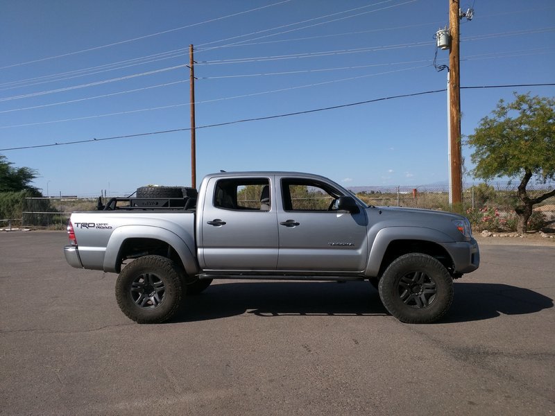

    CMC, pinch weld and a little bit of plastic to fit them.

    how rt you are! i helped TACOfms clearance for his and you can't get away with the normal partial chop on the cmc either we cut the face off the cab mount all the way to the frame and cut the end all the way back to the access opening underneith. i fabbed the plates and welded everything back completely boxing it back in. pinch weld, fender liners, everything had to be clearenced

    Stuffs nicely with my setup :thumbsup:

    So how much lift do you currently have up front? Truck looks good man. Thanks for posting so we could see it.
