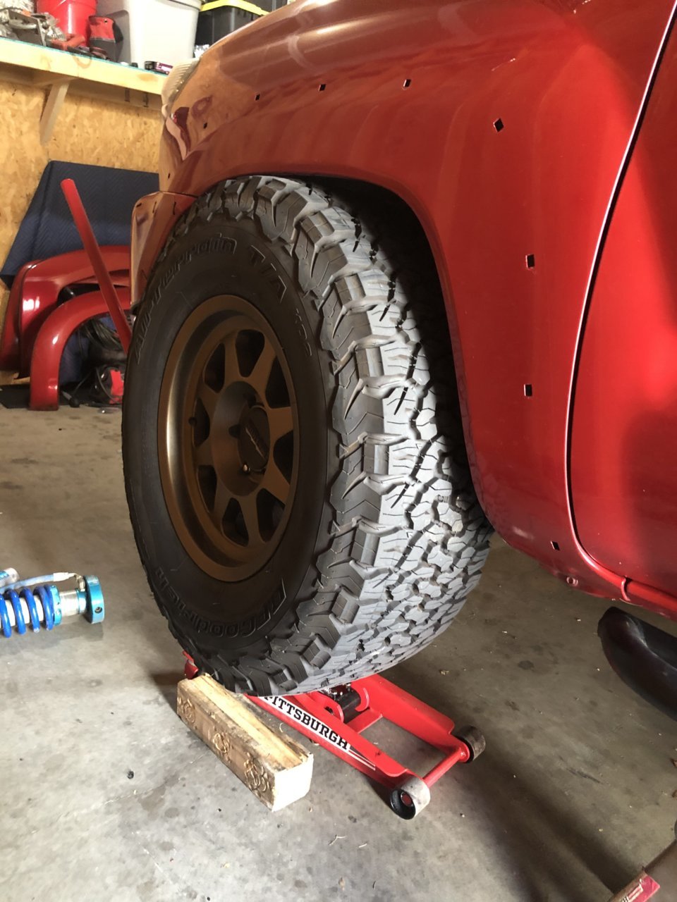

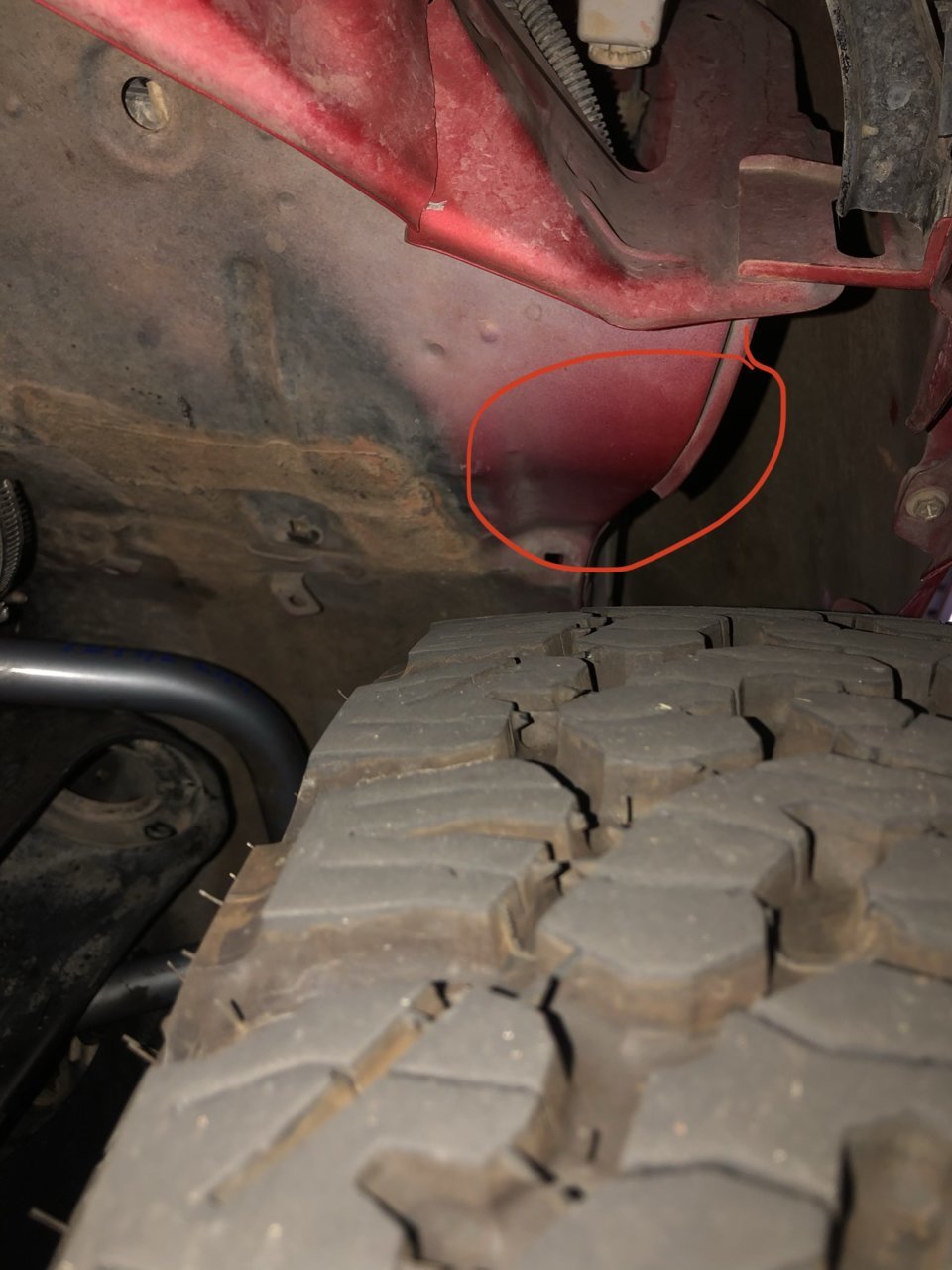

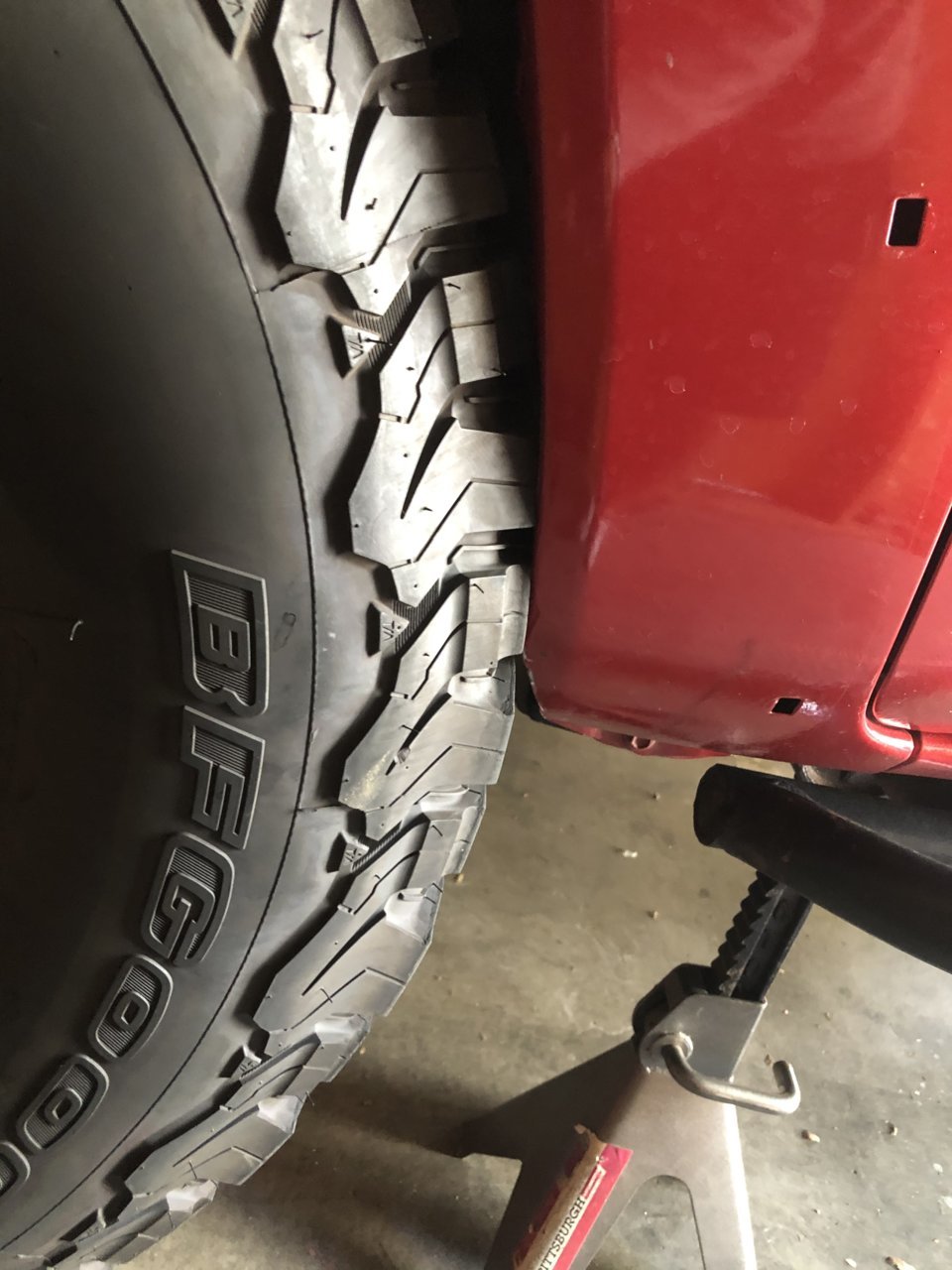

    285/75/17 methods 0 offset with 1.25 spacer. Here are the contact spots for me also have the CMC done and pinch weld bashed flat
    I also have the flares removed and wheelers super bumps, it would definitely rub more if I had the flares on still
