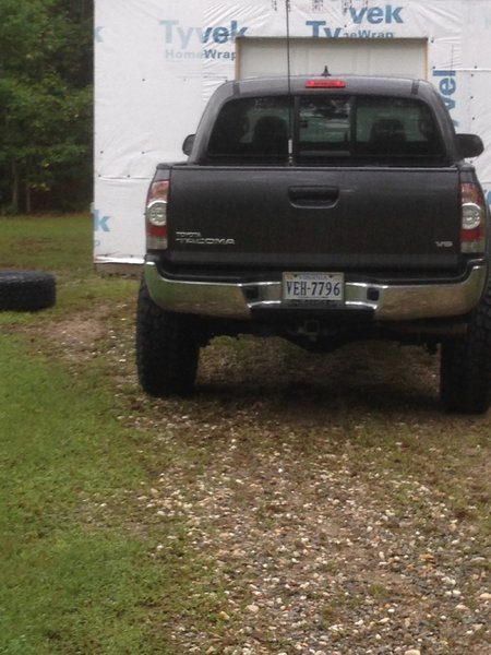

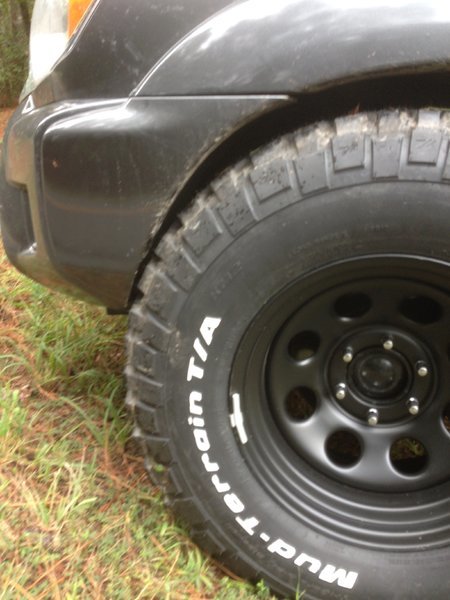

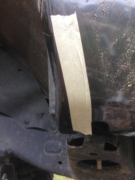

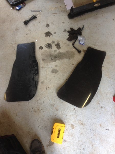

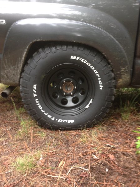

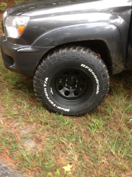

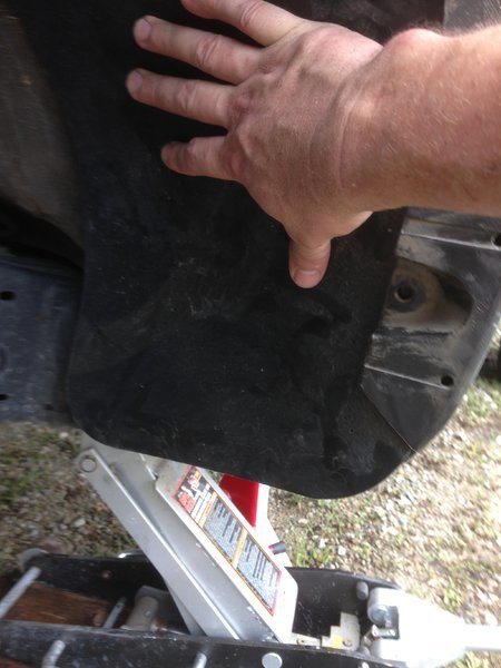

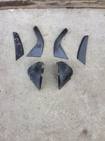

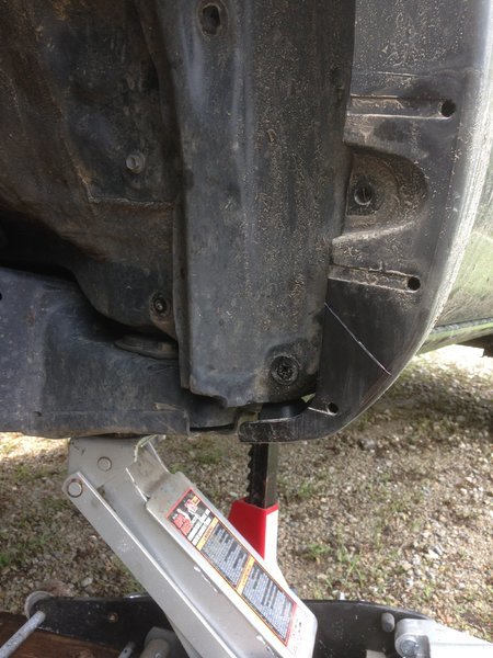

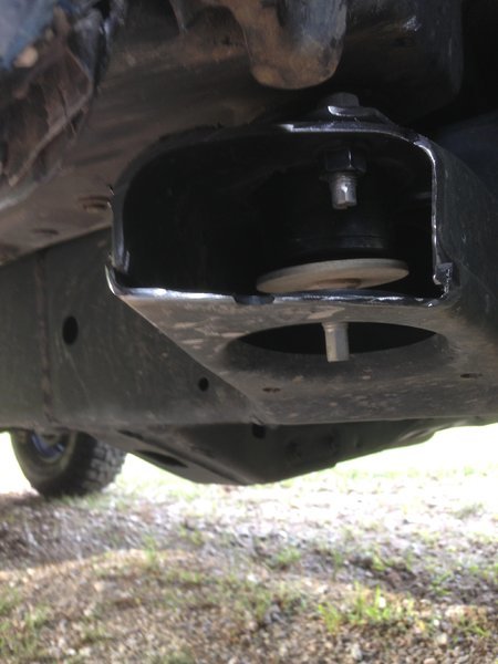

    I'm sure I had to trim more because of the spacers. Trimmed until I could turn lock to lock today. Welding up the cab mount that I cut tomorrow. Beat the pinch weld back flat and cut some off of the flare, front bumper and fender liner. I have some fender liner from a Super Duty that I'm going to cover up everthing with. Drove for about an hour today with no rubbing. I have not flexed out yet.

    Yeah I heard the rubbing backing out the driveway and chopped some more past what the first pic shows. Took another angle at it so now two plates will get'r done. Once you hear and smell the cutoff wheel your commited haha. I plan to do some flexing tomorrow and cut what's needed to get the travel I want. When it's all done I will put the inner fender plastics on to keep the muck out of the crevices.
    I was going to cut a sheet of polybutylene I had for the inner fender and I found that my dad had four of these liners that he had gotten for his Super Duty a while back and never used (sold that truck and got a Dodge 2500).

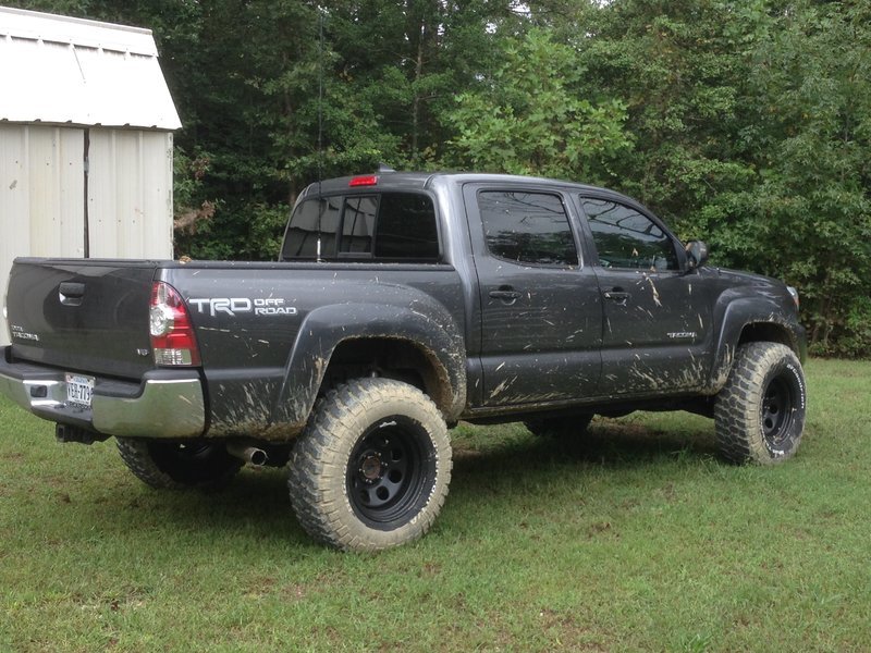

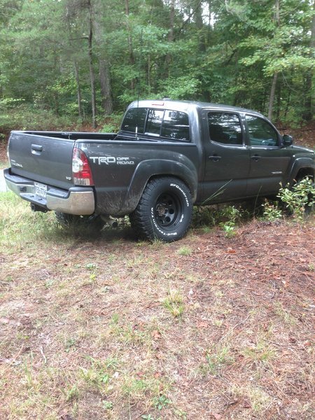

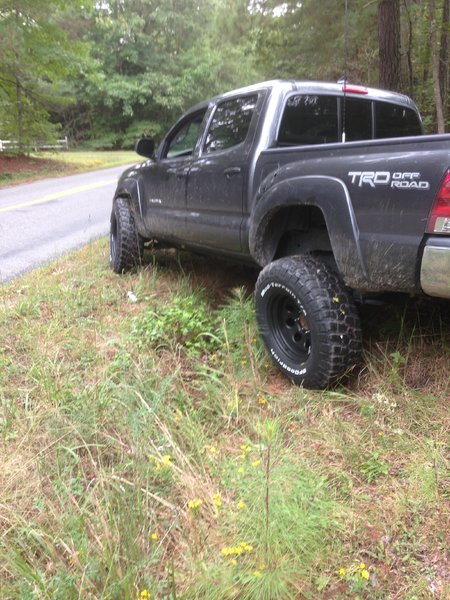

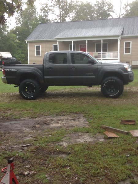

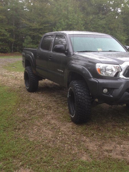

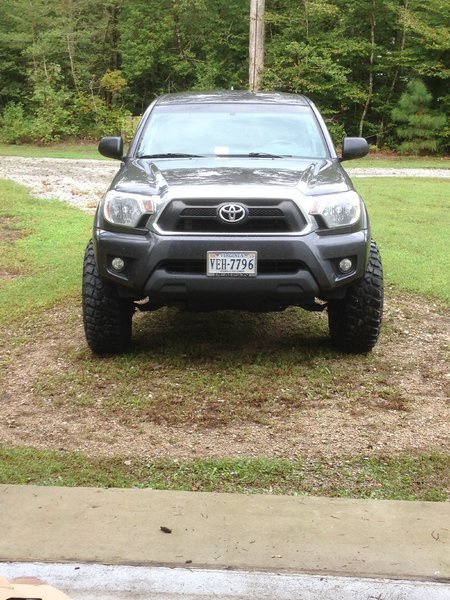

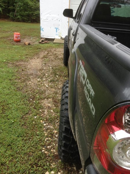

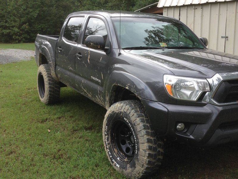

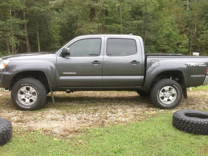

    Hopefully this helps some folks interested in this tire size. I suppose going to a 35" tire only gets you 1/2" more ground clearance. To me these are plenty big enough for a little Tacoma. I got lazy today I suppose and didn't weld the cab mounts. I did do a little bit of light wheeling/flexing and mudding (if you can call one sloppy mudhole on a logging road mudding). Oh there is more to trim for sure but you have to flex pretty hard to make the rear tires hit the flare and the front is 85% where I want it. I bet if I took off the swaybar that I would really mash some plastic up front. I didnt see of the front was on the bump stop but if folks with 35's are trimming 2"+ off of the flares and these are only 1/2" back from that...........But like others have said, wheels spacers, wheel width and backspacing play a role in how much you have to trim.
    Mine are 17x9 4.25BS and 1.25inch spacer up front, no spacer in the rear.
    Front is 5100's set at 2 1/2"
    I have the Deaver AAL pack and a 2 degree shim out back = about 2 1/2" lift in the rear
    A RR Stuff Whole Truck.jpg A RR Stuff Close up.jpg A LR Droop.jpg A LF Stuff.jpg A LF Stuff Close up.jpg A Front Passenger Mud.jpg A Rear Passenger Mud.jpg A Front Driver Mud.jpg

    To be honest, I would trim your cab mount as far back as possible. You might have to actually cut into the "circle" opening a little, and then plate it back in. With that bs you are pretty much clearancing like you would for 35's.
