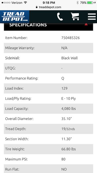

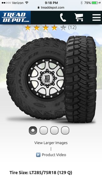

    There's a few 285/75r18 tires floating around out there too. Which is a 35x11.5!

  4. Oct 3, 2016 at 6:20 PM
    #124
    WendyTaco
    WendyTaco [OP] Well-Known Member
    Jun 29, 2016
    #190813
    370
    Kyler
    2017 TRD Off-Road

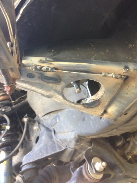

    So, most people with oversized tires dont pay to close attention to mpg, but I got 16.9mpg. That's with the 10.5% size difference added to the odometer reading / gals. That's mixed driving, half highway and around town, some idling with the AC on and yep I punched it a few times too. Before with my 265/70r16 I got 18.5-21mpg. I'm happy with a 1.5 mpg hit.
    Did more flexing and trimming on the cab side of the front flares and on the inner fender up front by the bumper. Might have to bash the firewall/metal inner fender in some too but I haven't yet. A lot of electronics behind there so I will be careful as possible.
    For the back I have not done any trimming and under hard on the bump stop stuff it contacts pretty much the entire way around. I need to read more about those who have extended their bump stop out back. Possibly that with the combination of U bolt flip.
    Almost there. It kind of therapeutic chopping on the truck after work.

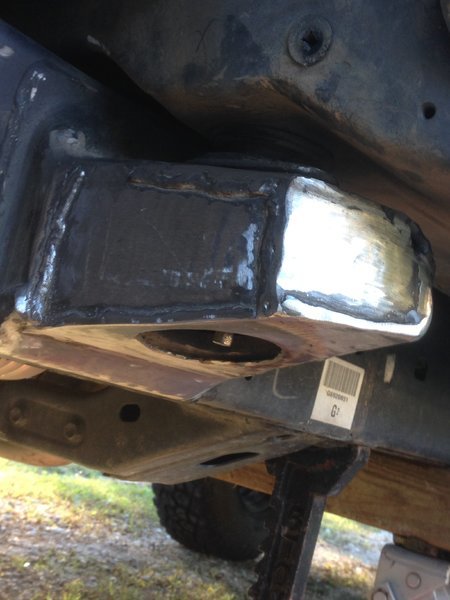

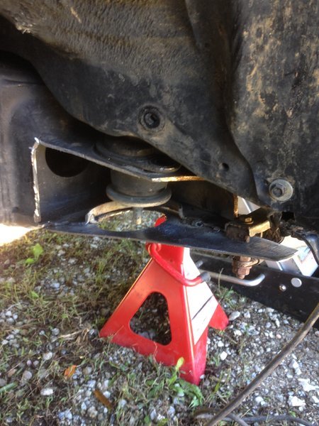

    Here is my cab mount butchery needed to clear these tires. It doesn't look so bad with paint on it......

    Grind down the welds to clean it up and no one will know.
    Good job

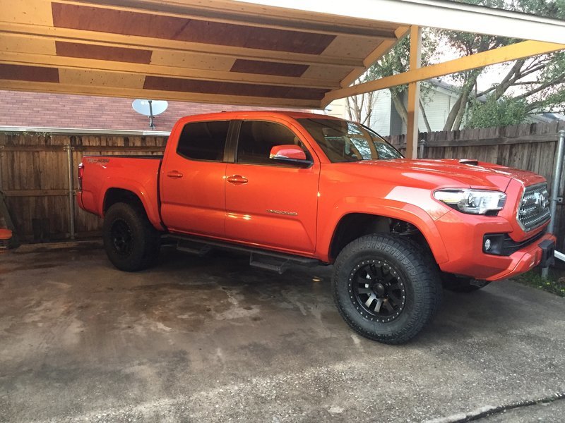

    Does fine for me , on hwy I'm cruzing around 1500 to 1800 Rpms 80 mph IMG_5420.jpg
