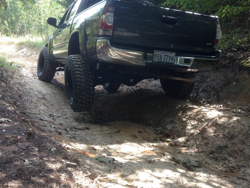

  9. May 7, 2017 at 3:45 PM
    #149
    CharlesCity
    CharlesCity Self Preservation? What's that mean?
    Jul 3, 2016
    #191134
    159
    VA
    2015 DC Off Road
    I had to bend that pinch weld over and also clearance a small amount of the metal fender behind the flare. As others tried to tell me, the wheel offset, width and not using a spacer makes a huge difference in what you have to cut out of the way. I first had pro comp 17x9 wheels and a 1.25" spacer (to clear the calipers up front) and like they said the scrub radius is increased and you have to trim more. Now with the 17x8 SEMA wheels (ebay) I don't need the spacer and don't rub up front. the back will lightly rub the fender flare if I flex it hard like crossing a deep ditch diagonally. Also, like other have said these are a lot of tire for 3.73 gears. I wish I had the cash flow right now to do the 4.56"s but I just use 4th instead of 5th until I get on the interstate. I was doing in the neighborhood of 85mph today at a casual 2500rpm with the stock gearing.

  11. May 7, 2017 at 5:36 PM
    #151
    CharlesCity
    Jul 3, 2016
    #191134
    159
    VA
    2015 DC Off Road
