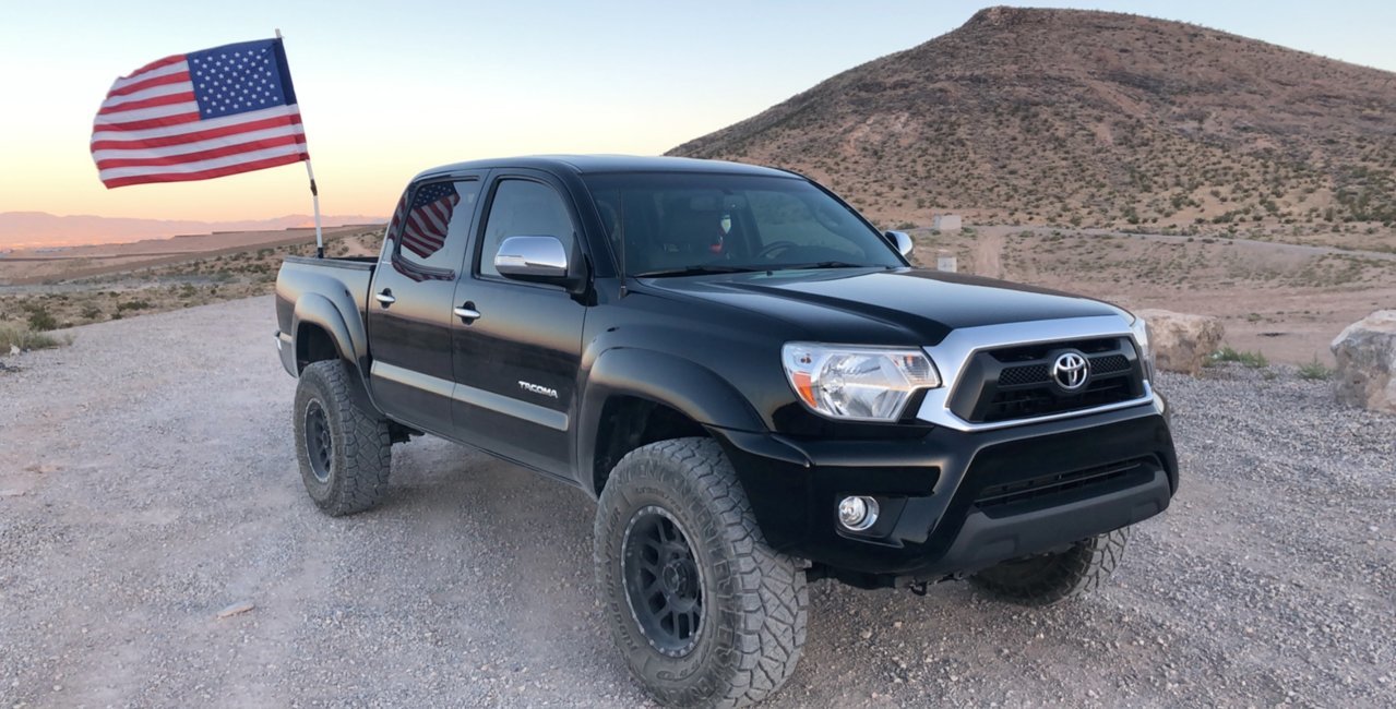

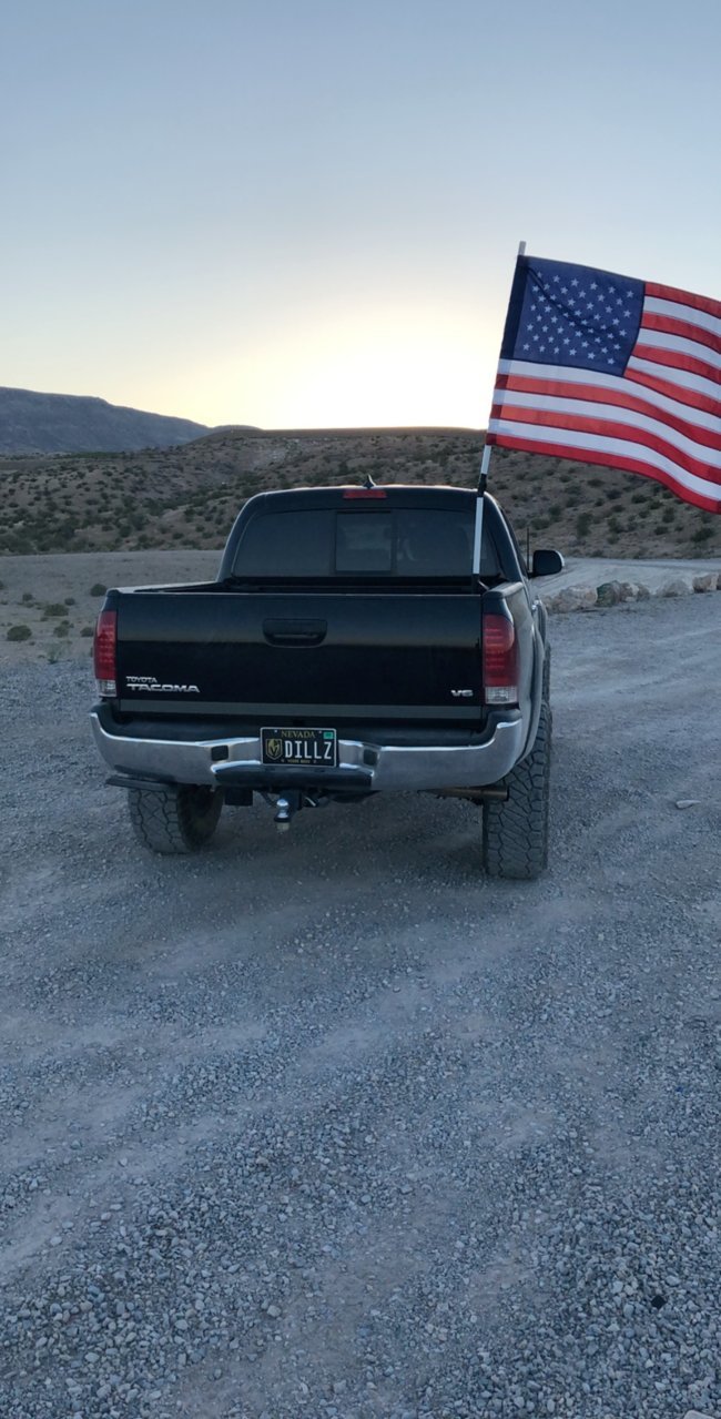

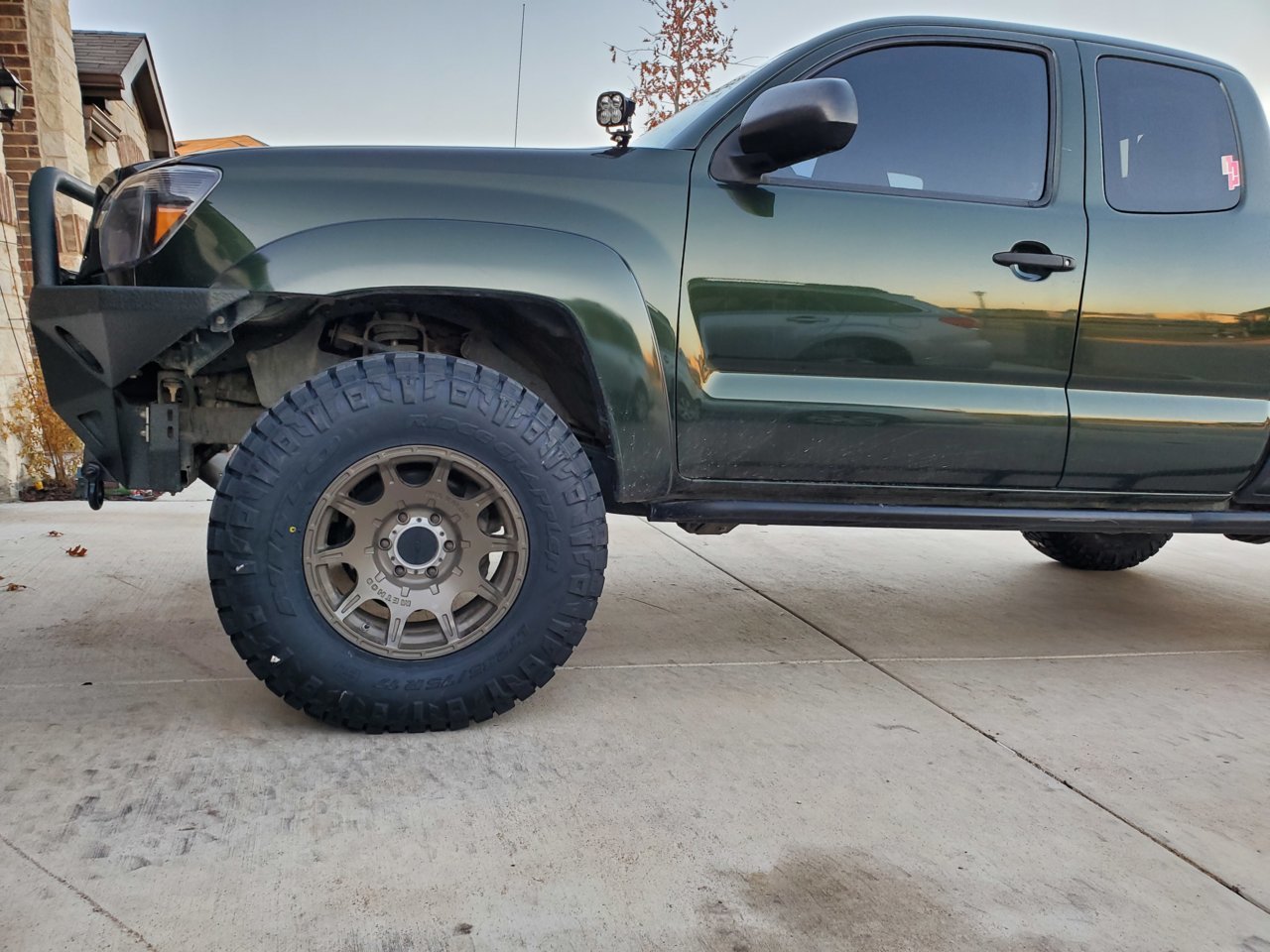

    This thread helped me choose whether to go 285/75r17 or 285/70r17. I've made the right decision to go with 285/75r17! It looks so good with my methods and just overall looks better with the meatier sidewalls :D. Upon on doing lots of research just like what CharlesCity had to do, I had to do somewhat of a big CMC and LOTS, LOTS, of trimming. Otherwise, my truck doesn't rub and only rubs on hard flexing. But with these big wheels did cost me some as it did pop out my front flares out but new clips will fix it! Here are some pics of true 285/75r17 and not 285/75r16 nor 285/70r17 not everyone posts in this thread. If you guys have any more questions or need more pictures, feel free to ask :).
    To run this setup I have a ToyTec 3in Bilstein 5100 w/ AAL, CMC, and Tons of trimming on the inner fender lining and fenders

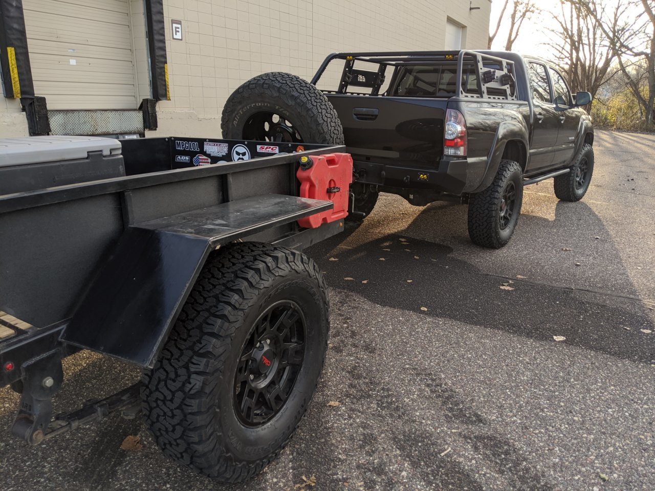

    Ordered the KO2 285/75R17's. Should be here in about a week.
    Last week did the cmc and trimmed a good chunk off of the lower part of the fender. Heat-gunned the fender liners back. I'm guessing I'll be good to go, but we'll see once they're mounted.
    I've been running the KO2 34X10.5/17 tires with zero rubbing issues, and these tires won't be that much bigger.

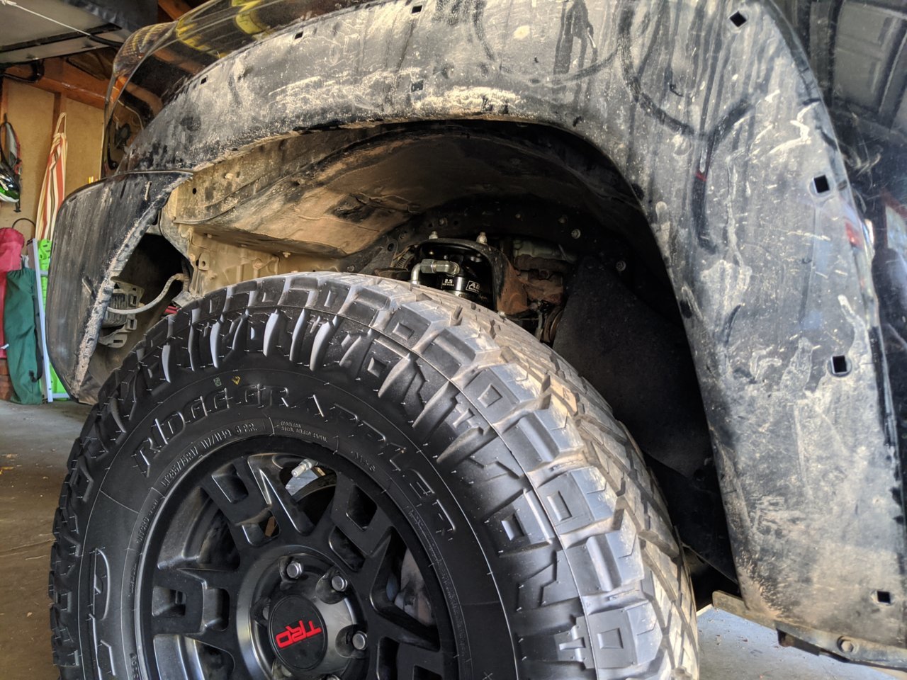

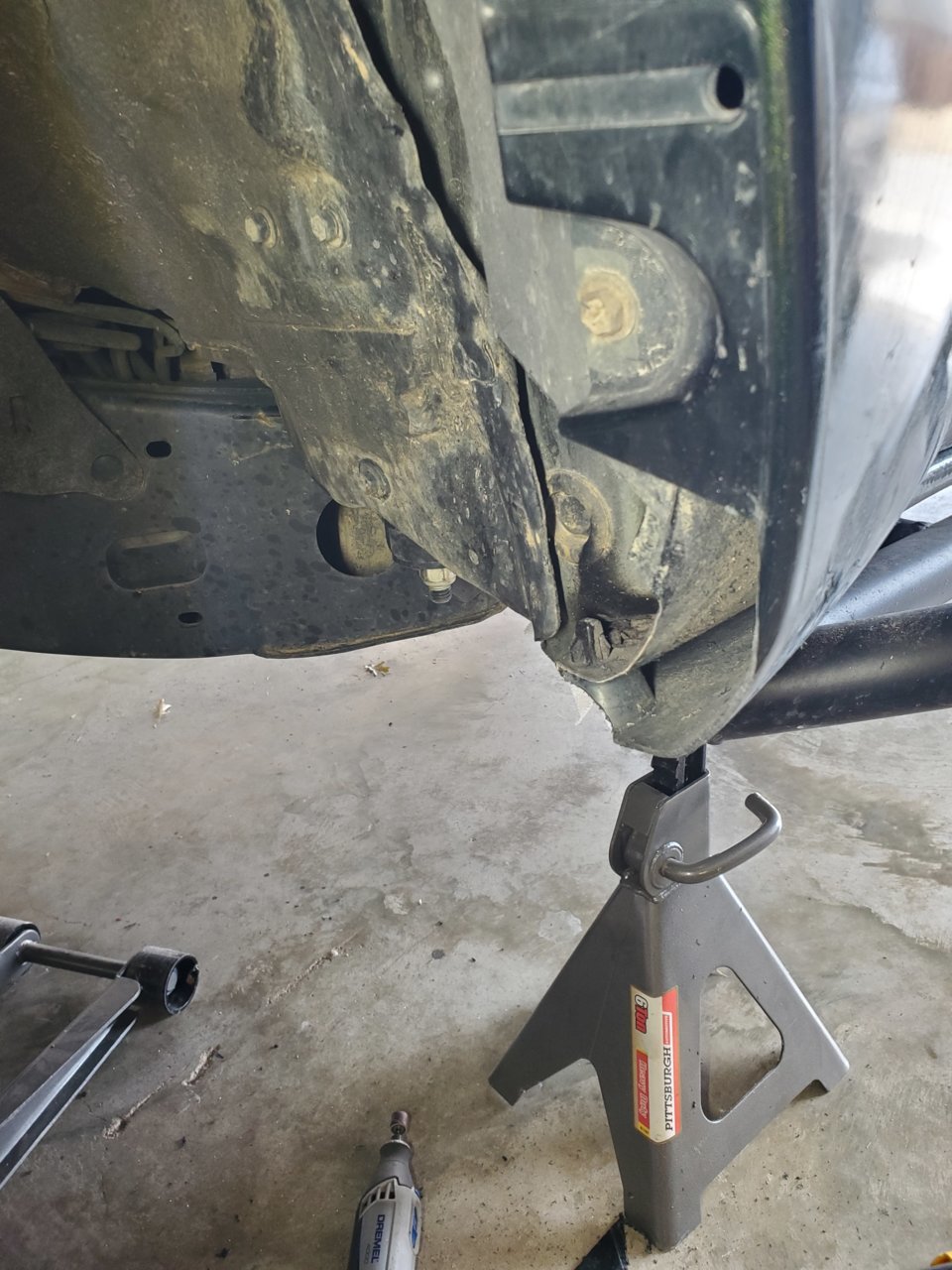

    Just mounted my ridge grapplers this last weekend (285/75R17). I have bilstein 6112 up front set one notch below max (Fox 2.5 adjustabls in transit!). I rub in reverse on the driver side but will do some more trimming this weekend. I did the pinch weld, cab mount relocation, inner fender liners chopped and some plastic trimming. The main culprit was the bottom bolt holding the sliver of inner fender liner I had left so those ar going as well. I have SPC UCAs and they were set at either 4.0 or 4.1 caster (can't remember which) I'll update you guys this weekend on what else I trimmed to get full stuff.20190813_185943.jpg 20191130_171141.jpg

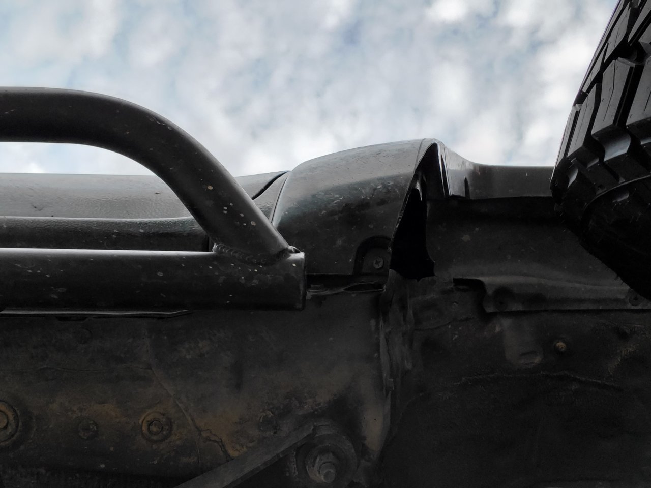

    Had time to trim up today. The image in the above post looking up is a 285/70R17 and the same view in this post is the current one with the 285/75R17. I went in to the fender to make sure I dont need to do this again. No rubbing on anything, still need to flex it more but I'll do that this weekend. I think it turned out pretty good.20191204_190723.jpg 20191204_123356.jpg

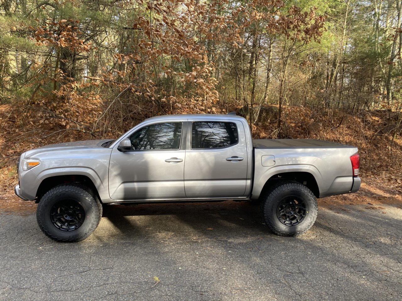

    Just bought 285/75/17 wildpeaks... i have a 3rd gen, ill report back when everything is installed.
