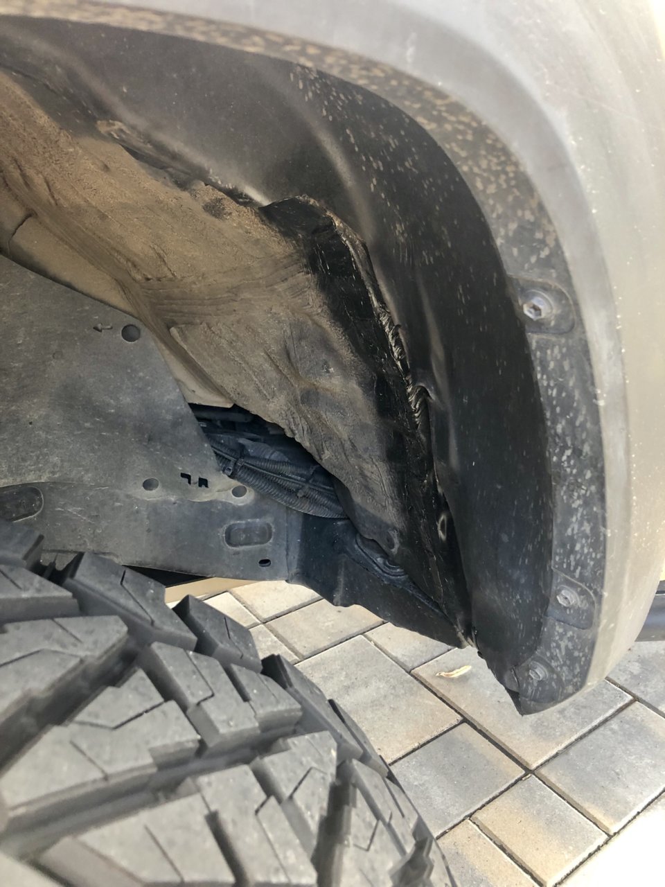

    I thought I’d post up a pic of the CMC, pinch weld, and heat gun molding that was done.

    My second gen rubbed with 285s not much but it rubbed.. my 3rd gen it seems the wheel wells are a bit larger.. aftermarket UCAS end up shifting the spindle further back towards the firewall/cab-mount.

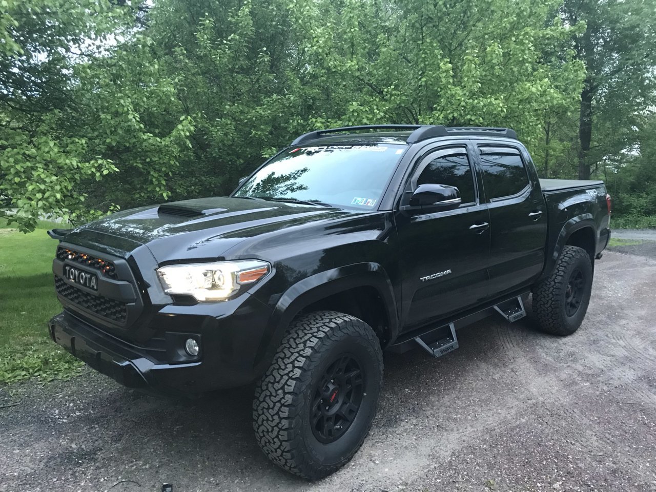

    5BD7E6F5-7940-467B-87BE-DEB0A4709513.jpg 1C88D7B3-C28D-4856-862D-7790B2DDF085.jpg 03BA907A-4CC1-4BD7-8550-F6A999882314.jpg C1DFDD68-6FE7-4F9F-983A-3E433E24660A.jpg

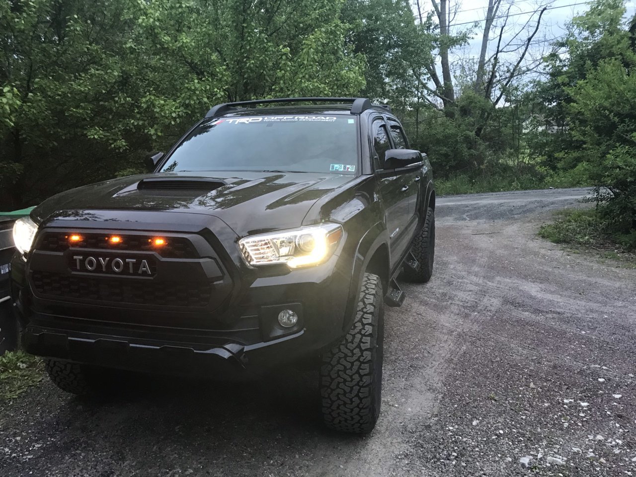

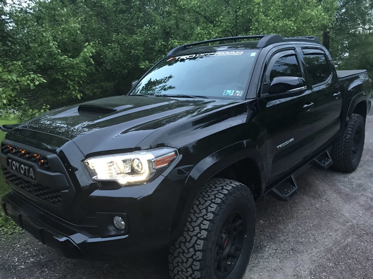

    285/75-17
    Just finished adding my wheels and lift.
    TRD Pro 17" Wheels 4mm Offset.
    3" Rough Country lift with ball joint UCAS. (Not direct).
    OEM Roof Rack with crossbar that pivot to side bars for no highway noise.

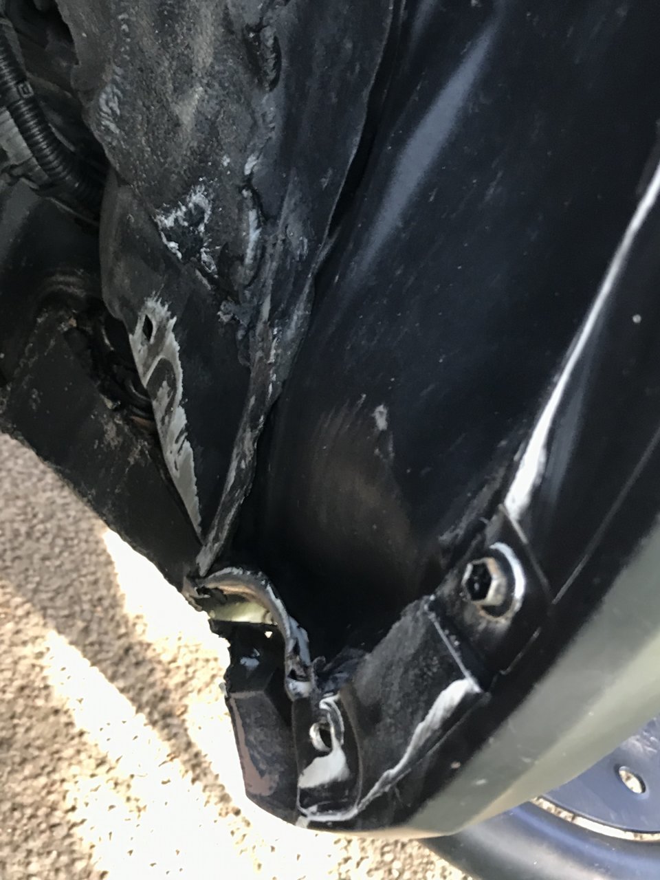

    I must add doing an alignment and moving caster and adjusting the eccentric to move wheels back is a MUST. Anyone that doesn't do this is asking for trouble.
    Cab mount chop was a necessity and remold fender wells.
