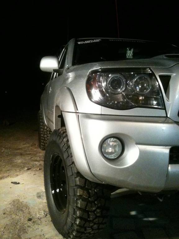

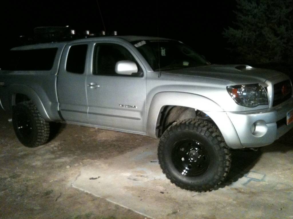

    I have a 2.5 level up front and with a bit of plastic chopping and mud flap removal I was able to stuff 285/75s under there... on wheels with 3.75 BS no less. So from everything I've seen and read on here, it's just a matter of trying to fit them and see what you gotta do to make it work. but so far for me, no cab mount chop.
    [​IMG] (stocks were 265/70/17)
