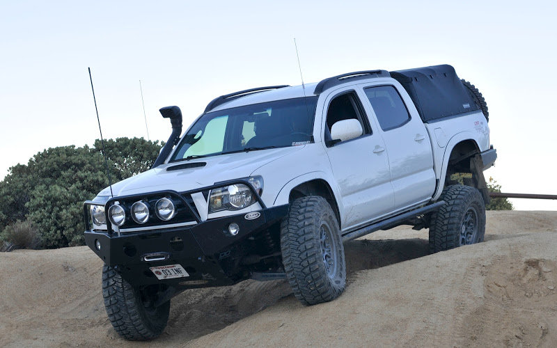

    2009 4x4 trd sport
    Total Chaos 3.5 Long travel, Defined SUA
    :jerkoff: i love this truck :drool:

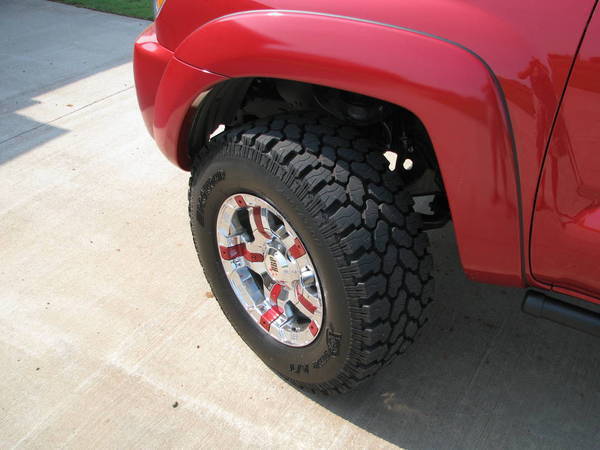

    11 PreRunner SR5
    I'm running a 3” Procomp lift, 17x9 RBP 93R wheels with a 4.5” backspace, and 305/65/17 Procomp Xtreme AT tires. Very little trimming. Still rubs a little in reverse in full lock.

    Thats a sweet shot. 305's are the answer according to the 10 billion measurements I made. I forgot who put 255, I'm already running 265 with plenty of clearance. Enough that the tire looks to small, that's the reason for the larger size. I could run 265 on stock suspension. Anyway, thanks for all your suggestions, but 305 and looks like I'll jave to do a couple of minor trims to the front well.
