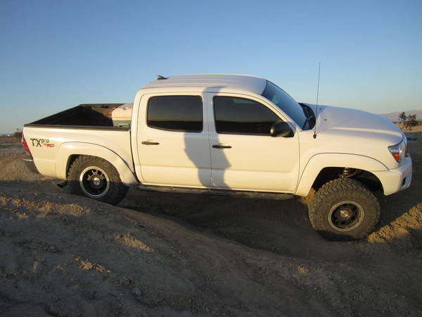

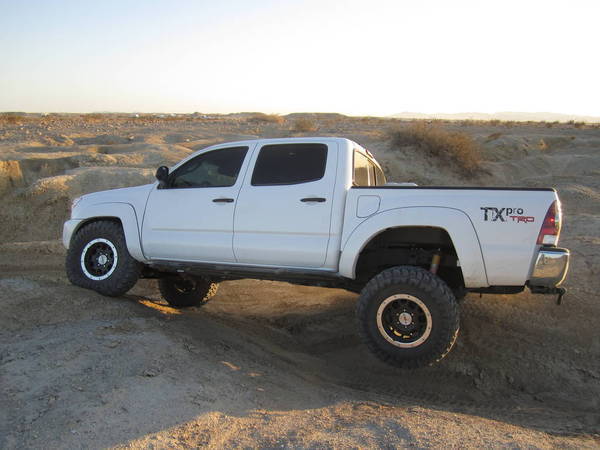

    I have hacked everything out of the front of mine and even went with a little larger fender cuz the top of the wheel well was getting hammered. I even had to massage the fender flare in the rear. Like above posters said, wheel you shit.....you'll need to trim. Here are a couple old pics from before I did enuf hacking.
    You can see here the rear flare buckling
    Shot form the other side, pretty obvious something is getting chewed up.
