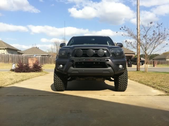

    I'm just running Bilstein 5100s set at 1.75 and a 1.5 AAL in the rear. I'm planning on getting OME coils, I'm just trying to decide between 884s and 885s.
    If you have the little front flaps you may have to take them off. I ended up having to take mine off when I got my wheels and tires. I pulled my other flaps off as soon as I got my truck home from the dealer.

    I like the ride. It's a little stiffer than stock, but not in a bad way. Less body roll and nosedive when braking, but not harsh on bumps. I don't think I would run them at 2.5, the ride would be way too stiff.
    If I knew that I could get away without new UCAs I'd order the 885s today. I'm still trying to decide if $550-$600 (if I ended up needing UCAs) is worth gaining an extra 3/4 of an inch of lift.
