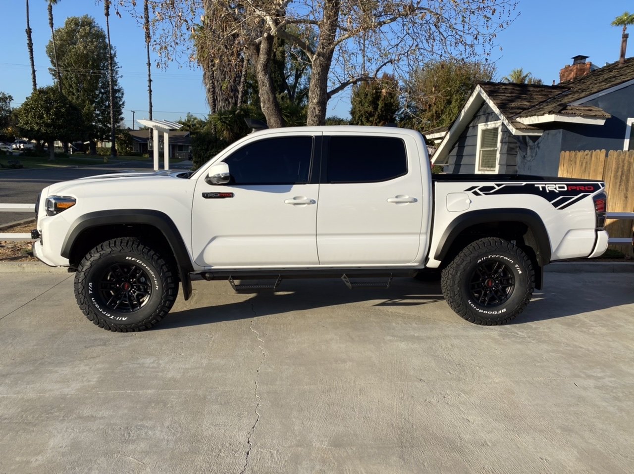

    I made the mistake of being talked into 295/75/16 on my 2020 TRD Pro with 1/2” spacers up front and 1” add a leaf in rear. BIG mistake on the 295’s, extra weight and just that little extra over the 285’s made me trade them in and take a $600 hit to replace them! Now running 285/75/16 which is what I wanted in the beginning. It was worth it, MUCH better, no rubbing even in reverse and better acceleration while at 85mph fwy speeds!D6F0E5ED-9433-4777-B5B9-E96E1B41F385.jpg

    Yeah, width adds a ton of weight to tires (1" wider adds way more weight than 1" taller). Not surprised to hear it's noticeable.

    I have a Raptor with Nitto 35x12.5x22’s and they are noticeably too heavy on that truck, but they look great. Now my F250 diesel has 35’s and I can’t tell at all, LOL. The new 16” rims on the 2020 Tacoma Pro are over 4 lbs lighter EACH on the new 2020’s so I didn’t want to change them out for the 17” 4-Runner Pro rims that I love. The extra lbs for that little 3.5L are noticeable.

    Ya man, auto. I hated to go smaller but the 295’s just looked a little out of wack too. The white lettering helped with that big sidewall area with the 16” s but the 285’s are perfect now. When we stacked them up next to each other they looked the same really, but I had to remove the mud flaps with the 295’s and they still hit in reverse and going up little bumps. It was terrible. The 285’s allowed me to put the mud flaps back on too! Lol53BBA384-95ED-4F96-AFA6-FEDF2691147B.jpg

    Even with a re-gear, you can never truly make up on the road for bigger sized tires once you hit that size in a small truck. It's either all or nothing at a certain point, which is why it is always cool to see people work their way up in sizes instead of seeing this happen. At least you found the bright side of it though!!
