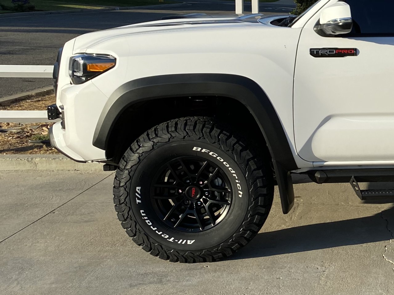

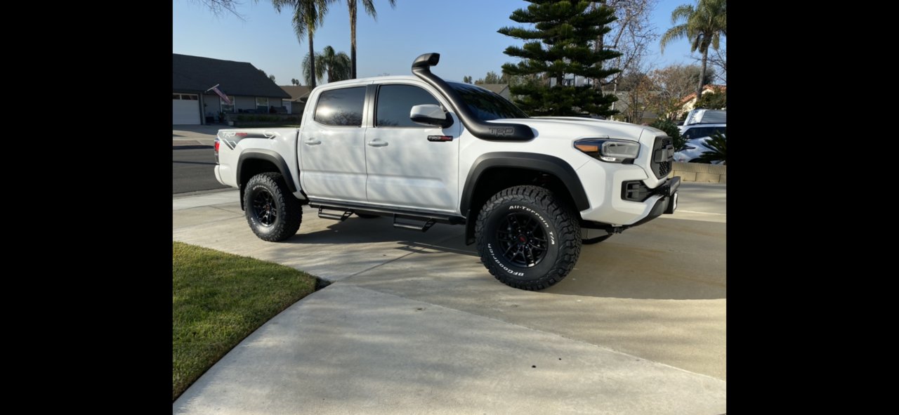

    I posted a bunch of stuff on this topic and photos that I guess guys all have bad opinions on. Got BASHED for many of my opinions, but here you go...... so I went from stock 265's to 295's because they messed up and put the wrong size on my truck. I HATED the 295's and even with a 1/2" spacer up front and 1" add a leaf in rear, it was just not working out like I wanted. The extra weight was REALLY noticeable at fwy speeds. This 2020 TRD Pro has the new factory wheels that are 4.188 lbs lighter EACH rim from the stock 2019's so I really wanted to stay with the stock 16" (And they look good in my opinion) I lost A LOT of milage on the fwy with the 295's and I just dropped to 285's and I'm really happy. Below are some photos for you. The top one with no mud flap is the 295 that still hit when going in reverse. The one below that is the 285 that I was able to put the flaps back on, no rubbing. This is how the truck sits now and I'm pretty happy. Yes, you will lose some milage but it's worth it. I can tell you that running as hard as I do on the fwy, I gained 1mpg moving to 285's from the 295's. Going from my stock 265's to the 285's..... lets just say you will be paying for your look my friend...... is it worth it? That is up to you. Remember, opinions are like assholes, everyone has one and they all stink. Find one that you can tolerate and seems to be the best for what you are doing. IMG_3325.jpgIMG_3327.jpgIMG_4083.jpg

    Perfect thank you so much! I'm really contemplating on what I want to do haha. I love the look of the KO2s in 285/75/16 but really don't want my truck's 0-60 be like 20 seconds lol. I guess I'll just have to figure out what works best for me like you said. I've also been eyeing the KO2s in 275/70/16, but they are still a D grade tire so.. not sure haha.

    For whatever it's worth, I tried the 275 on there just to mount up and look at, na....... 285 is the way to go. There is something about the way the 275's looked that made it appear so much more narrow on the truck. When i had the 285 and 295 on there, one set on each side, the 285's were an easy choice to take the $600 trade in hit and go with those.... Don't stress on this D grade thing so many are putting their 2 cents in on. If you end up going 285's you will thank me later. My buddy just ordered the 2020 Pro rims and has the 285's ready to mount up when they arrive. He had the 17" 4-Runner Pro wheels on there like so many others have with 285's on there. I was going to go that route until Toyota did this new rim at 16" The rid is soooo different and better with the new 16" I can't explain it, you have to go drive it and see what I mean. It's such a stupid difference, I would've never known had I not been able to play around with these like I did AND have my buddy with his 4-runner rims installed on his 2019 Tacoma Pro. Post some picks if you do it, would love to see how it turns out for ya!

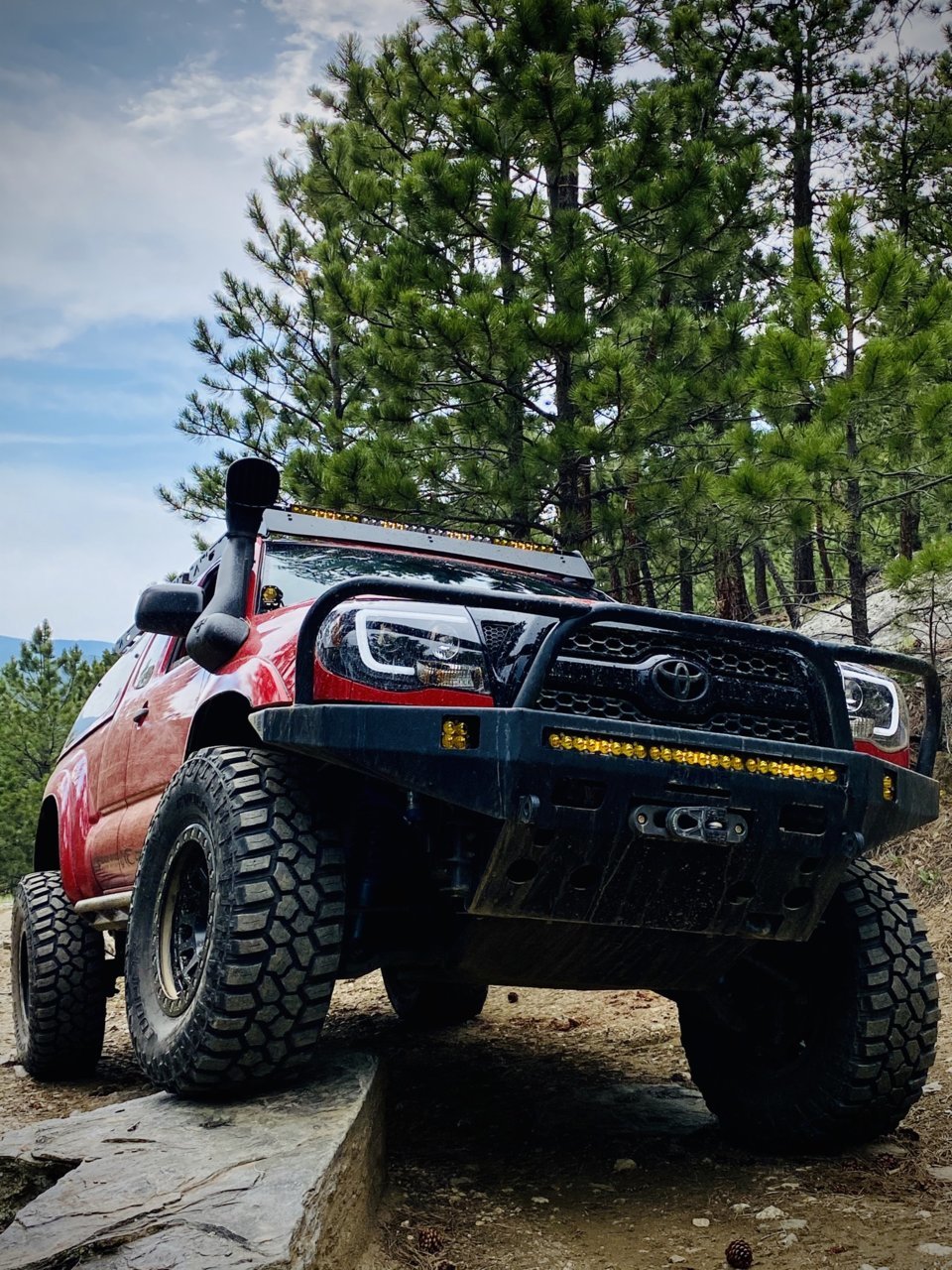

    you’ll need spacers for sure with stock wheels. The stock wheels are a little narrow but should mount. 17x9 -12. No spacers. I’m now running 35x12.5 with spacers
