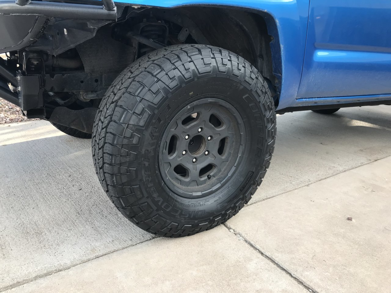

    I just had some 295/75/16 Cooper AT3 XLTs installed (33.4”) and they fit perfect!! I like the look much better than the 285/75/16! I only wish there we more tire options available!!
    I have a 2.5-3” lift and my cab mounts are chopped. My wheels have 4.5” backspacing. No rubbing issues at all but I have a off road front bumper too. I trimmed my inner fenders a while back with the 285s too. Hope this helps anyone looking to upsize a tad! But be warned...my MPGs dropped compared to my 285/75/16 KO2s! I’m re-gearing the truck next month with Nitro 4:56’s to get some power back.
    Cheers gents!
