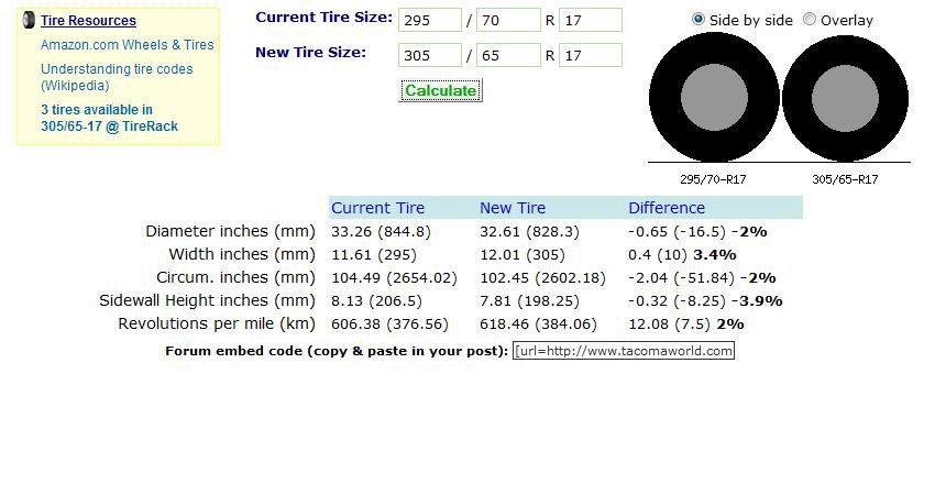

    I have 305/65/17 on my 3in lift and I only had to trim the plastic where the mud flap bumps out for the flare and the inner fender in front of the wheel, just so they don't rub when turning; but I wouldn't want to get the truck all twisted up offroad [the tires are too big for serious offroading] but haven't hit the bodymount yet

    Because his tire has a smaller diameter than a 295/70/17.
