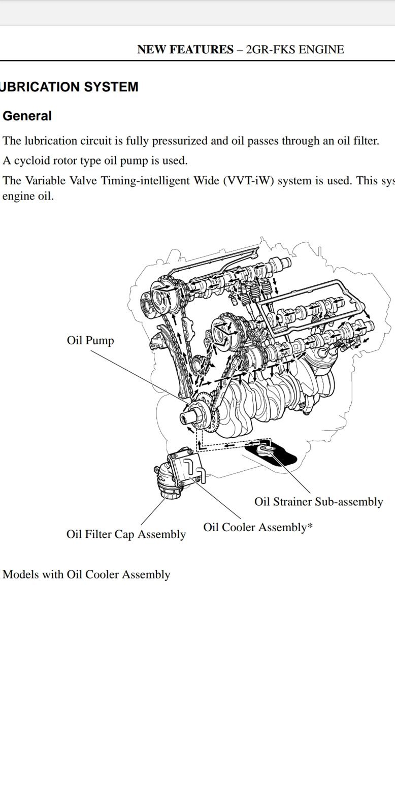

    Could you please elaborate on it? Maybe I'm missing something, but the pickup tube is at the rear end of the engine?

    Steep grades and leaned over off camber to the drivers side. If you start seeing smoke turn off the ignition.

    These not an oil starvation issue. May lead to it, but you will hydrolock the engine before. This issue is not exclusive to 2gr-fks.

    I agree it isn't an oil starvation issue (never said it was). That's how owners have been daylighting their blocks. PCV issue or oil drain design is most likely. The 2GR-FSE in my IS350 has almost 170k miles without any issues at all. Fun little commuter that checked all the boxes (comfortable, 300+hp, handling, 4 doors).
