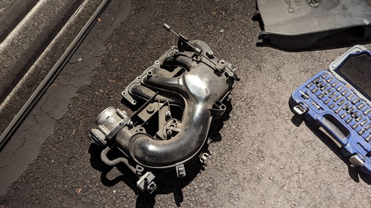

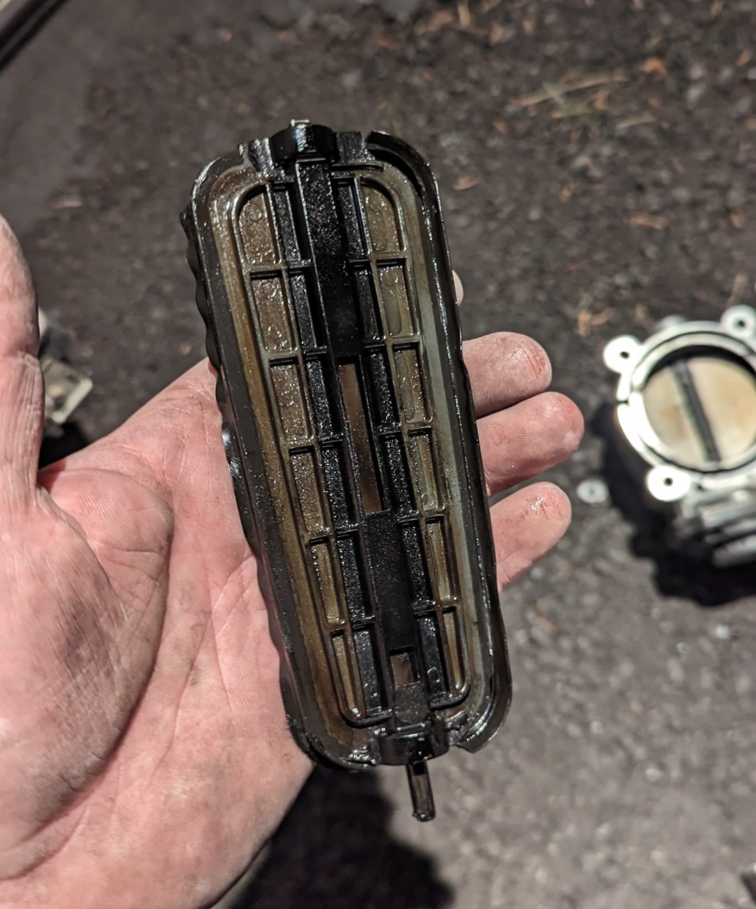

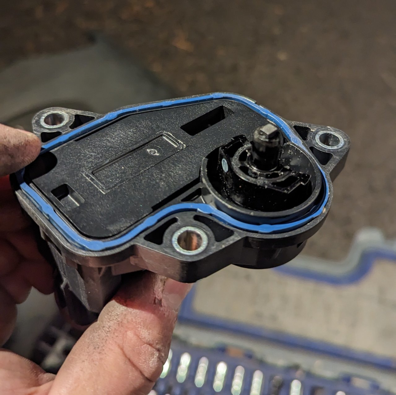

    Yesterday I had this ACIS (Acoustic Control Induction System) failure occur on my truck, and fortunately, I was able to find some info about this happening because a friend had actually had it happen to him.
    Im curious to see how common this is going to be, as I saw at least 5 or 6 other people with this exact issue in another thread.
    Basically what happened to me was I was going to merge onto the highway, I stepped on it to get on the highway, and after 4 grand, it started to miss a bit, then instantly went into limp mode. Pulled over, turned it off.
    When I restarted it it was fine....which was odd....it then drove perfectly normal....until I stepped on the gas and it revved up high again
    It started missing and went into limp mode....this time throwing a CEL for PO303, cylinder 3 misfire.
    I swapped #1 and #3 coil packs, and then drove it again.
    After a bit, it did it again, went into limp mode and threw a PO303 cylinder 3 misfire.
    Obviously that eliminated the possibility it was the coil. I remembered a friend of mine had a very similar issue with his Tacoma. His did what mine is did,ran fine at lower rpms, and broke up above 4k..went into limp mode.
    He told me to pulled the intake....and lo & behold....the same problem he had. The ACIS intake flap snapped off and was bouncing around the intake manifold, most likely plugging #3 intake runner under full throttle, causing the misfire.
    After some digging around on here, I found this thread and that this is becoming a more common issue, with everyone here all having the same broken ACIS plenum flap....and the only fix is to replace the entire upper manifold/plenum.
    The intake manifold part number is 17190-0P101 and I got mine through McGeorge Toyota for around $600 shipped.

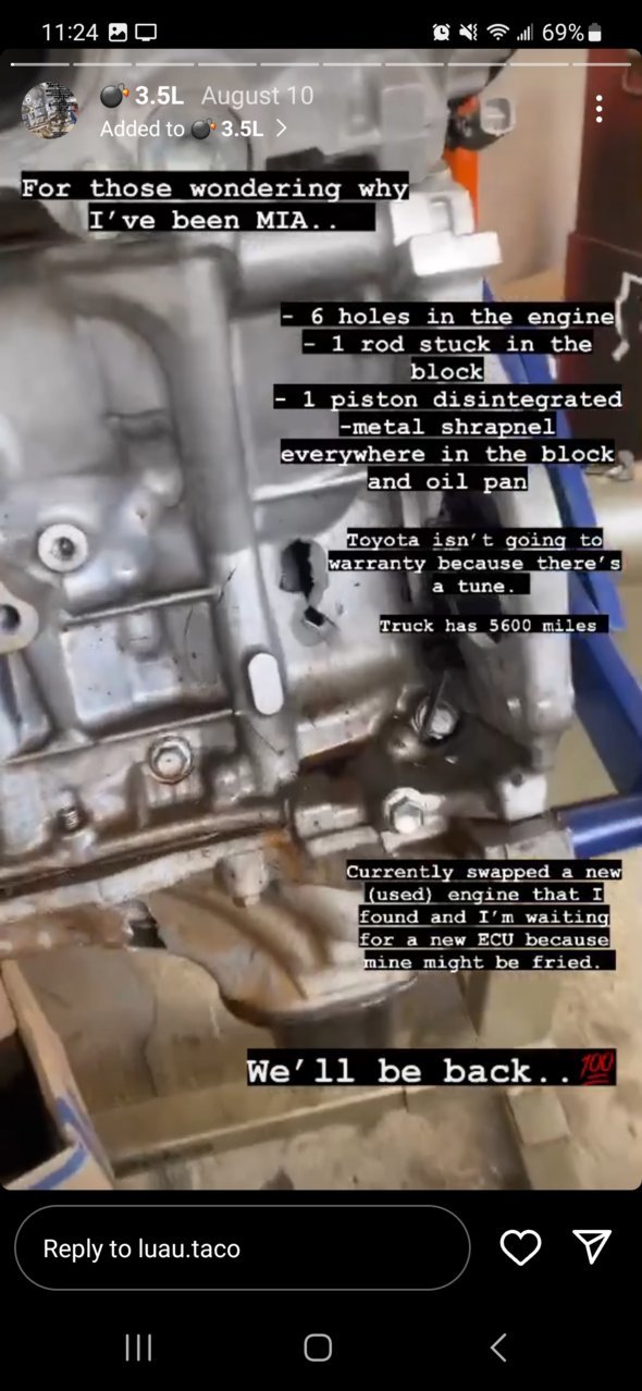

    Allpro Offroad blew up their Tacoma today with 8k miles on it. Unsure why yet, but I'm sure they will post what happened. Screenshot from instagram.
    Luau.taco on Instagram, also blew his up with 5,600 miles on it. He hasnt stated how, but Im guessing he oil hydrolocked it like I did based on that he wheels it.
