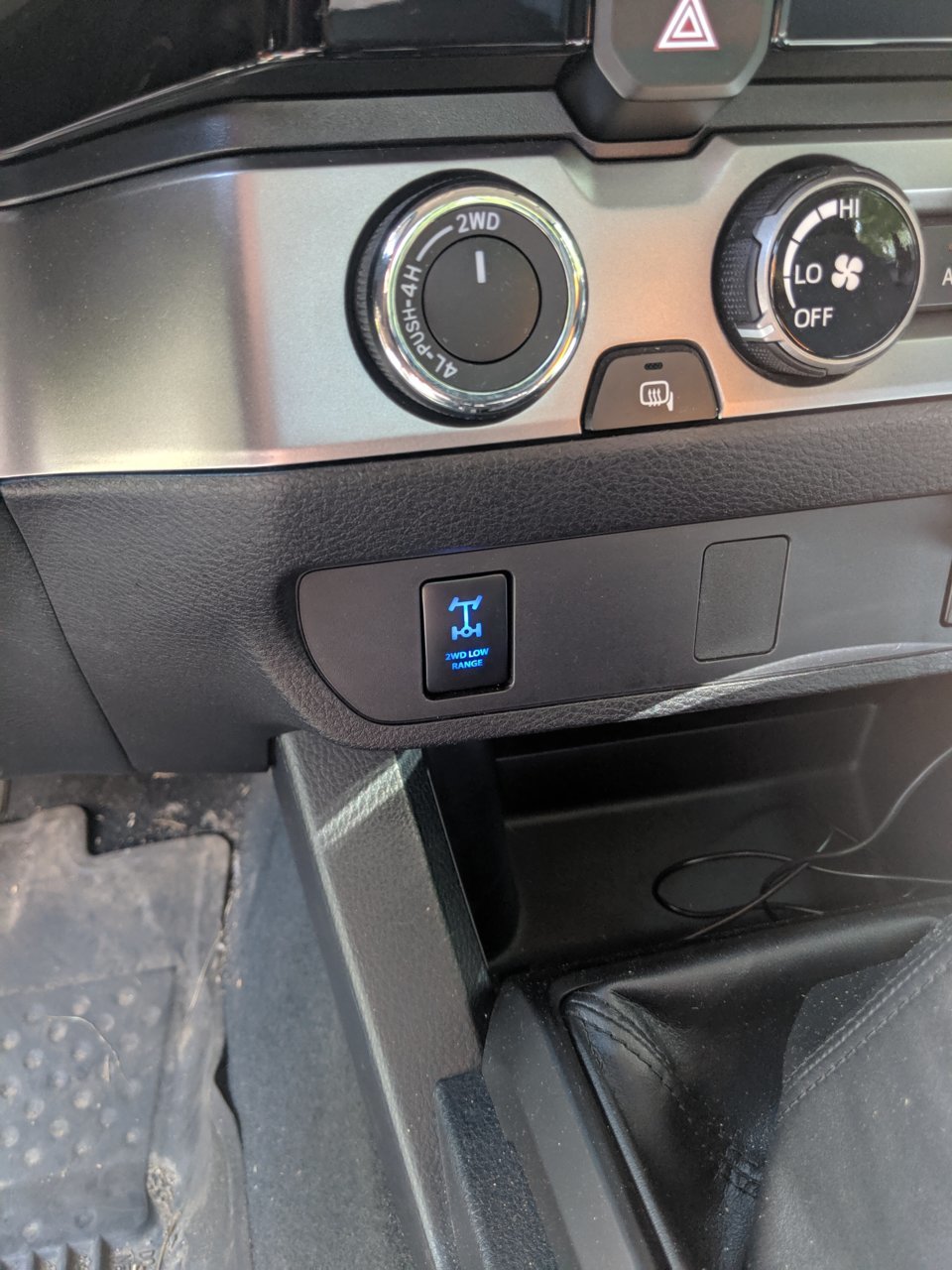

    Finally got around to installing this. Works great! I did the additional steps of wiring the text to come on with the lights. Used an add a fuse on the tail fuse if your looking to do that. Now it's time for a beer.:cheers:

    That's pretty slick to just take the radio out to get to the switches. Always heard they are a pain to get to. Though to route the rest of the wires for the 2Lo switch you didn't have to pull that out anyway?
    Also saw in that post that the factory switches and slots are keyed? Hadn't heard that before, so my plan of moving the BSM over a slot to the right to where the ECT would normally go (I have an MT so that is blank for me), so that I can put the 2Lo switch directly below the 4WD dial, might not work without trimming.
    I assume the aftermarket switches are made generically so they can go in any slot?

    Yeah the aftermarket switch just popped right in, mines a base model so I didn't have to move anything.
    All the other stuff for the harness is behind the glove box, when all that's out and the radio too there's tons of room to get the switch wire over where you need it.

    Even easier is to pop off the HVAC panel once you have the radio trim off. You can get it off without taking out the radio and it requires zero tools. It also gives you better access.

    I had that same plan. But the OE switches are keyed. So I ended up putting the 2LO switch in between the BSM and Parking Assist switches.

    Also, you don't need to pull the radio to put in the switches. When the glove box is off, you can just reach in from the side.
