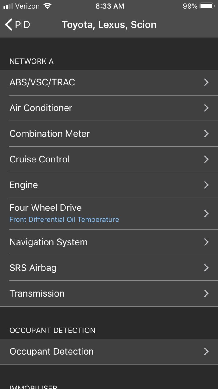

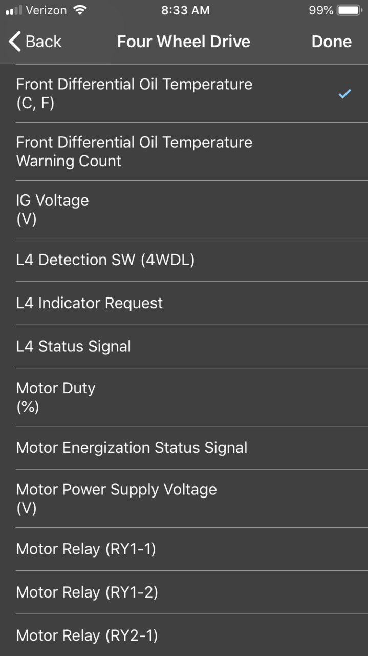

    I went to Pismo beach for a day trip today.
    I ran about 8 miles through the dunes in 2 Low with no problems. 265/75/16 bfg’s a/t e rated tires 16psi front 14rear, stock 3.91 gears, rear arb locked.
    3rd gear 2low was great. Lots of power and I was able to roll into it on the smaller hills and cruise to the top no problem. The front diff ran a little hotter in 2low vs 4low, around 145 degrees vs 4low 130 degrees, but nothing to worry about. Fun times.

    Front diff temp? Is that in the Torque or OBD Fusion apps?

    Interesting.
    I would expect slightly higher front diff temp in 2lo compared to 2hi...
    But would not have expected higher in 2lo than 4lo.
    I guess even though there is essentially zero torque on that axle in 2lo, it is spinning the spiders a lot more in 2lo than it would in 2hi or 4lo. Must be the extra work on the oil causing more heat.
    That said, those temps sound quite low to me. Was it blazing hot outside. Will try to check the manual for the front diff temp before it throws a code, just for reference... (waiting on hurricanes here... so much for holiday)

    OBD fuision, 70 degrees outside, stay safe with that monster right off the east coast.

    Thanks! I have a look for that.

    Can't find maximum before warning in the repair manual.
    So can expect much hotter than that when it is 100F outside. Any extended 2Lo usage, probably recommend watching that
