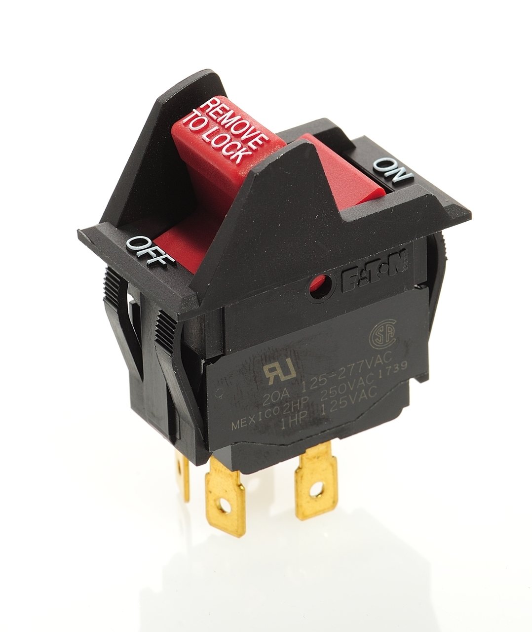

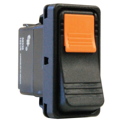

    Is there a different style of switch available that requires an unlock mechanism? I don't want to accidentally tap the 2lo button.

    Pushing the button without changing the 4wd dial won't hurt anything. It's pretty hard to hit these buttons accidentally. I don't know of any OEM style switches that have an interlock. You could always retrofit something like this in a button location if you wanted.

    Like said above, not really necessary for this harness. But they do exist:
